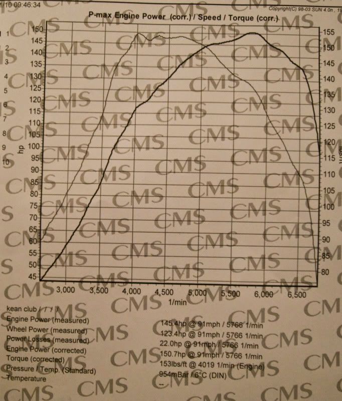

Well my curves are nowhere as smooth as Nicks (oo err missus!) but I finally got the numbers it should have made at the rolling road shoot out last year.
First run on low boost, about 10-12 psi
Second run low then high 20psi, nasty flat spot in the middle.
Not quite the power of Nick, but lots more curly wurlys.
Its coming out for a major overhaul soon, so it was nice to give it a good blast on the current spec.

Both look good, t2clubby have you changed anything since the NM RR day?

Not really, just the way the boost came in on the run, at the shootout they tried 20psi from very low down and it surged its ass off. This time I started on low and switched it manually, I used to let the ecu do the same.

these want correcting to 1001 mb(pressure at rr on sat morning ) to compare with other DIN spec graphs i think ?
oh and the rr shoot out ones are(i think) corrected to superflows STP spec ,just to confuse things even more !!lol
