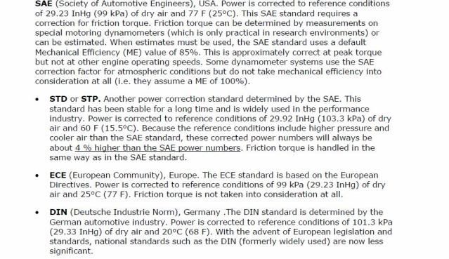

for those of you interested in comparing different dyno correction factors , heres a good bit of info i found ..
hope its legible .. i just need to get the formula from somewhere and i can apply this to dyno's that use the DIN method ,eg sun dyno's ,or the STP method eg superflow as used on the rr shootout .
