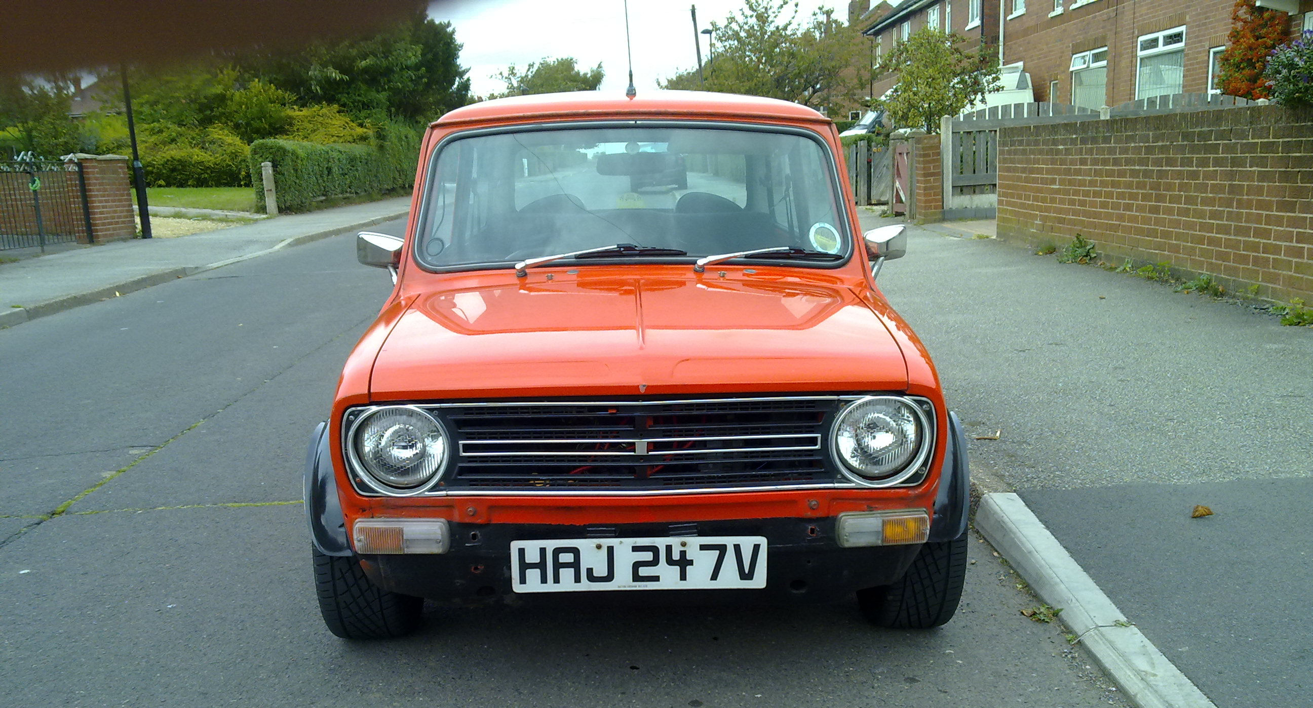

well first of all i thought id start a new thread about my clubman, i bought as a commuter car in a condition where it needed work the first month of owning it i fitted group 6 arches, welded up 2 repair patches at the back end of the sills for the subframe mounts and welded up the front wings where they was incorrectly fitted by the previous owner,
its had 2 repair pannels welded into the rear quarters too
its had all new boots, balljoints, cv, disks, pads, shoes, drums, headgasket, water pump, radiator
its spent the last 6 months 3 different colours
on the to do list (so far)
*new vented sills
*new pass floor pan
*new doorsteps
*replace that fooking tape player!!!
*custom dash
*tidy up boot
*new dash
*new bucket seat
*engine refresh
*spray
*regap the doors
*general de rust and rust proof the underside
* debumper the rear ( sorry john :))+ new valance (as the current one looks like its been welded on with a hammer...)
my budget is zero... i want to spend as little as possible its got to remain the daily although i bike to work in the summer time scale is ongoing the outcome.... well we will see *happy*
in 3 weeks time im off so the main welding will start then i have some pictures to up load when i find them
i have done over 10'000 miles in it already which is good going considering the noise the gearbox used to make its 100 miles off going round the clock*tongue*

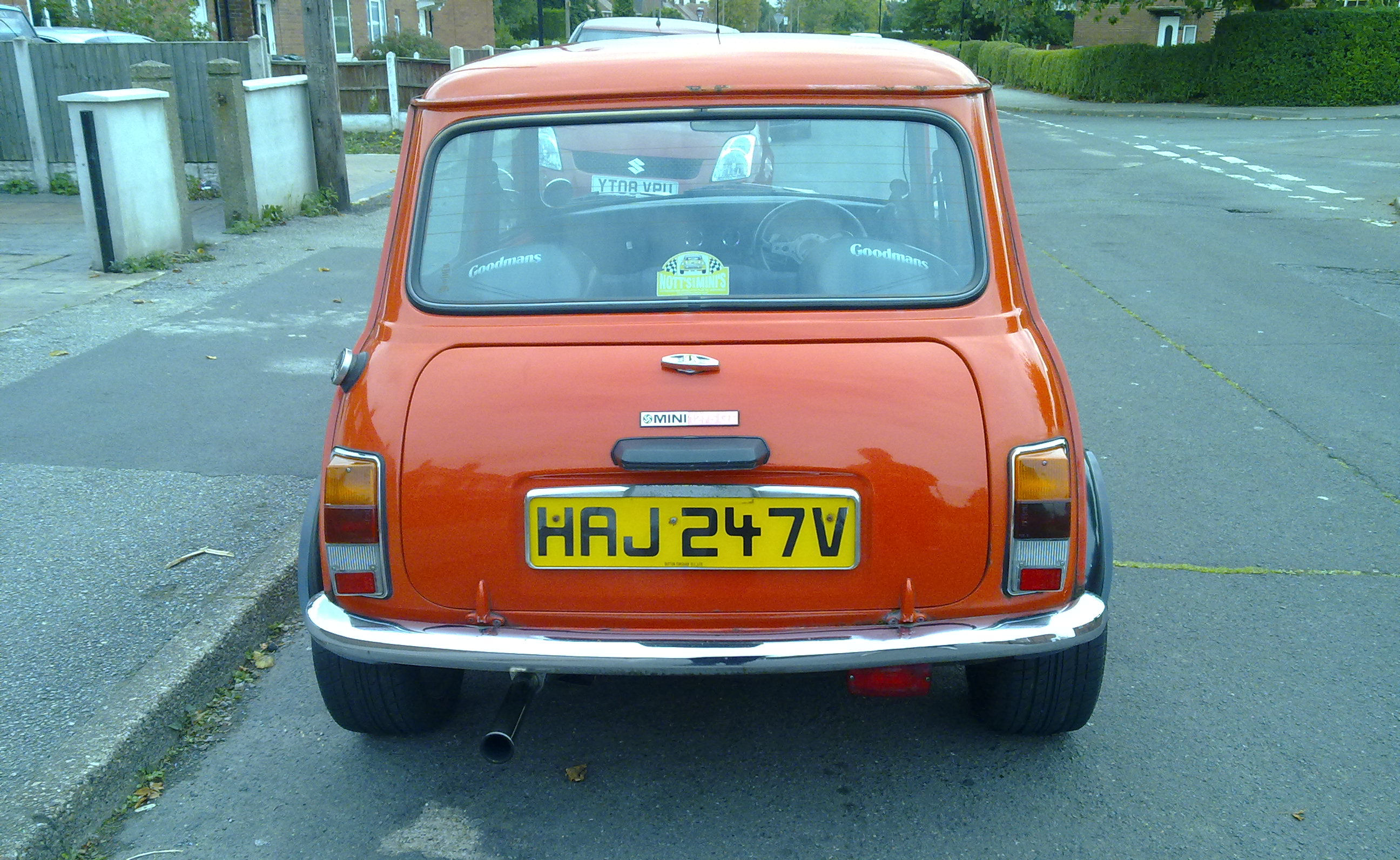

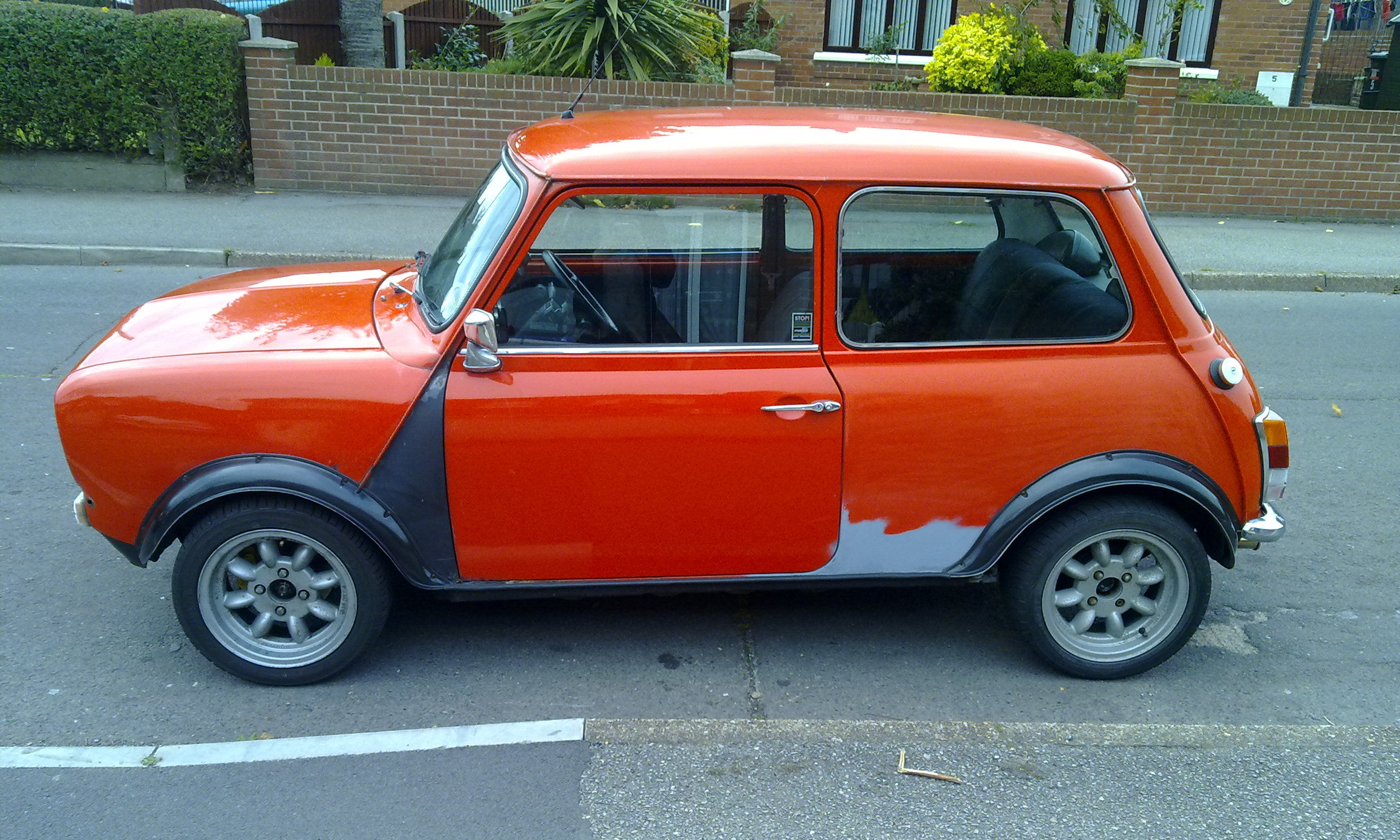

Best IMO (front is already bumperless from the piccies anyway), it's somehow just cleaner lines.
Engine intentions ???
Bleargh @ de-bumpered! lol
You better put a big engine in it to make up for this!
i love a bumperless rear on a modified mini

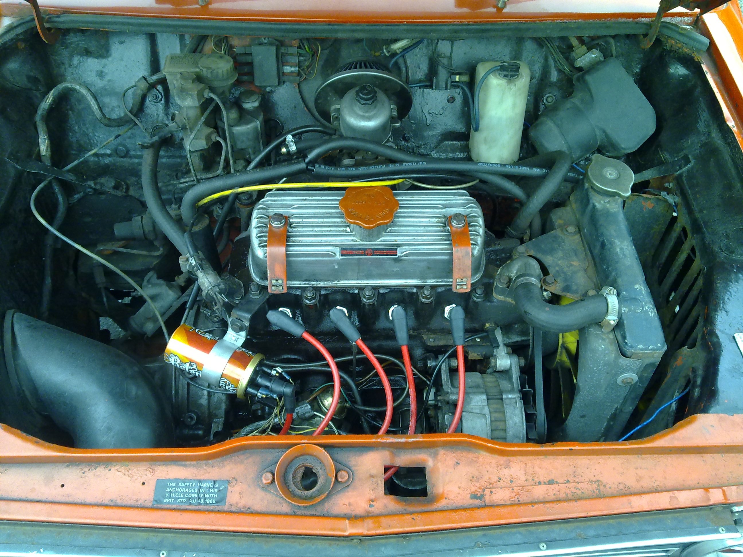

for the engine IF it needs a rebore it will be 1360, tbh ive had the head off twice and the bores looked best ive seen with a decent head id like to play with efi on this one so not be too exotic ,
i am temped to fit my turbo lump in na form to this for running in and to give me time to build this minis engine
my other mini was de bumpered it does clean up the lines and the front bumper was removed when i put the arches on, it just didnt look right

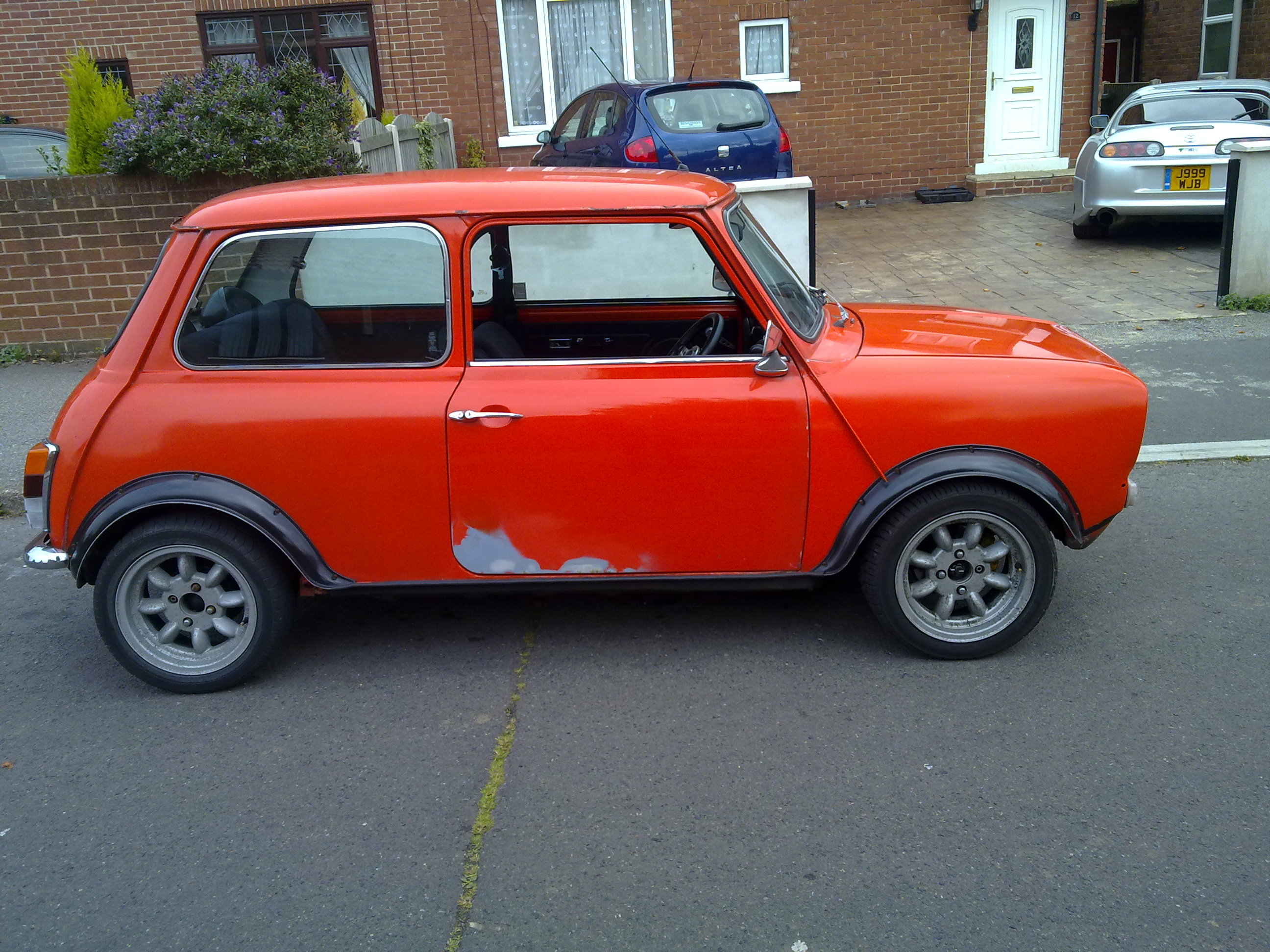

Good work on the car above. however the standard mini lights now look out of place. Maybe some mk1 lights would fit in better.
Yes. go and redo all your hardwork on the shell. lol

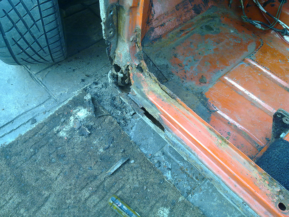

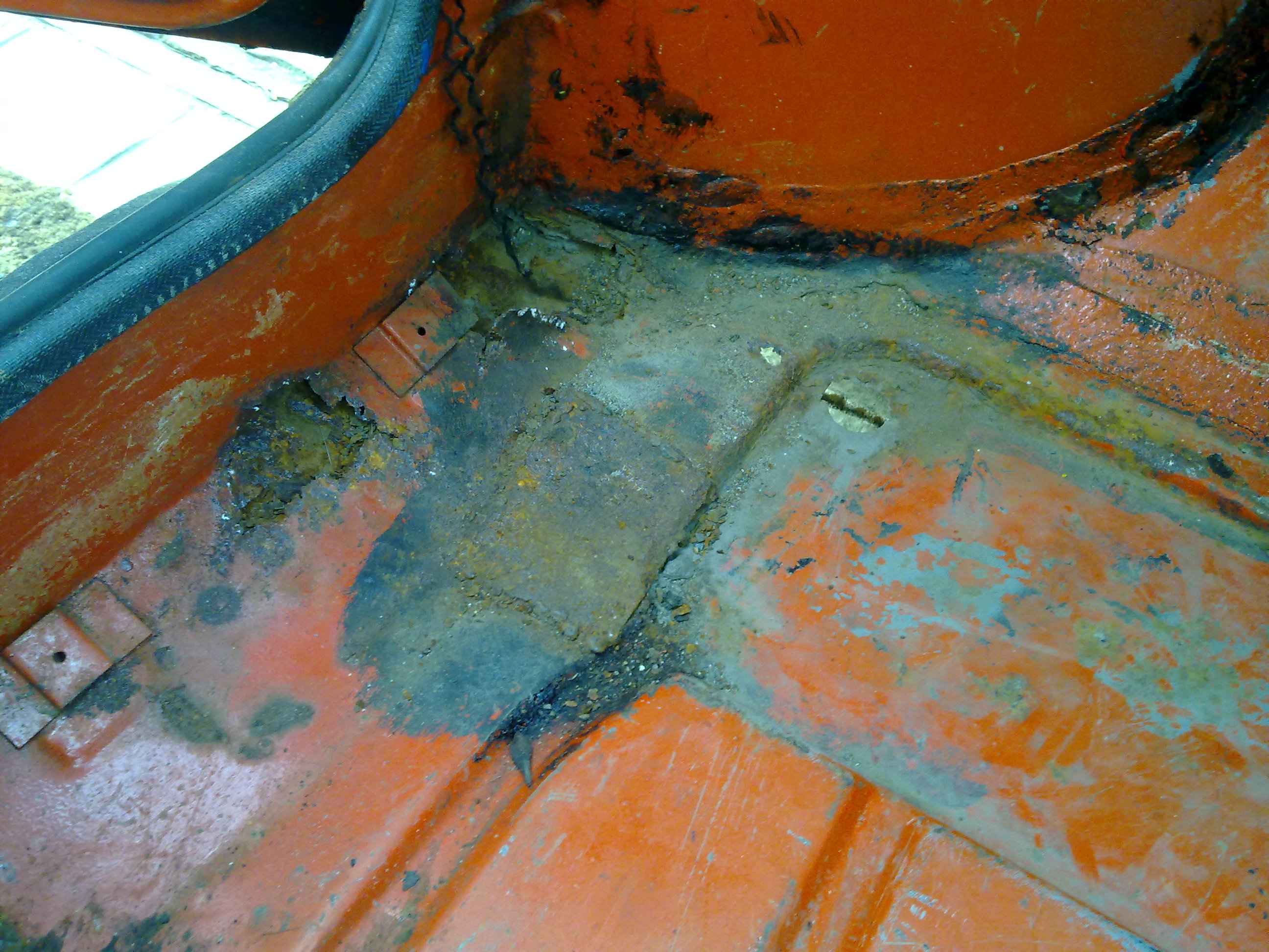

still no progress but just pulled all my photos of my phone to find these

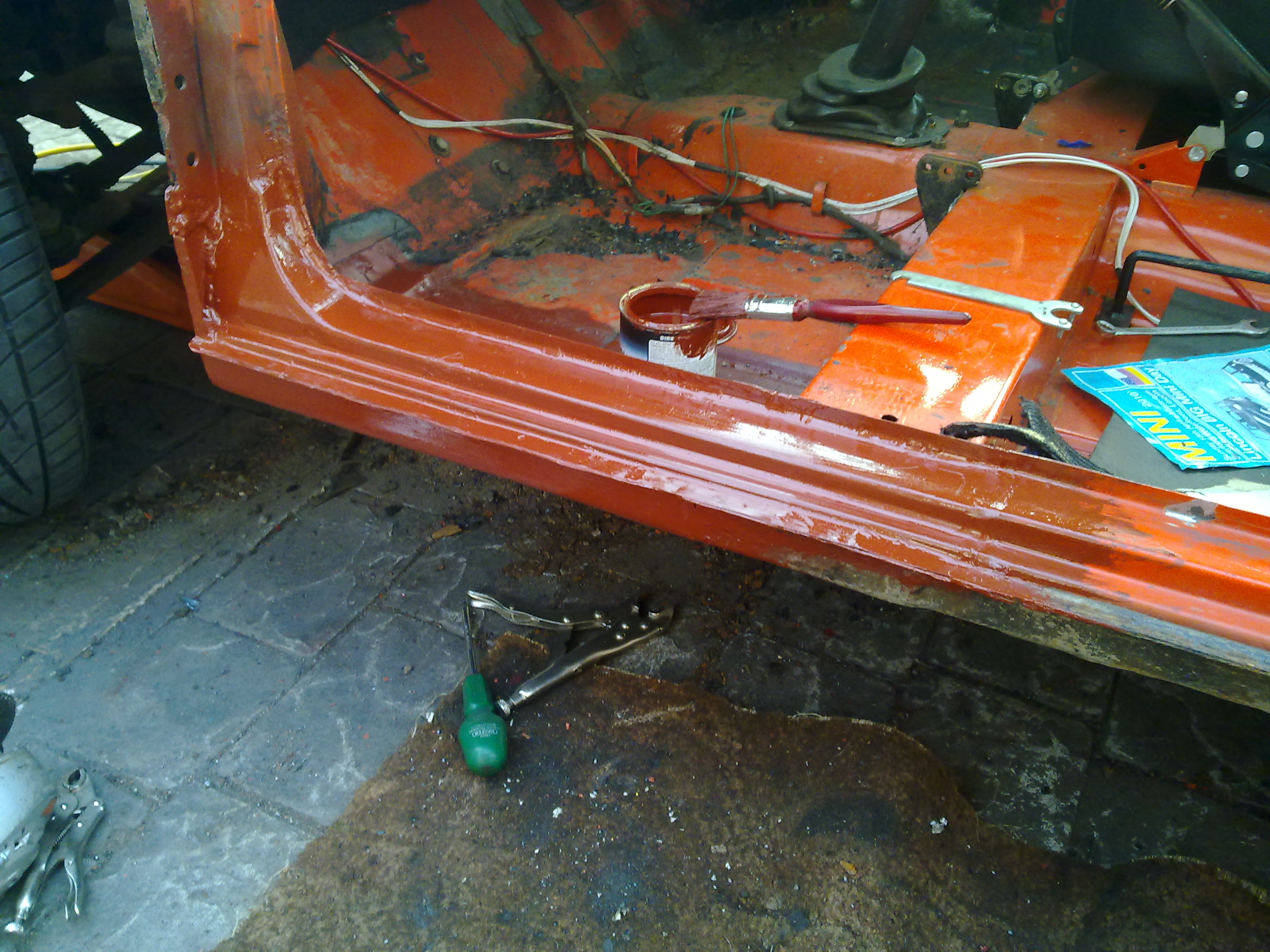

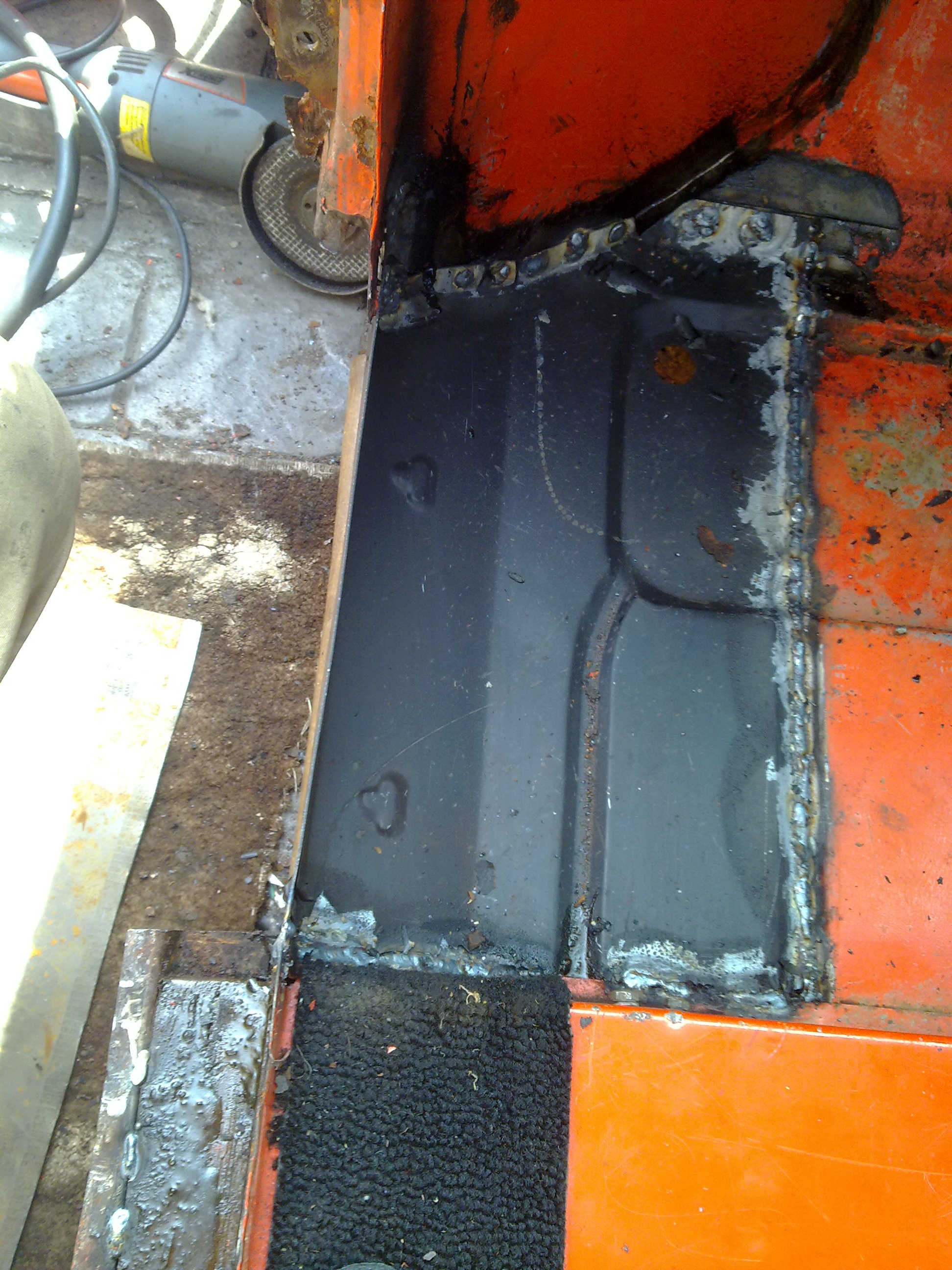

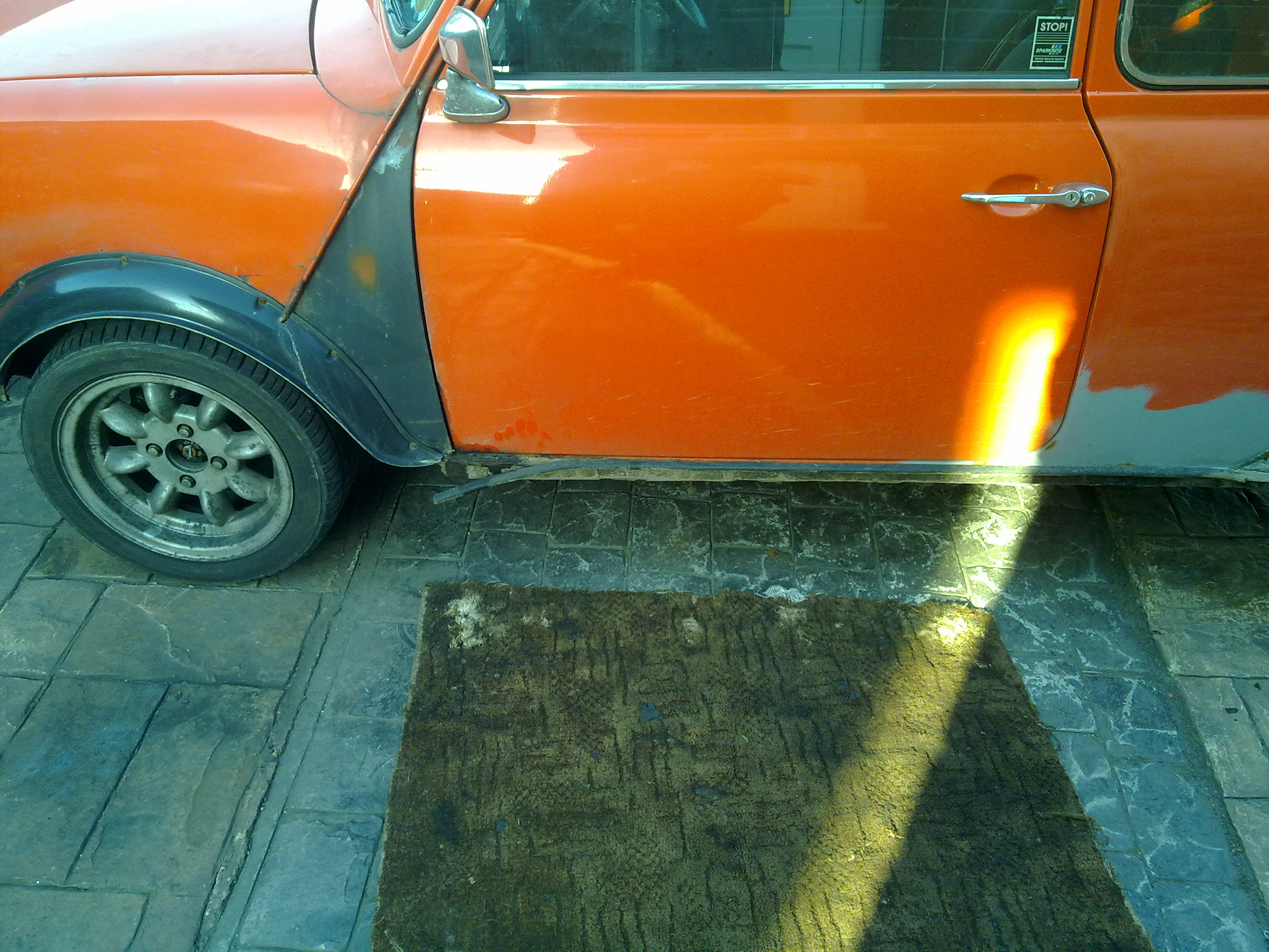

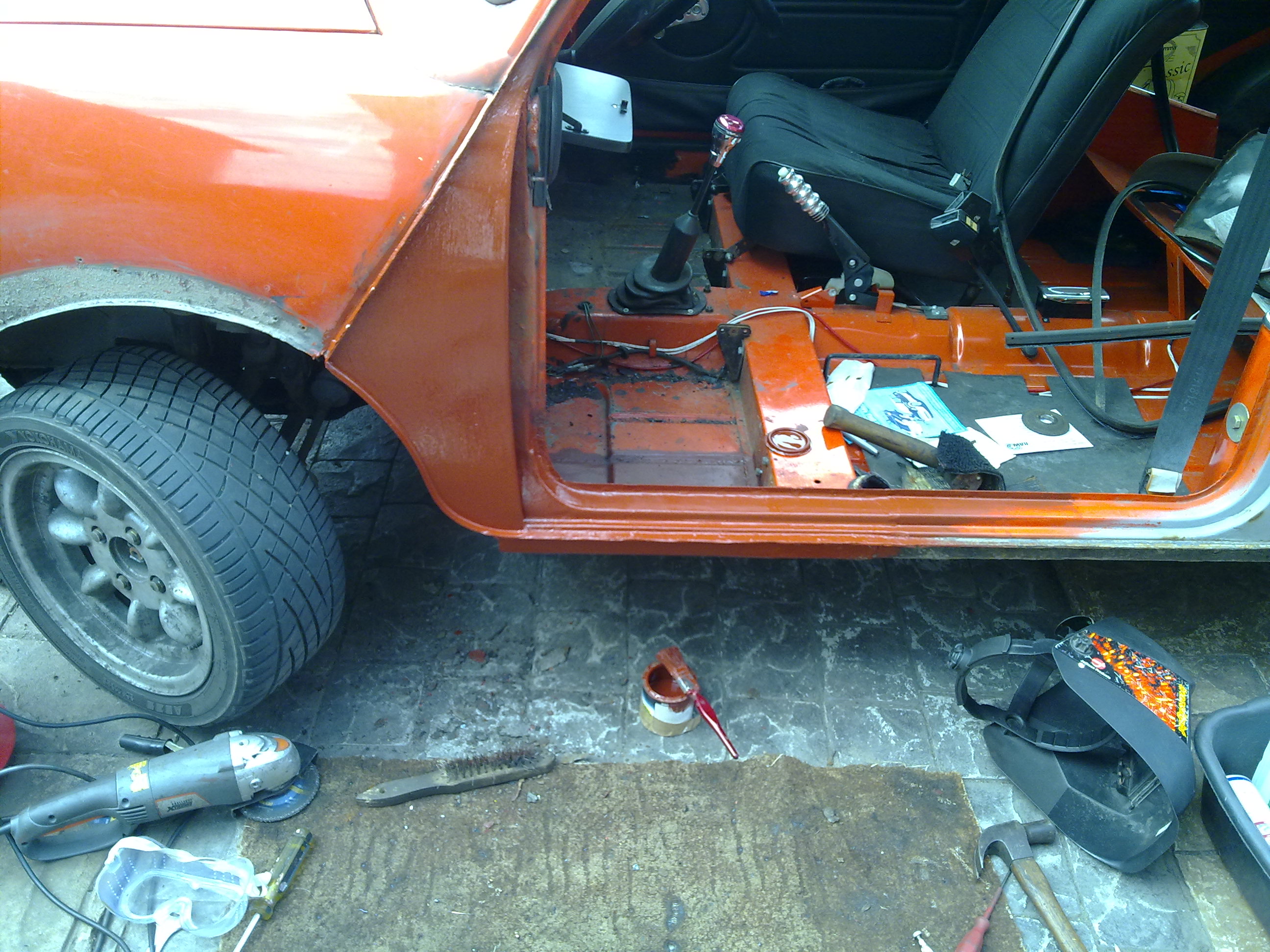

well first mile stone :) 11 n half hours worth

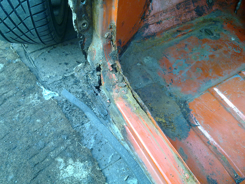

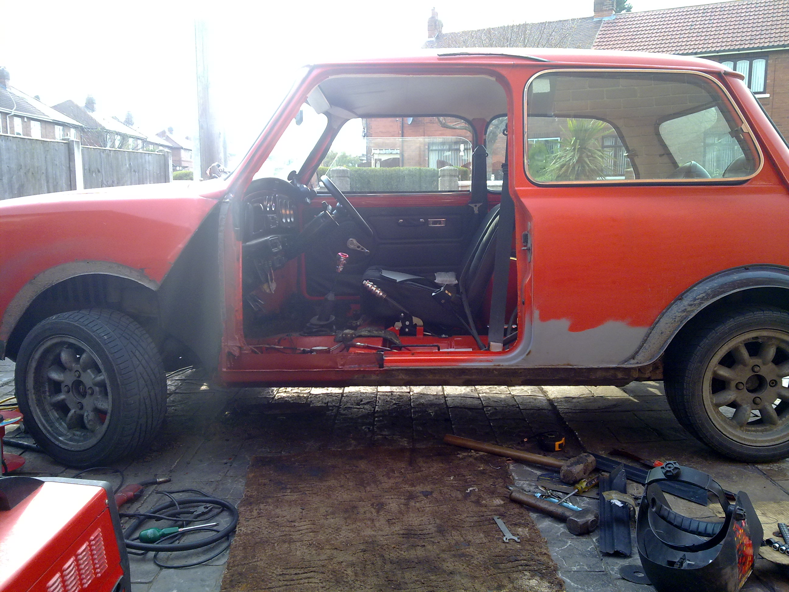

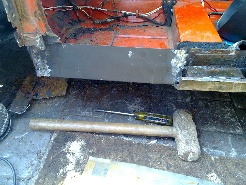

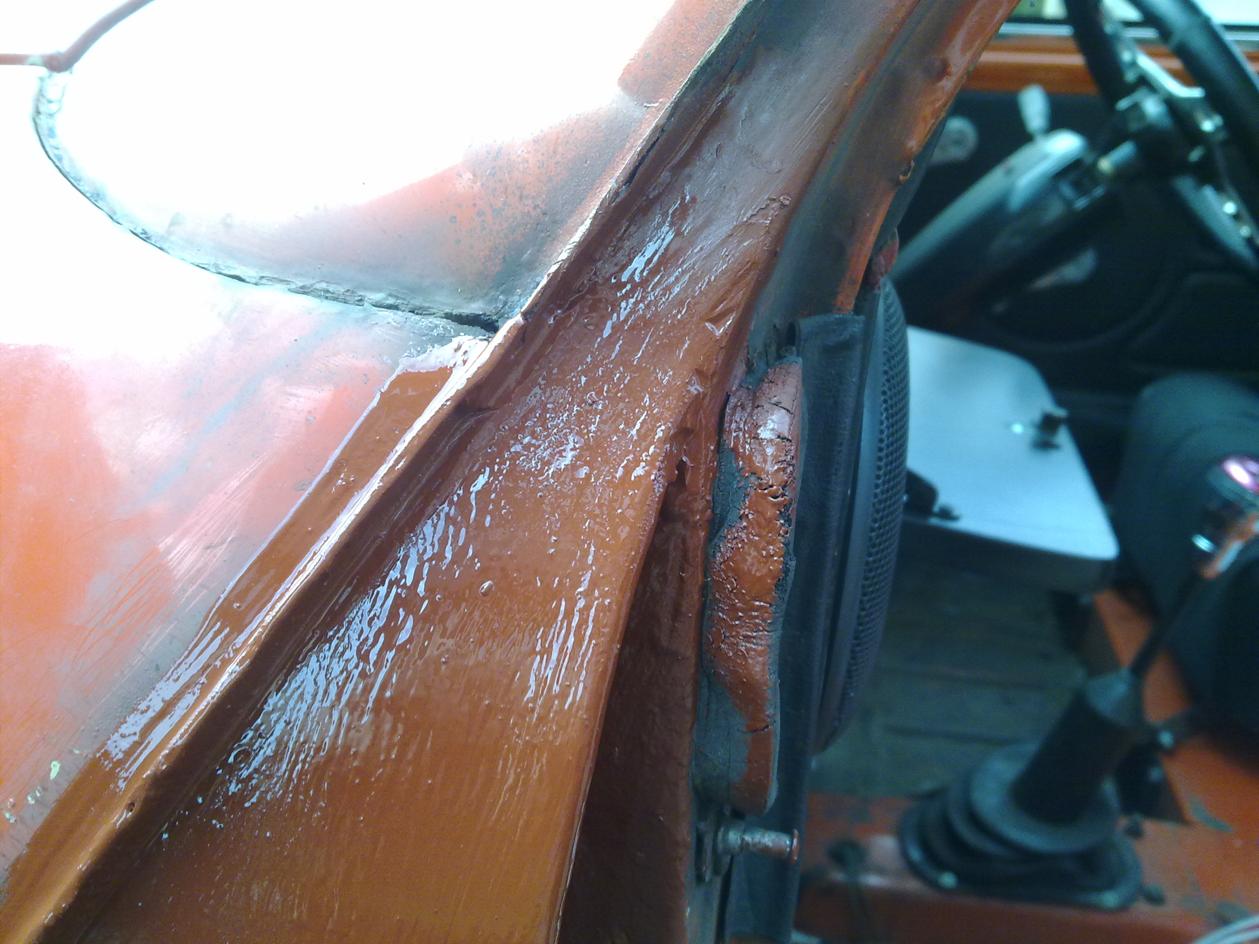

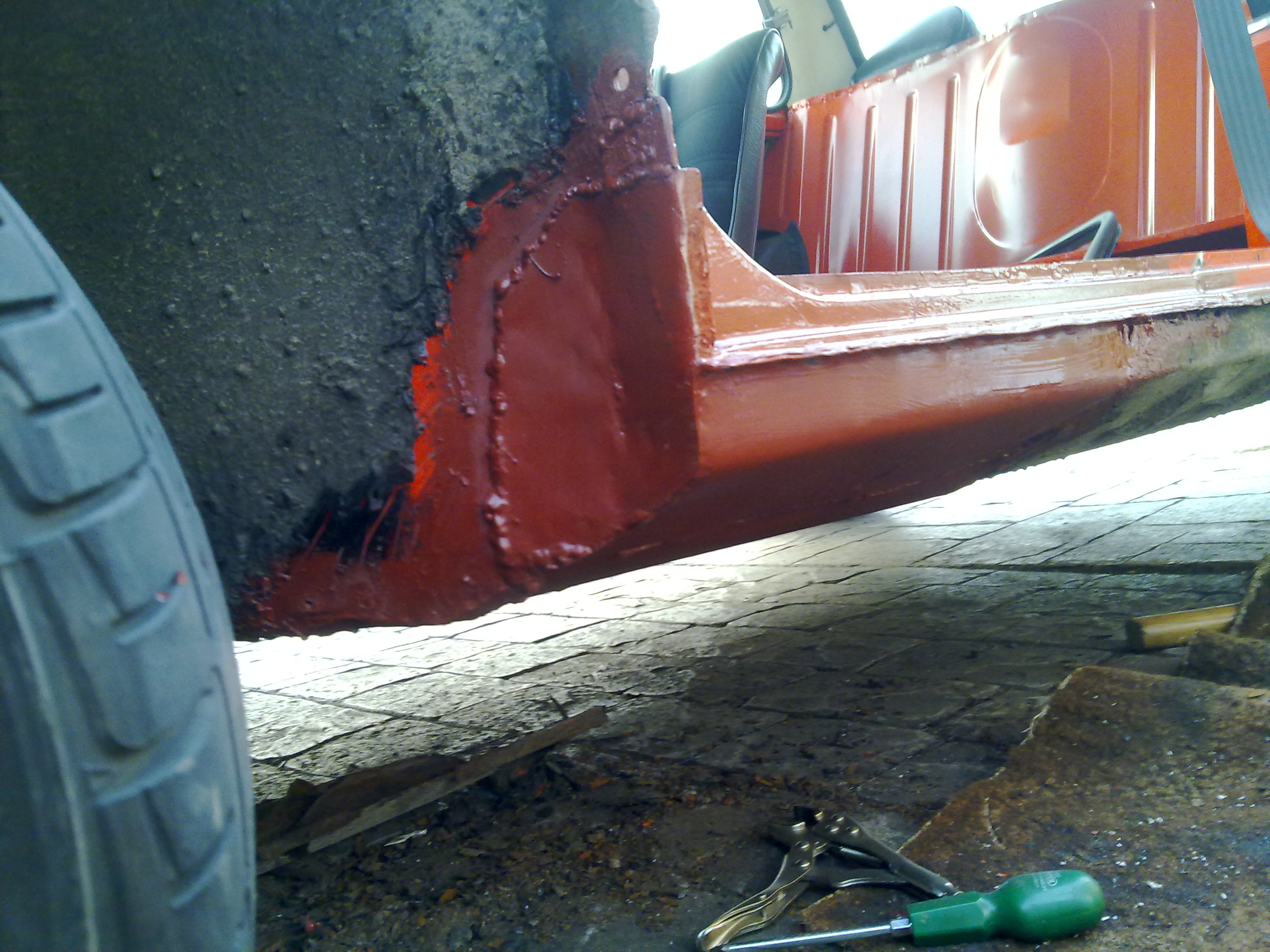

new a panel, repaired door step and half floor, rebuilt outer sill, i have an original style (repro) sill for both sides but after inspection the current sills (original) are still solid minus the rear subframe mounts i did last year, during the removal of the door i found the reason it was abit stiff*happy* the hinge is solid (absolutely) and the frame under the a panel was bending*surprised* good job i dont regularly carry passengers
Edited by Brett on 10th Apr, 2010.
got an apanel to fit a bit of fettling and the painting properly
im going to slap a nice big drain hole in the sill and then waxoil both the sills providing the drivers doorstep panel
so far

thats a big hammer for repairing an inner sill *surprised*
*happy* no replacement for a BFH!! i use it as a weight to hammer against, gets the panels nice and flat :) there is 6 or 7 photos missing, my phone doesn't always save them correctly

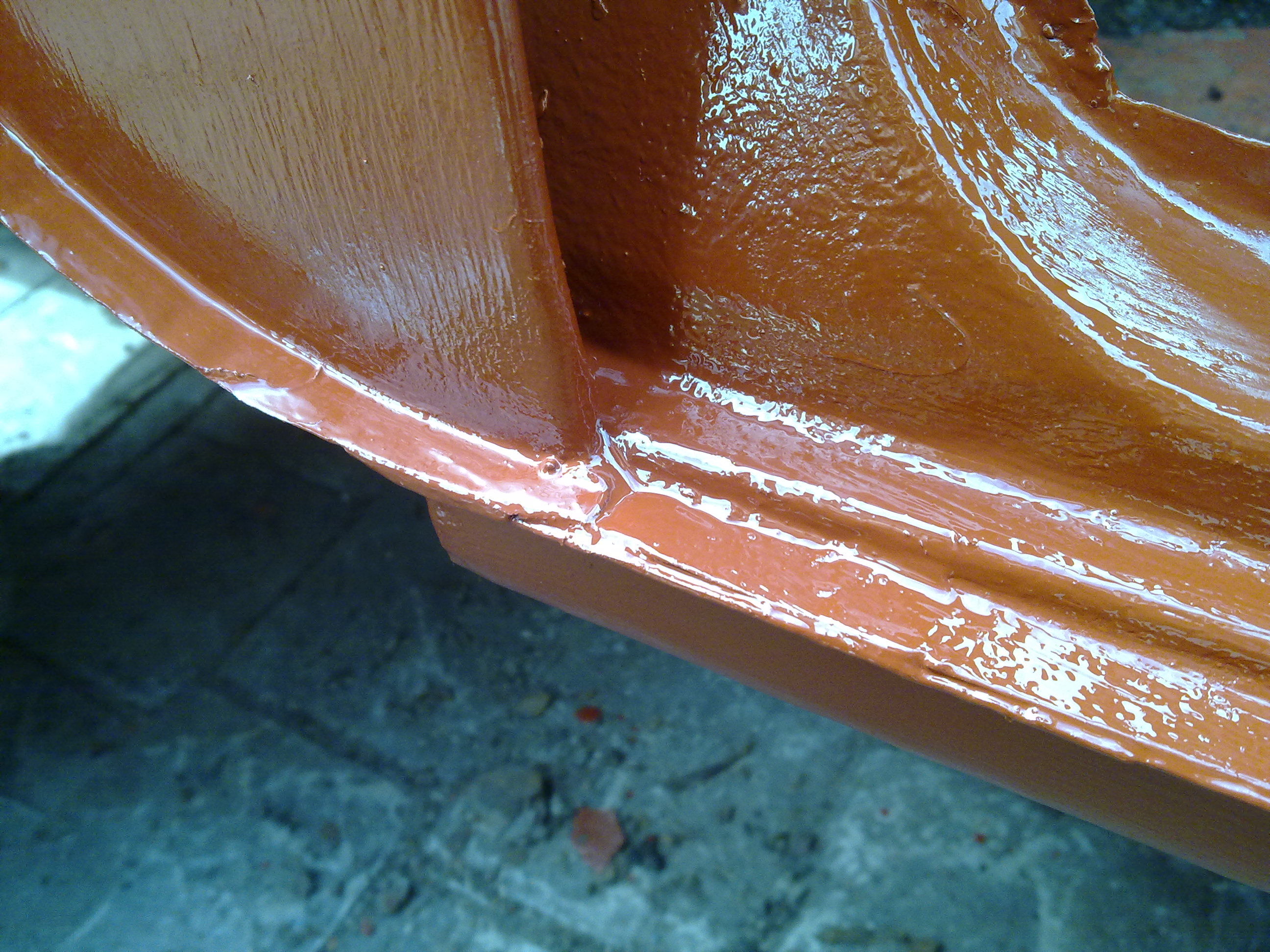

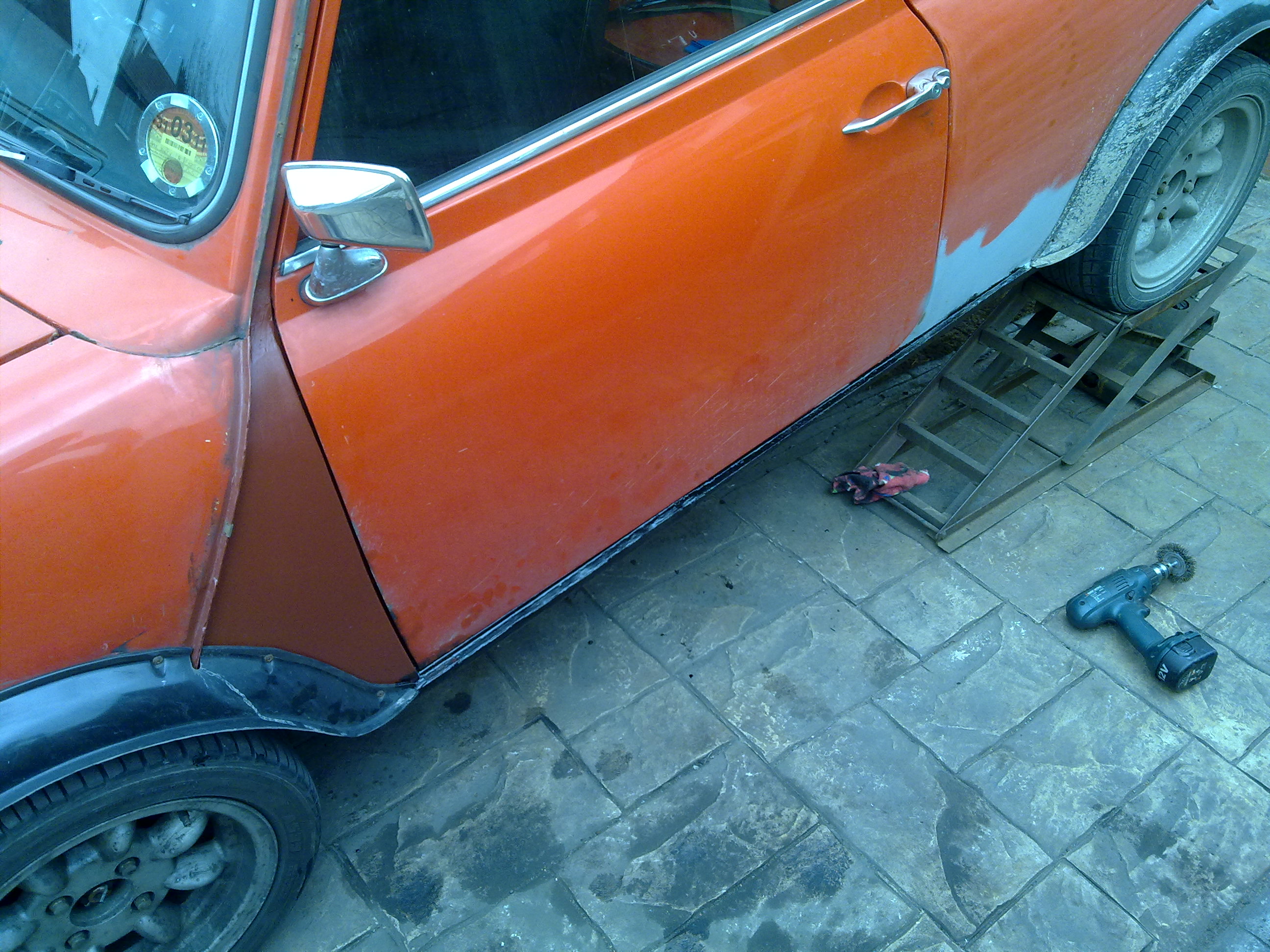

a panel on and all red oxided, door refitted, and panel gaps spot on, cracking job if i do say so my self*happy*
bit more painting in the morning, i solved the constant leaking out the radiator over flow tube aswell the cap was bent and not clamping full force*smiley*, well "solved" i bet it will still do it haha *oh well*

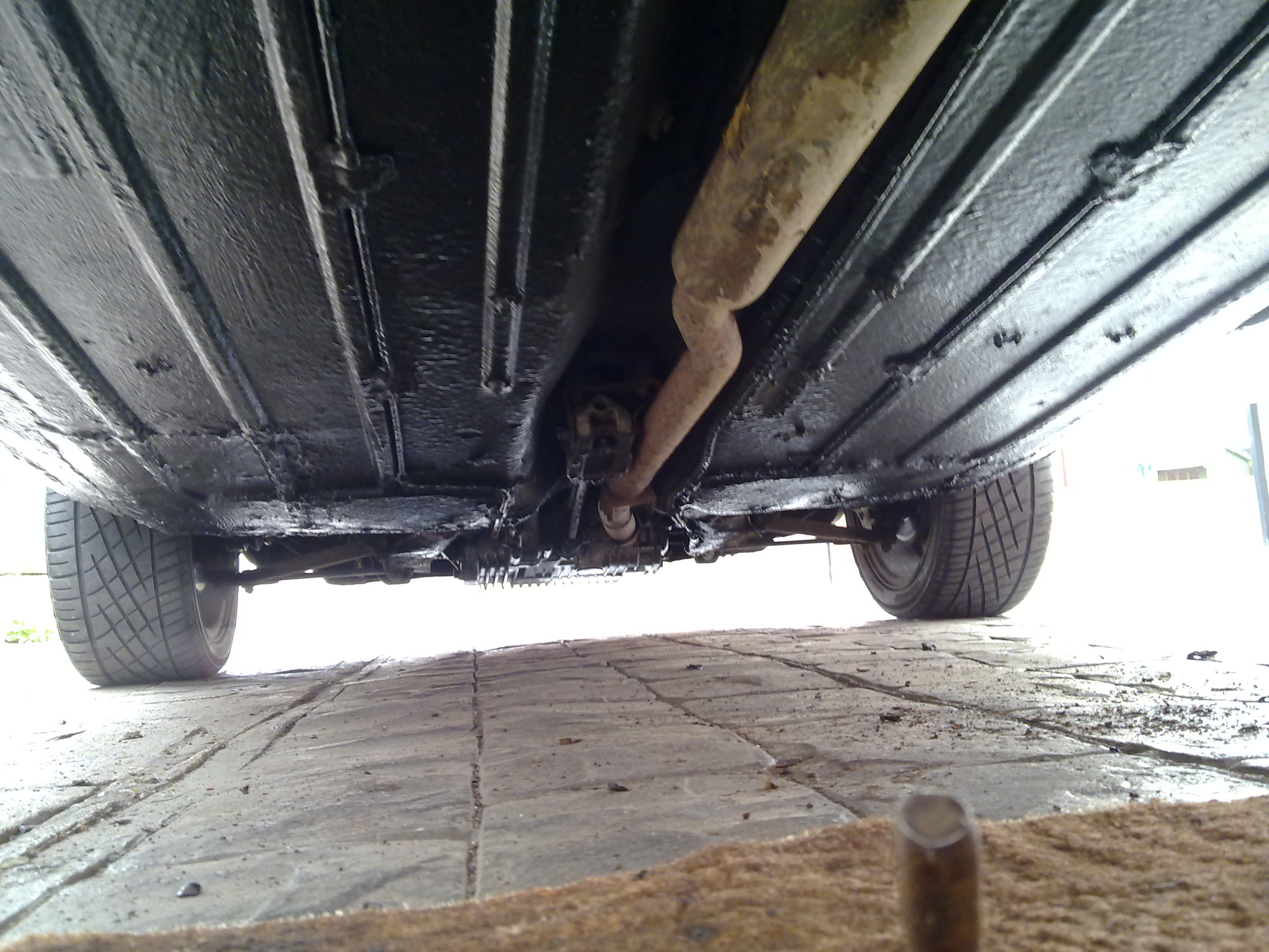

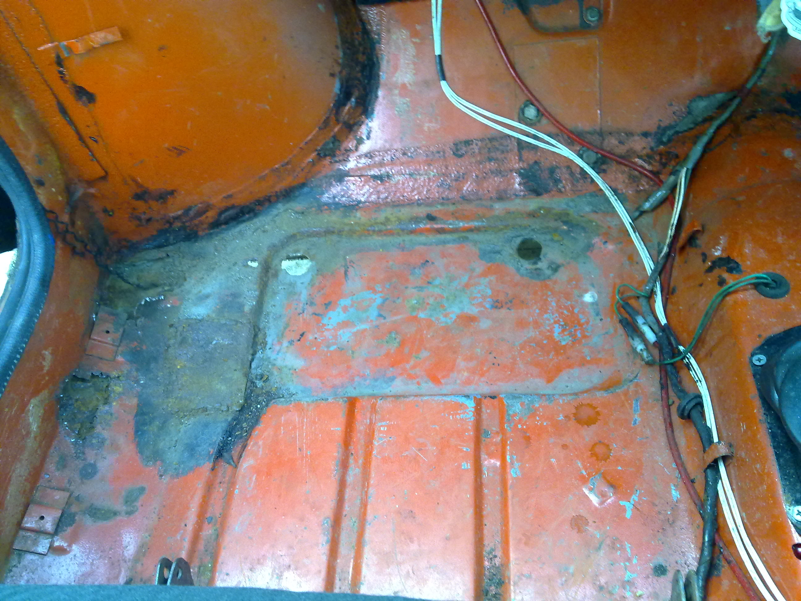

couple more pics, had a good tidy up underneath today, i intend on cutting the red oxide primer back and spraying it vermilion at some point mot first though
