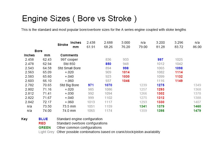

Could anyone tell me what std 1275 pistons are in mm across the top is it 69mm?.
cheers
70,61mm
turbo22
492 Posts
Member #: 3684
wisborough green west sussex
ok great thanks, i have some spare pistons and they mearsure 69mm does this make them 998?
cheers
Edited by Brett on 10th Feb, 2010.
turbo22
492 Posts
Member #: 3684
thanks brett thats great! strange though my pistons are 69mm guess they must just be std 1275 pistons.
are you measuring the top?
if you are it wont be right reading you need to measure the skirt across ( at 90 degrees to) the godien pin ( sp? )
id guess at them being std 1275
turbo22
492 Posts
Member #: 3684
right ill try that now, i was going across the top
turbo22
492 Posts
Member #: 3684
yep 1275, as close to 70.61mm as you can get with a tape.
cheers guys
