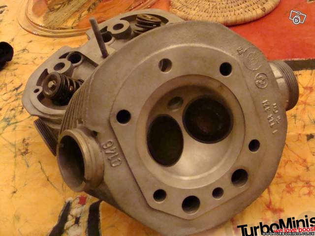

There is no problem with air cooling. Look at Porsche flat6.
Short stroke is the best for the power at high revs. The air speed depends on the volume flowing through the valve, not the speed of the piston. Take a 1m piston and a 1mm valve and you'll get any air speed you want.
Alfa engines have similar heads, yes. Like many many others. But there are lots of details that matter. You can not compare engines on the basis of advertised cam timings and head shapes. BTW 308 cams were quite common on street Alfa engines even in the Injection era. These engines were long stroke. On the picture I'd say you've got 45 degrees between valve stems, which is much better than 60 degrees of the 1300 Alfa. 45 degrees Alfa heads were twin sparked. There is a nice squish surface, there was none on Bialbiero.
I think your main pb is you want power at low RPM on an engine designed for high revs. Start analyzing all the data: bore, conrod R/L, cam lift, true cam profiles (and not advertised and often wrong numbers), all the air restrictions, intake/exhaust manifold design. This should help you understanding the engine.
If you want torque with big valves you need less lift and high turbulence. This is against high revs the engine was built for.
Expect 100hp/L at 7000rpm on race classic Bialbiero (Alfa) engines you are looking at. Long stroke, 60 degrees between stems, single spark plug. I'm sure you can do better on a bike engine, but it will give nothing under 3000 RPM.
