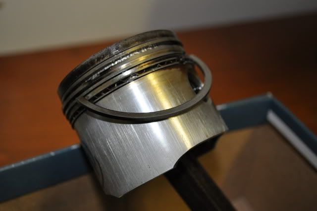

Motor came out last year due to it started blowing smoke and running rough, still made good power but diceded to pull it out to make sure there was no issues , first thought was that maybe a circlip had poped out but it was a different story . only just pulled engine apart this week, and it seems i have broken the ring land on pistons 3 and 4 betweet the top rings.
1152cc turboed mini clubman, most powerful 1.1L a-series?
http://boostmini.justboard.net/
I'm not sure if anyne else uses these pistons forced induction?
What boost/CR/turbo are you using?
I've got these fitted in my 1100T, but I haven't run it yet. How much boost were you running?

boost was 15psi
compression was 8.3:1 ish
turbo is gt2554r
engine was making 165hp and has done around 25,000km without being pulled apart so i think did very well, what would cause that ring land to break?

As far as I am aware, the 1100 Hypatec pistons are standard replacement items with oil drain slots. They are not the high performance items that are available for the 998s with drilled oil drains. Please correct me if I am wrong.
The land has broken above where the slots are cut.
Given that, I think you have done very well to get 25k from an engine capable of 165hp.

yeh thats right , they are very cheap but are not a bad piston and will happy do around 100hp , i was pushing the limits of them:)
at the time of my build the were the easy option for me , the only other avialble piston for me was the swifttune forged omegas but only came in flat top and more than 4x the price so i chose the hypatecs.
Now i will use some russel engineering ones which should be fine for 20psi.
again the hypatec piston has worked great there was another 1100cc mini here in australia making 10hp more than mine with the same pistons but it has much less km/s on it .

looks like det damage...
