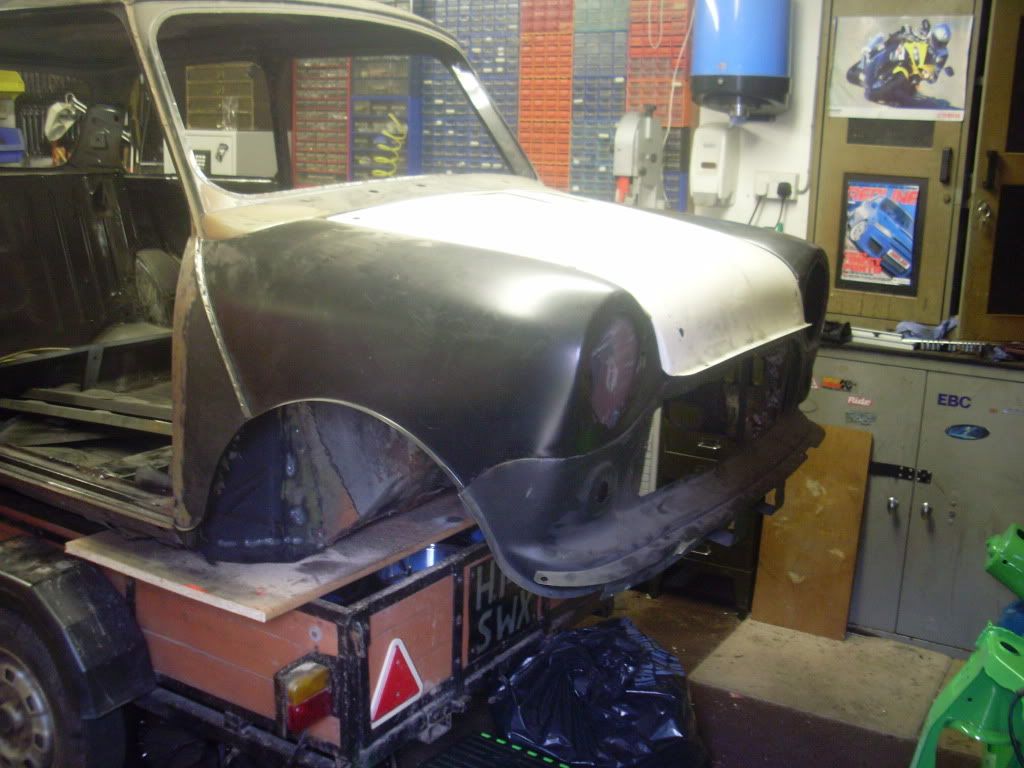

front doesnt look bad in pics, but they were dented were he had hammerd them to get the gap right one he welded them on >_< (twat)

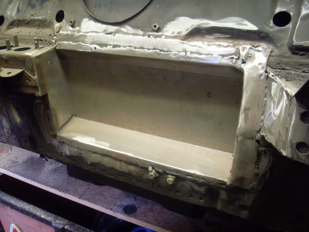

turbo box. . . .had some nice gaps on the insided (the bloke made it, and it was made of like 1mm steel!!)

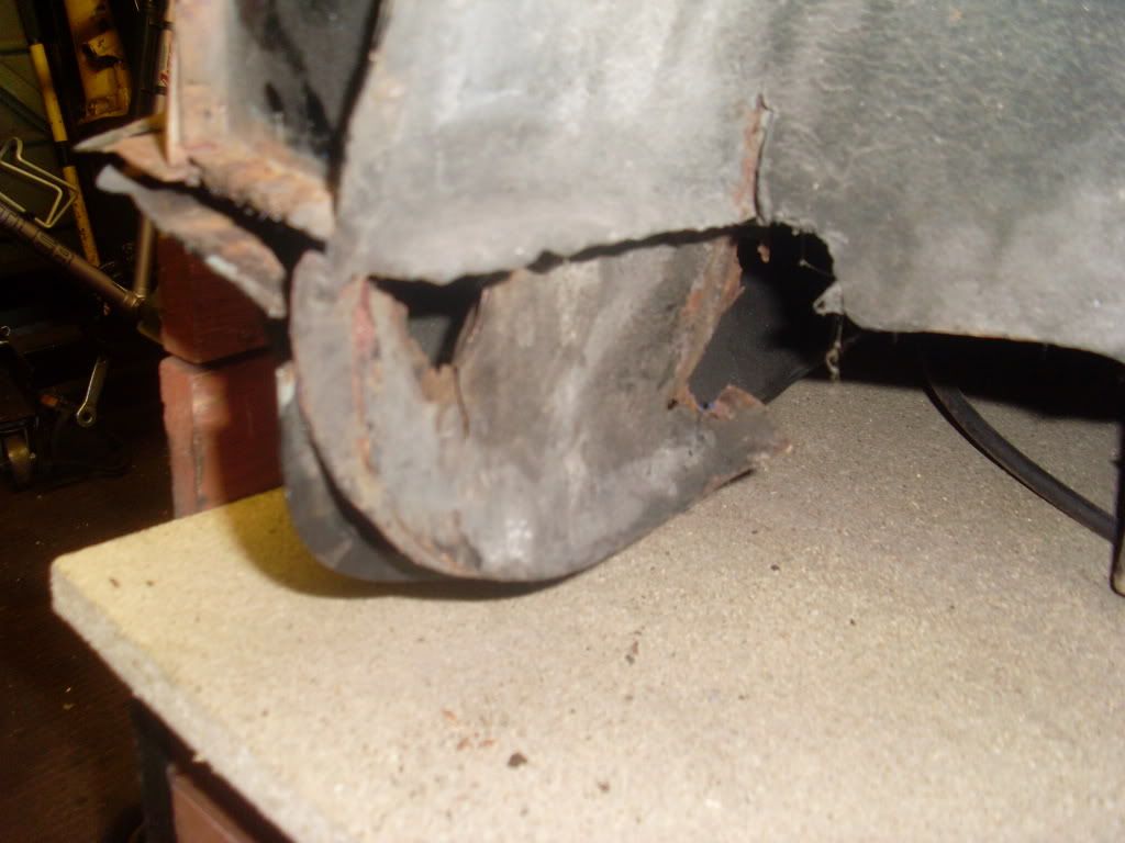

valence. . . hmm suposed to be attached
hinge panel. . . could be used as a postbox i supose?

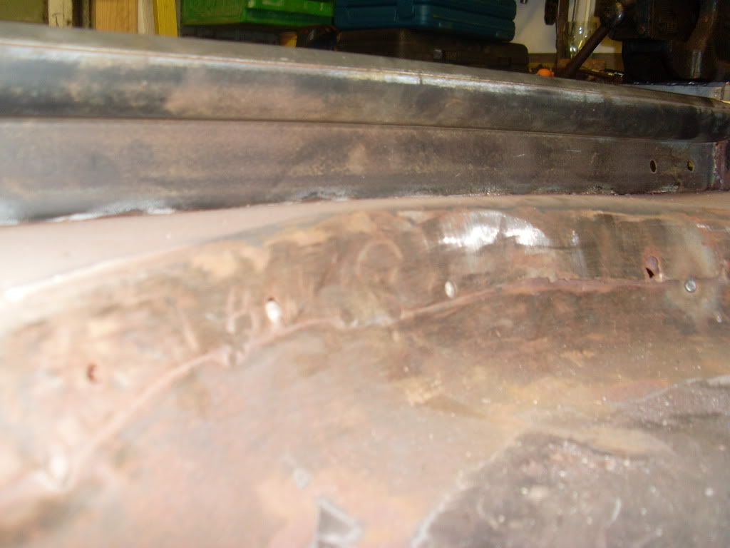

repairs ( gone rusty :L )

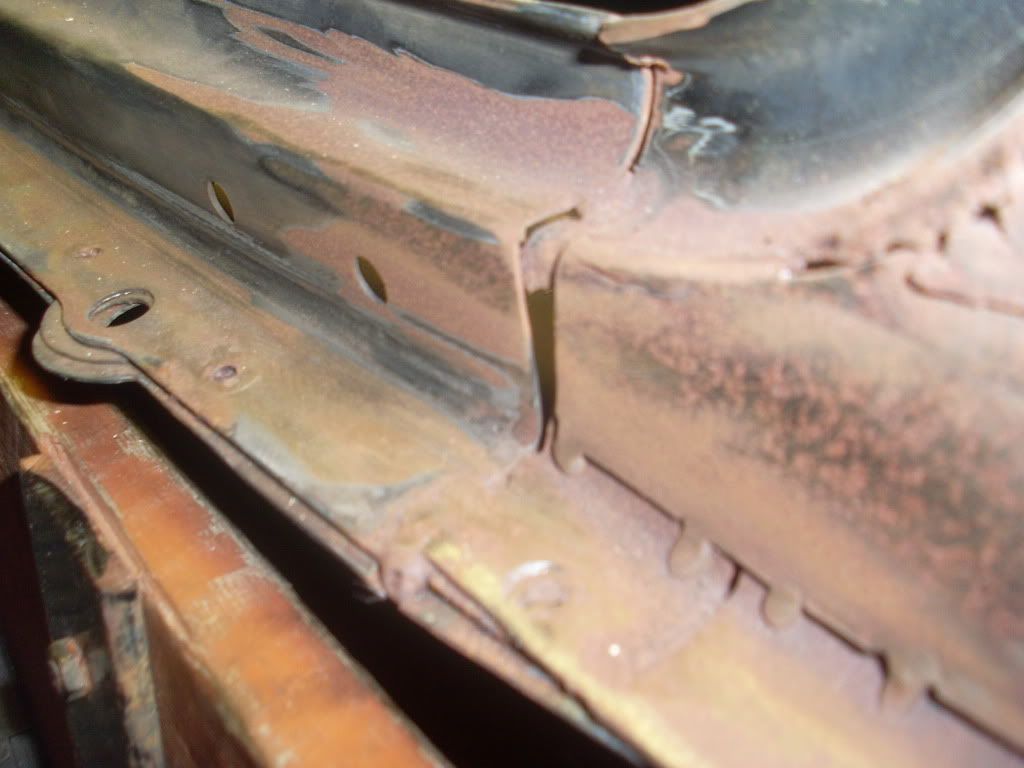

a-panels. . . he cut them down rather than folding them round (cant find pic)

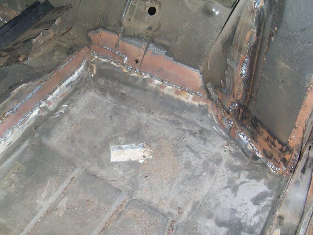

the floors dont look to bad. . . .apart from that fact they were welded over the top of the old ones!!!

That boot hinge panel, is over the original aswell?
gregh55
395 Posts
Member #: 3636
herefordshire
yeah it was, he told us he had worked in a mini only garage aswell!

People who class that sort of work as a repair shouldn't be working on cars.
big_pete
43 Posts
Member #: 8233
that is dreadful workmanship! Basically back to square 1 and start again?
