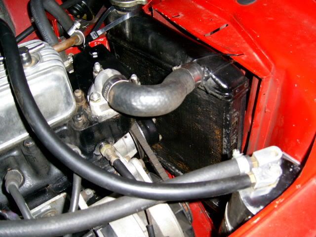

Hi mite, this is how i have done it. With a kenlow fan in the inside of the wing i have cut it out but. It is a lot cooler then befor. It don't come on much.
hope this helps
simon

You can fit a Kenlowe style thermo fan directly to the back of the radiator without trimming any sheet metal.
Although you can't really see it, the fan is fixed to the radiator with the supplied fitting kit. I just unbolted the shroud & mechanical fan - it can all be refitted if I ever want to.

well I couldn't fit it inside the cowling, so I have nicked Keith's / Madmk1's fitting.
Blimy some rust to sort up there...
looks good, have you tried it yet?
let us know how you get on
not yet hopefully at the weekend, just getting some niggles sorted. and I need to get the rad back on. I'm going to try it without a mech fan....
So far so good. I ran the car tonight so not the hottest of days but never got above N without using the heater in the car.
Sorry I dont have a temp i only have the standard gauge. I'm using the fan made by Mr K.Lowe and the thermostat kit that fits between the rad fins.
well as an update it did London to Brighton just fine so Its staying as is.
