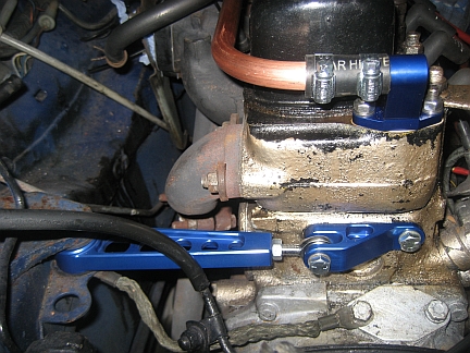

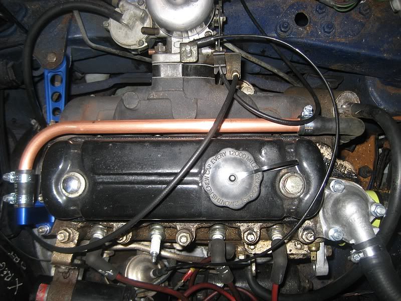

I have used one of the heater off takes from DSN Classics. With a length of copper tube I then route around the back of the rocker cover. The other end of the copper tube goes through a 90 deg bend back to the inlet on the bottom hose.
If you are interested I can post a picture of the whole install, don't have a picture available right now though.
**Just added a better picture**
