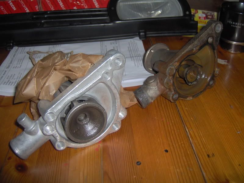

I've spent past few days figuring out why my A series Metro has been overheating. Previous owner never cured fault despite apparantly changing thermostat. Anyhow replaced that as well as broken fan switch to no avail. All water pipes were getting hot apart from one going to and from the heater. Checked for blockages and found none.
Anyhow, disconnecting pipe from top thermostat housing proved that no water was pumping through at all so figured maybe water pump was ineffective. So removed water pump and was quite shocked to find that the rotor blades have virtually disappeared!! Fitted new water pump now and running great. Thought I'd show you guys a photo of the damaged pump though....

how cool is that ...um in an ,uncool way of course.
I know what Vegard is thinking *hehe!*
so where did that go then ?
Blimey Charlie, still it's light weight.
*surprised* not good

That's pretty bad, also awaiting viking comments about pink liquid

have you found the rest of it yet?

No idea where its gone to!

Did you flush the block and head out?? Personally I'd be spending a fair amount of time making sure the missing bits of impellor wern't inside your engine.
