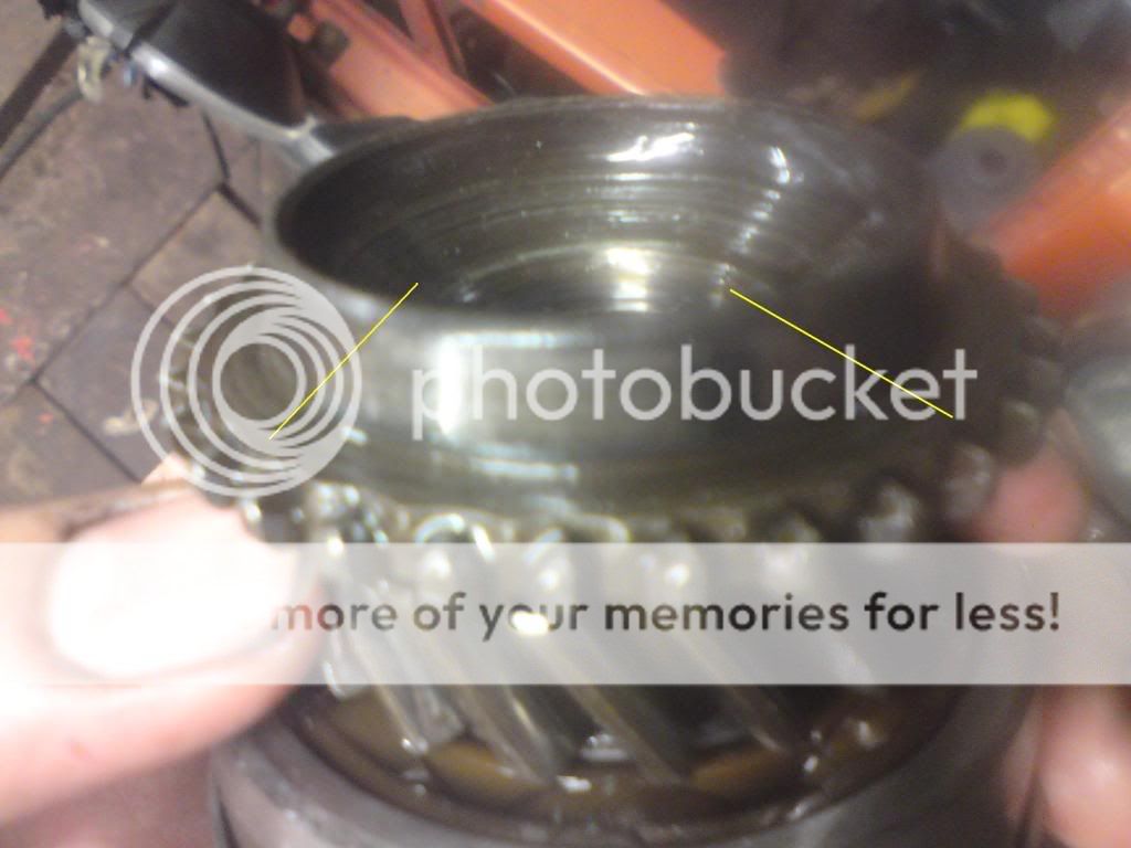

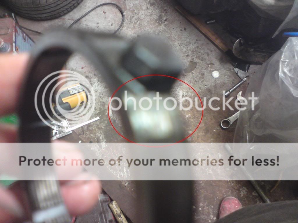

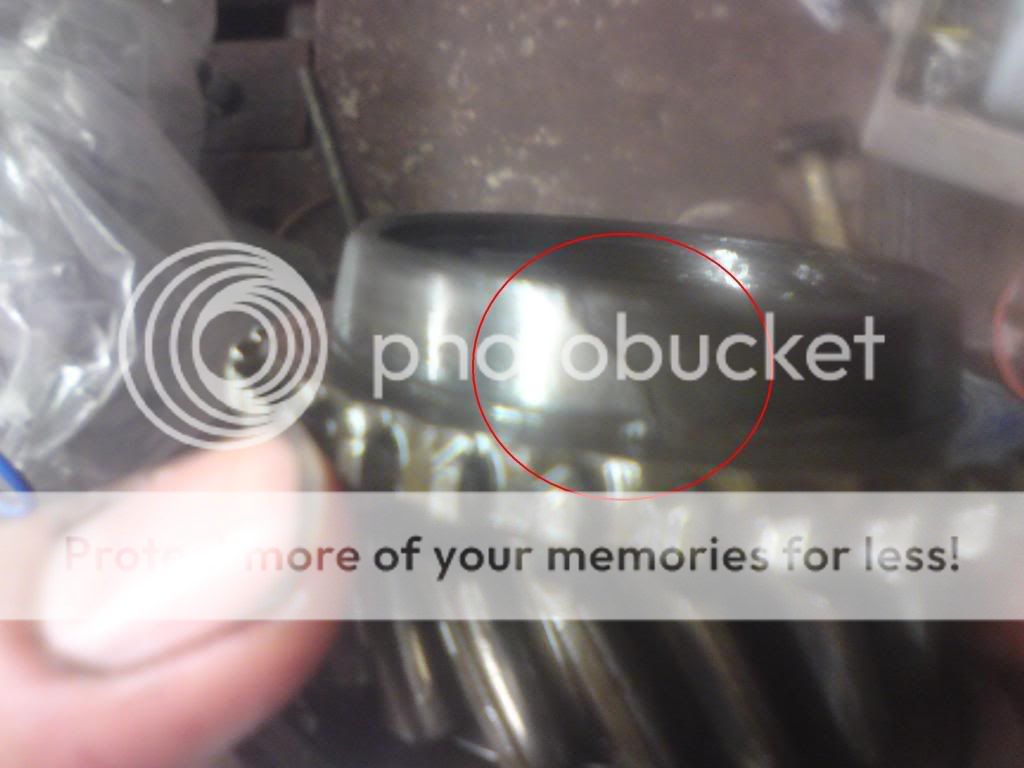

Firstly, where do the baulk rings wear? I was always under the impression the grooved inner being smooth would constitute wear. However, when comparing this surface to the new genuine rover baulk rings I have bought there doesn’t seem to be a huge difference. There are some ‘polished’ areas to the outer of the baulk rings, especially on two just before the triangular parts (highlighted in red). Is this just general wear?

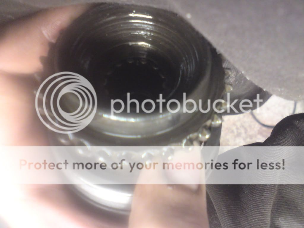

Also, on inspecting the 1st motion shaft I have found a raised area (on the area where the baulk ring sits, highlighted in yellow). Is this supposed to be there? My guess would be no. I have tried to photograph it the best I can. Could this be a problem with wear or manufacture?
If the baulk rings aren’t the problem, what might be? I was thinking maybe a problem with worn selectors?
Any help/input would be greatly appreciated. Many thanks

Can we have some decent pictures that show the parts you are talking about in full focus Please. All I can see is the floor.
Sorry to be a twat, but its not difficult to see that those pics are of no use, and it is also not difficult to take a picture in focus. How can you expect a decent answer with blurry pictures like those. Again, sorry, rant over. No offence :)
All in the best possible way :)

Fit the syncro ring on the cone. If there is less then 0.8mm clearance between the ring and the face where the dog teeth sit, the ring or gear is junk.
As Sprocket says, your pictures as useless, but the lack of coating on the cone is almost visible. The gear is junk.

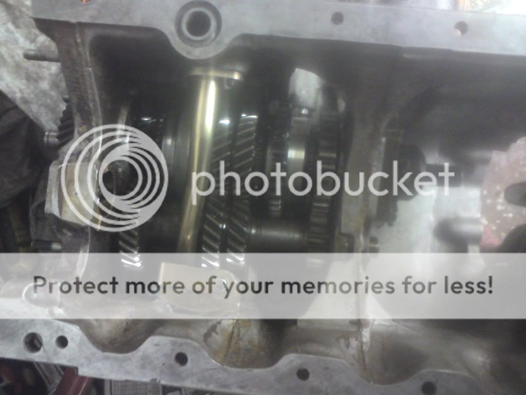

managed to get most of it back together this evening. changed the baulk rings, mainshaft and 1st motion bearings, as well as 1st gear needle roller. also fitted a set of selectors from an mpi box, they are much tighter, the old ones were well worn. you didnt have to measure, the wear could be seen by eye. also fitted the syncro hub and base from the mpi box. prior to this they all had the .8mm clearance, appart from the 1st motion gear. however after fitting the mpi cone and hub there is now just over the .8mm gap. will see how it goes anyway when in the car. the gearbox is slighty tighter turning over than it was, im putting this down to new baulk rings, the new selectors, and ner main bearings (not fully oiled). it still turns over easily by hand.

Raised areas on the baulk surface is probably what's left of the coating - new rings won't help much (if at all) and certainly not for long.
I agree. Refitting this 1st motion shaft is like peeing in your pants.
