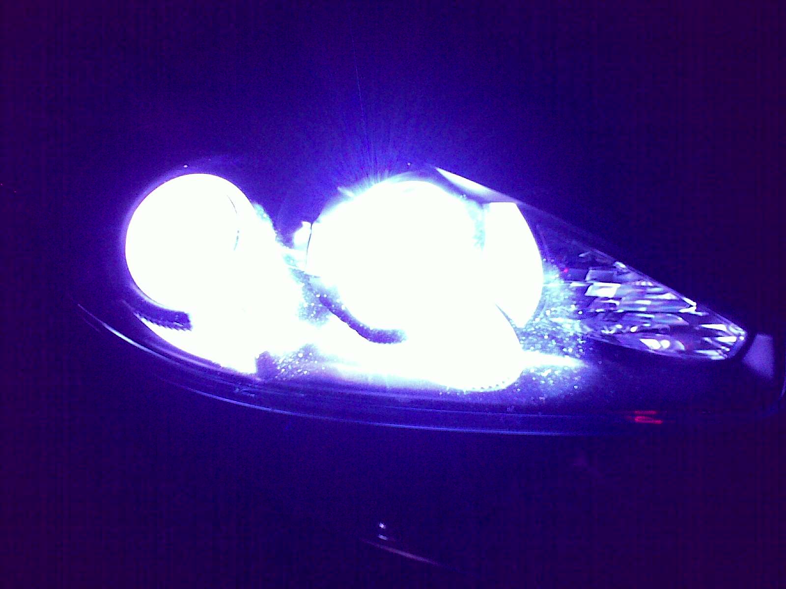

Here's mine :
http://www.in-car-stuff.com/shop/12v35w-60...26027204355d29a

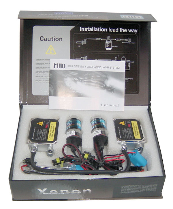

and a pic below of the Falcon kit.
EDIT : And low and behold, here's the Moss Europe kit for the Mini when fitted with H4 Halogen bulbs, except these are £153 ...... !
http://www.moss-europe.co.uk/Shop/ViewProd...teIndexID=15727

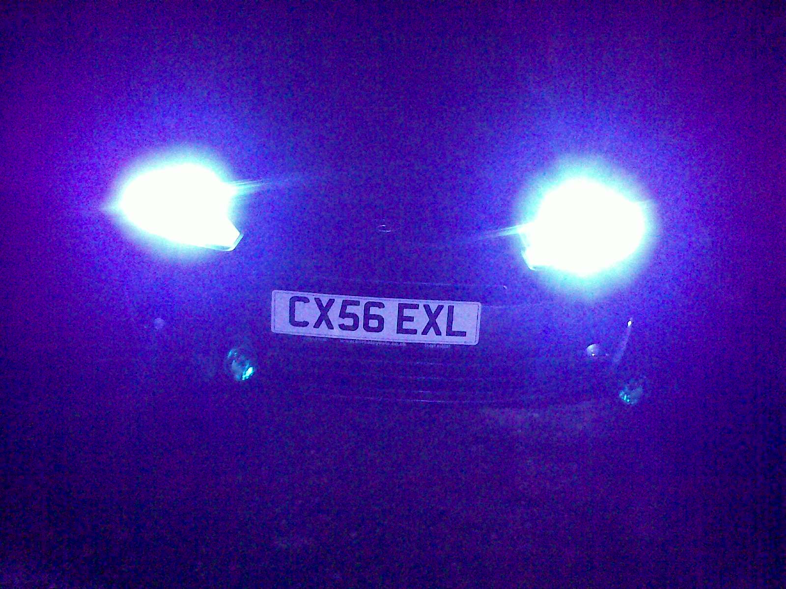

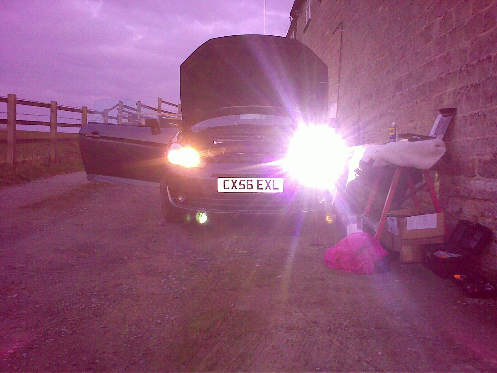

Some shots now attached of the difference on my Coupe.
Richard.

My Coup has neither but I do have the advantage that the dips are beam height adjustable by way of a dash adjuster switch if I get issues. That said, even as a straight swap, I had the dip beam heights and beam angles checked out and both are within tolerance of the Hyundai manual at the 3m check distance. If carrying load, I can set the beam heights lower.

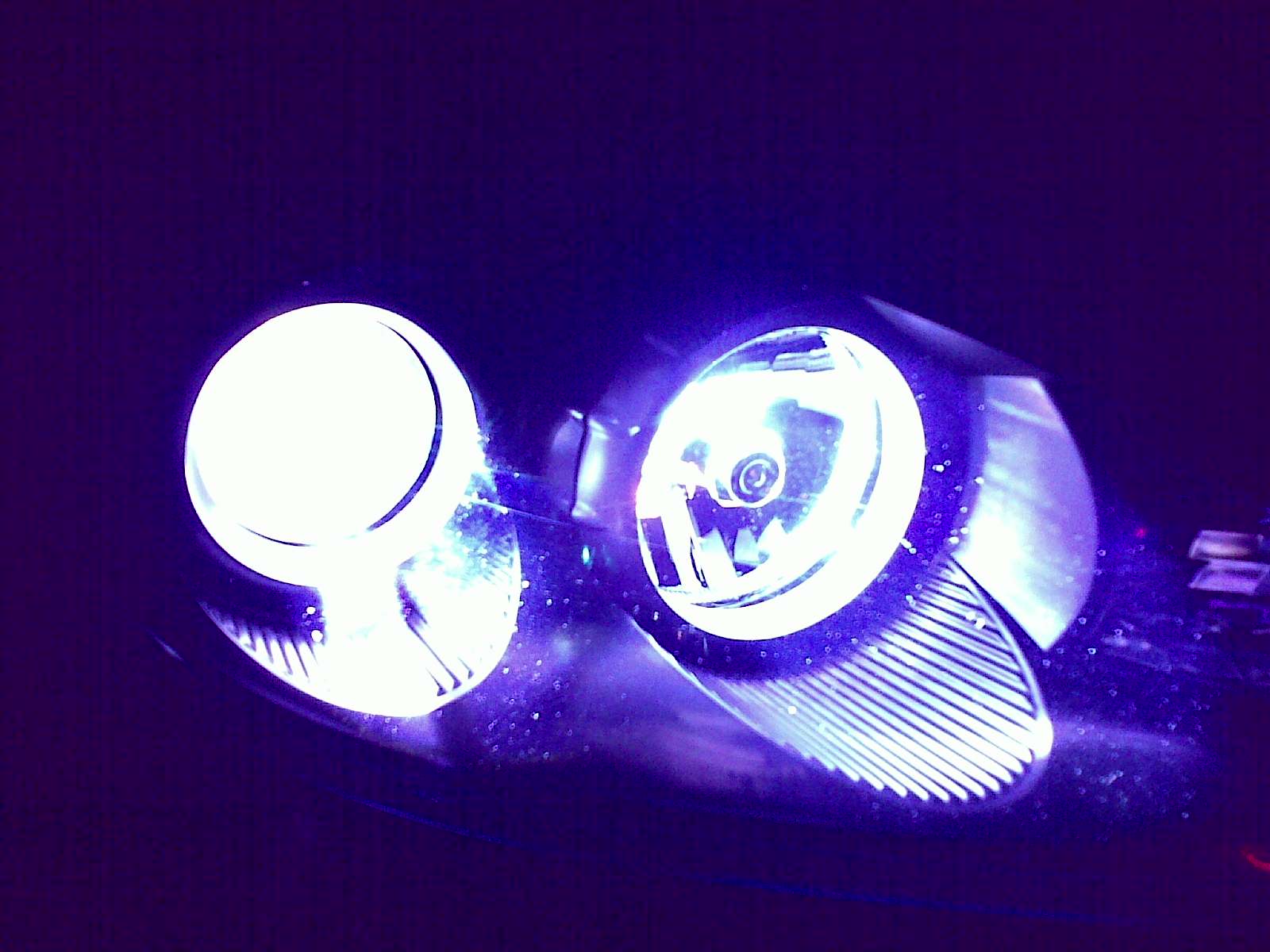

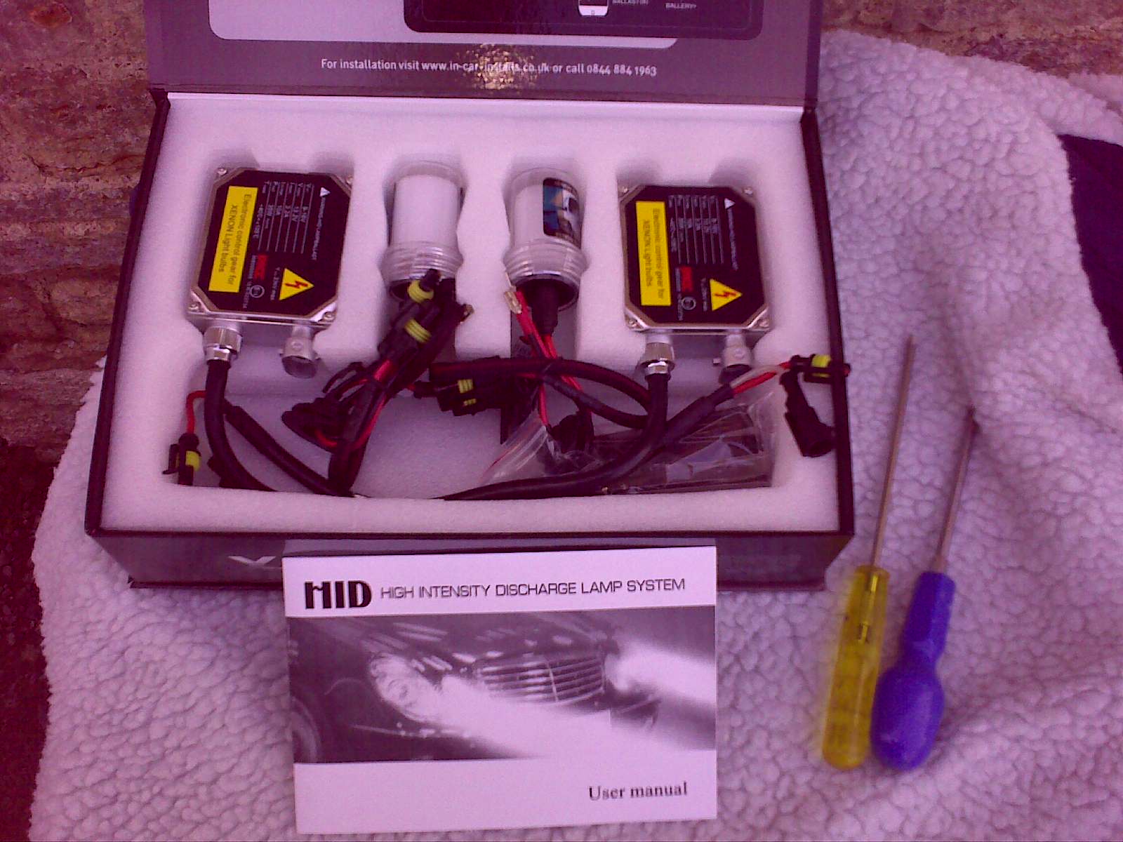

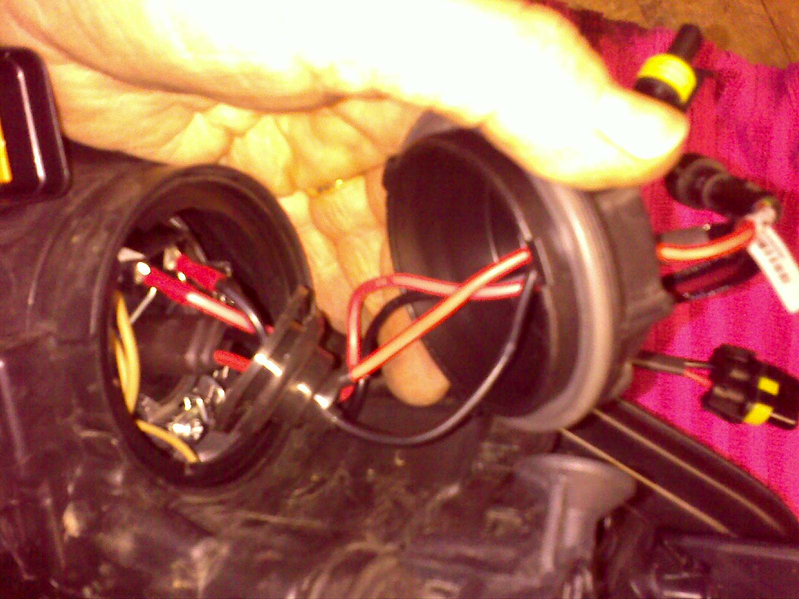

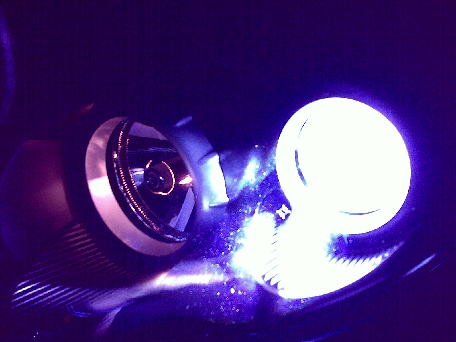

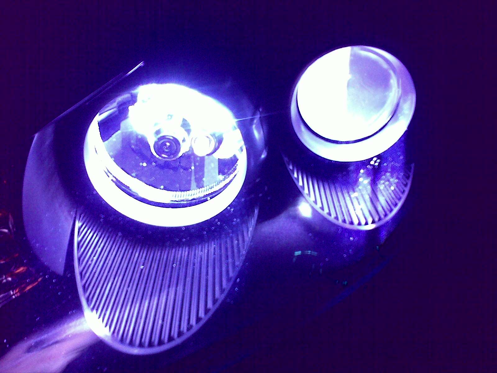

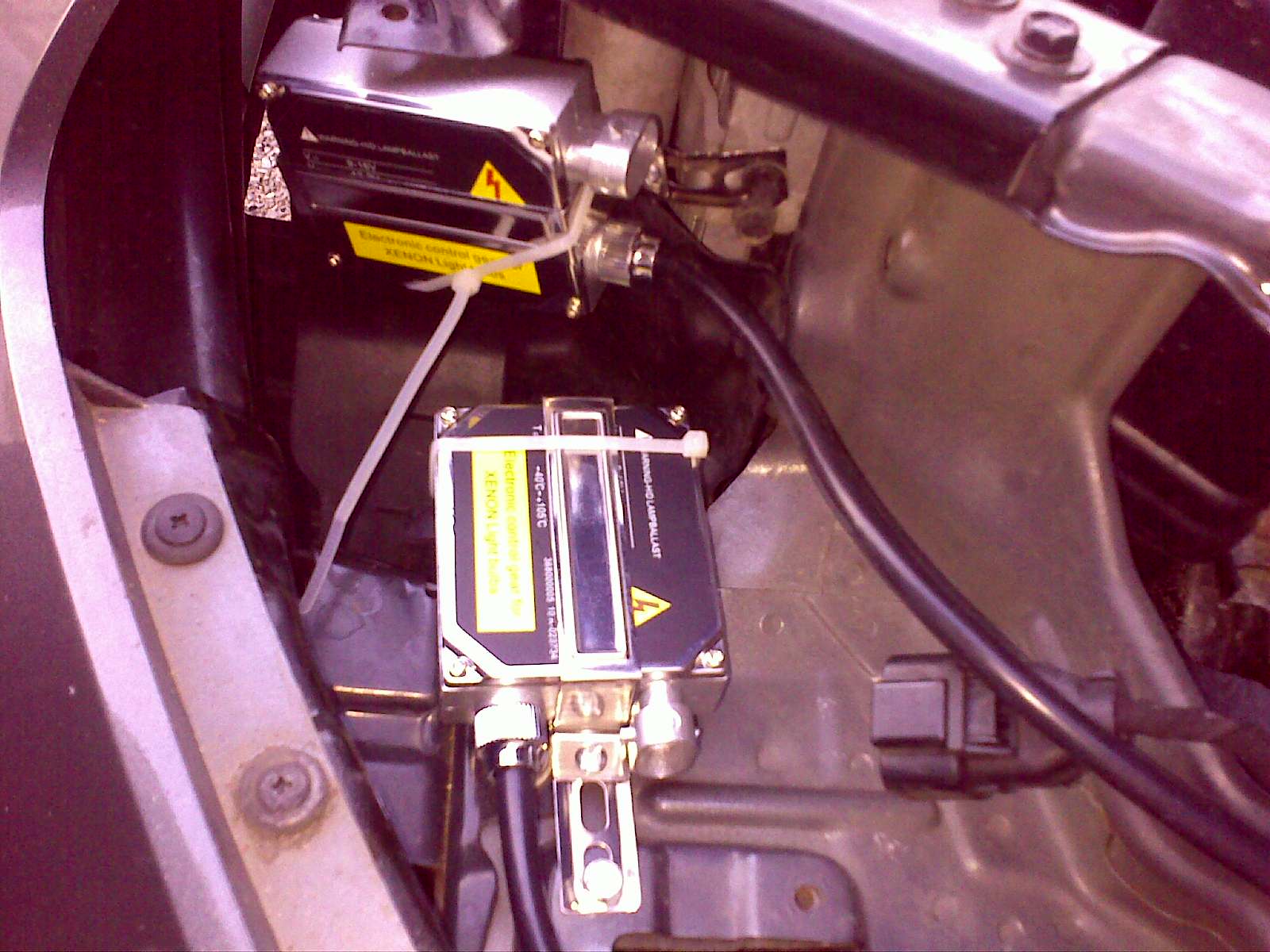

I've added some pics of the kit and how I fitted the bulbs and ballasts plus you can see the effects of the new lamps in how they give such a bright white light.
One shot which says it all is the pic showing the HID fitted on the passenger side compared to the Halogen on the drivers side. Darn good.
I also fitted white LED parking bulbs today and they now match the HIDs for brightness.
Brilliant conversion and well worth the money. They even do a combined H4 Dim/Dip single bulb conversion for £69 .........
Tempting for the Minivan but I'd probably only consider doing it if I could get hold of the later adjustable headlamps off an MPi or similar. Food for thought though.
Richard.

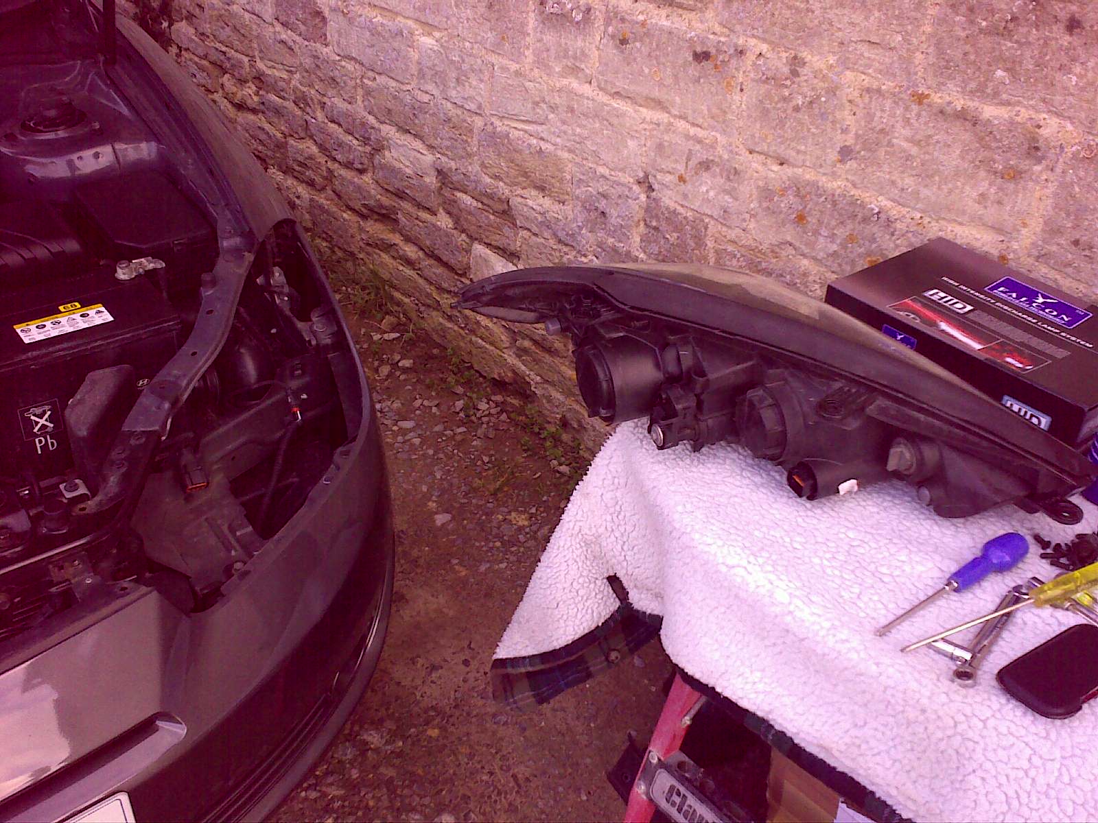

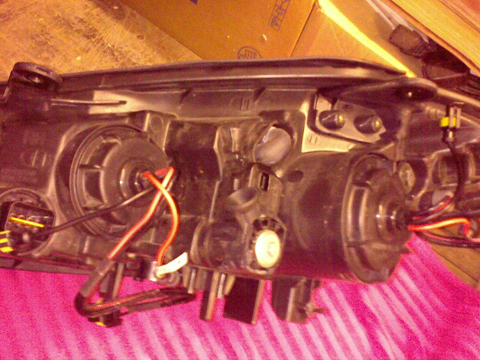

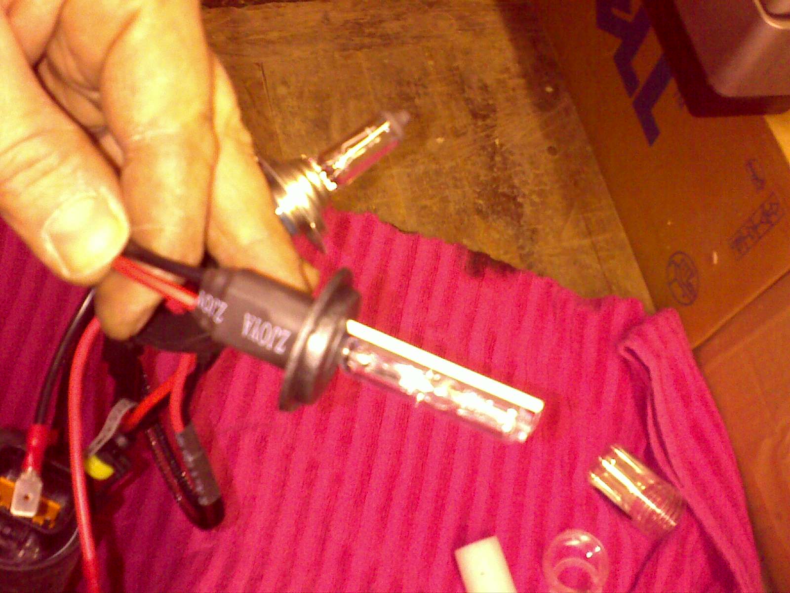

Some more pics of the work involved.

And the effect at night is stunning ......
