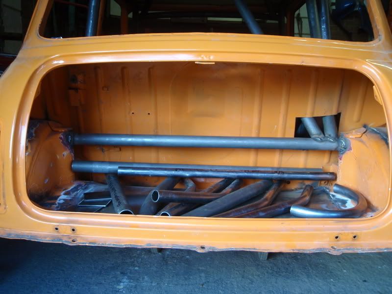

Timinichelsea
203 Posts
Member #: 479
http://www.turbominis.co.uk/forums/attachments/319361-1.jpg

Thanks, is that a tube welded directley to the arch or did you make some kind of bracket up?

Just welded directly.
Its not really a proper brace tube, i'd prefer that the rear legs of the cage attached at the top of the arch so it would all tie in nicely.

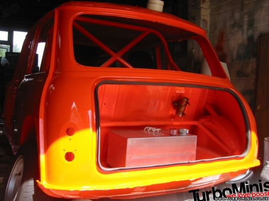

thats alot of rear camber mike *hehe!*
i like the frame around the boot though and the cage tied in too i bet thats a nice tight arse end*happy*

I was planning to brace it that much, go for what is basically a spaceframe with a non-removable body
In boost we trust
Yes brett shes puckered up tighter than a snare drum!

Mike - that looks great, will see if i can achieve something similar
