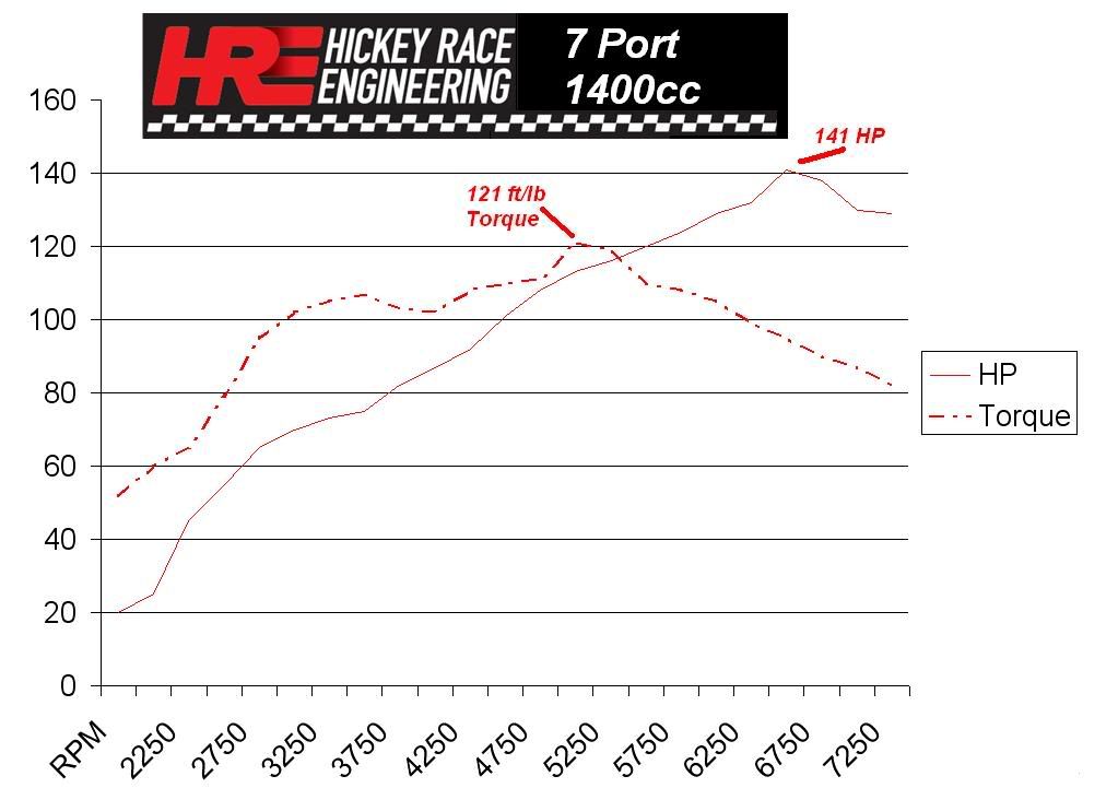

Well we spent a weekend on the rollers trashing the life out of this little 1400 and we are very happy with the results:
Spec of the motor is:
1400cc bottom end
Custom HRE cam with a duration of 286 deg
Fast road stage 3 head with 35mm inlet valves and 29mm exhaust
1.5:1 roller rockers
11.5:1 compression ratio
Pump Gas (no additive)
twin DCOE 45's
Mega Jolt
2" Maniflow Exhaust system
We put the engine in one of our top race cars and I can only say the thing is ballistic the motor will happily pull full throttle from 2.5k rpm and pulls like a train from there on.

well done great results, just a question, would the torque increase if you change the exhaust to 1.75?

welll done paul ,youv done well to bring it in so low down .. what make of rolling rd was it ? was this at the crank ? what were the losses ?

I don't know much about webbers but would 2 40's work well in this instance?

nice work paul - 1400 or 1460?

Phil: We original had a 1.75 system on the but got better results over all with the 2".
Robert: Hi Robert The rolling road is a Maha Rolling Road,
The figures where at the crank.
The losses where 13.6% so it has circa 121hp at the wheels.
Sturgeo: 40's would work Equally as well but we will be going down the road of bigger cams and more head work during the year so the 45's where a bit of future proofing on my behalf.

Whats the bore/stroke Paul?
PaulH
1346 Posts
Member #: 2340
Dublin Ireland
bore is 73.5 and the stroke is circa 84mm

thanks paul , i presume on a straight cut box in 4th 1:1,what tyres and pressures ,,and what diff ratio ?
