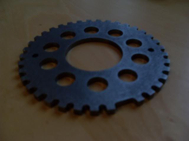

I have been busy at work and knocked up a few trigger wheels, not wanting to tread on Mr Fentons toes but these are much simpler than a machined ppulley, simply bolt on the same as triggerwheels.com
stats are :
135mm OD
50mm clearance hole for socket
5mm MS
10X15mm holes to cut weight
2X5mm holes for M5
335g in weight
36-1 tooth
as for price, not really sure.. how does £16 posted take peoples fancy ?

when a mate fitted his one, it was very simple, drill and tap 2 holes.. no real complexity to it, with yours its sending at away to be machined..
they are 2 completely different things, obviously the machined pulley is the best option, this is just the easier "at home" method that i can see

How can that ever be central without some serious measuring equipment? just for impartiality I don't like the idea of machining a damper either lol!

What I do not understand with these trigger wheels is why have the extra mass of the middle section when its fixed near the outer edge? Also, I'd like to have seen at least three fixing holes. As others have said, it might prove time consuming to centralise on the pulley.

I have never being keen on ether method, but it has to be done. 3 fixing points would be nice, also a CAD template printed on card showing you where to drill could be a nice addition?

I can appiciate what your saying, but with a vernier it really isn't that hard to get running decent enough, a mate has fitted one using nothing but a steel rule with no problems, looking at the trigger wheels its 40quid, I will add another hole for mounting today..
Anything else peolle would like to see?
Gaz
Is the large centre hole the same dimention as the pulley hole?
if so it should be straightforward to fit.
If they are the same diameter, a tube to locate the two during fitment would make it a piece of piss (if you get what I mean)

I understand what you mean, thinking on your toes, like it.. from memory its just 50mm to clear the socket, will measure a pulley and can adapt the wheel to fit.
Possibly supply a piece of the correct diameter tube to aid fitting of the trigger wheel

Just lasered out new design with 3 mounting points, to do this the 15mm holes have now become 11mm to stay on same pcd

Would it be easier if the 3 mounting holes were elongated holes following the circumference of it, maybe 10mm long each.
Just to allow it to be easier to set tdc ?
Any feedback welcome,
Why not change the number of large holes to a number divisible by three, ie, 9 or 12 holes instead of 10.
Then it would all be symettric again.
EDIT - and the 36 (minus 1) tooth pattern is based on a divide by three angle anyway.
Edited by Rod S on 30th Mar, 2010.
I would say elongated would be helpful

Unless you plan to use the center hole to aid mounting, why not just leave 5-10mm inside the mounting holes and chop the rest out?
