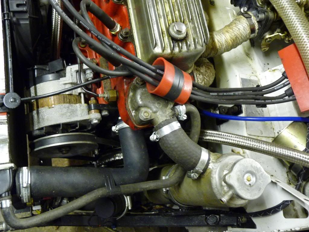

I used the SHEngineering plate on my car - spot on. The only issue I had was the diameter of the outlet was bigger than my front mounted rad, but easily resolved with a pipe reducer.
Very quick delivery, even after I had to send a cheque to pay for it.
What pump are you planning to use? I found a few good sources through the marine suppliers that seemed to be reasonably priced.

I bought mine secondhand through ebay after some clues from the Imp websites. On paper, you would probably be concerned at the flow rate, but it is a continuous flow (not engine speed dependent) and does an excellent job. The other thing I like is that I can come in off a stage, turn the engine off and leave the pump running to cool it down to a good starting point for the next stage.
I found a few links, but I think this is about the best price:
http://www.mackengineering.co.uk/products/...-MAG-DRIVE.html
