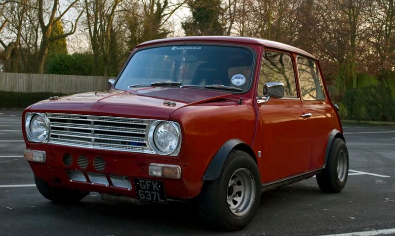

Well me and Andy dropped the engine into place on the clubby today and were looking at potential intercooler and front rad setups.
Tried a 2WD cossie cooler down where the 3 slots are which looks quite good but will probably need to get the end tanks tweaked.
Here is a link to the pictures of how we see it fitting.
http://www.flickr.com/photos/minimadmotorm...57623789272172/
I am looking for comments and suggestions on how it can be better fitted. If anyone has an pics of their clubby and 2WD cossie cooler setups they would be much appreciated.
