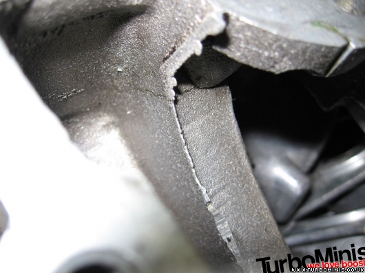

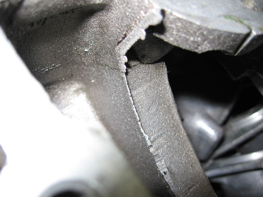

Firstly is this a common place to crack a gearbox casing? I dont think its a casting mark, but I could be wrong. Its on the top of the diff housing

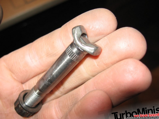

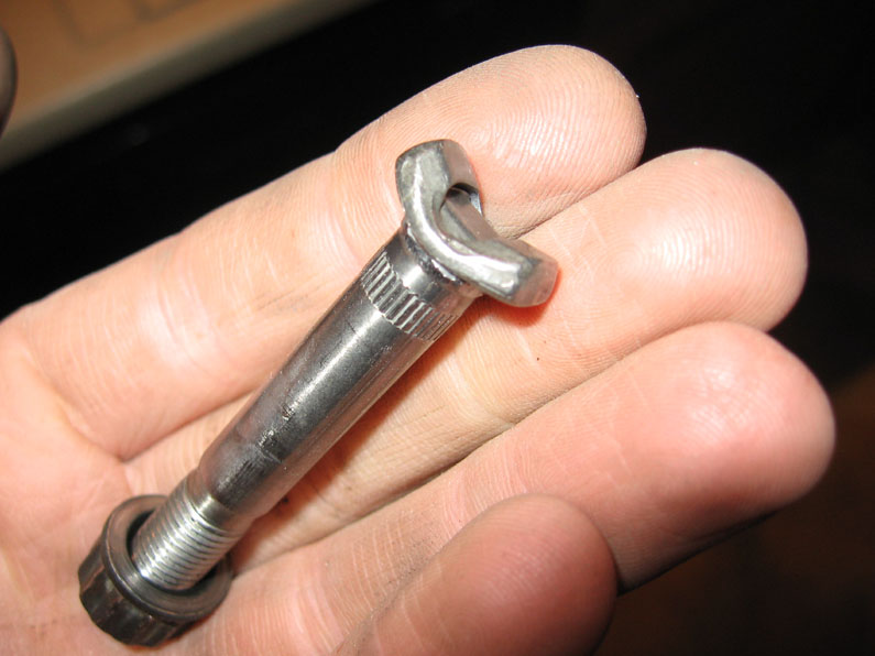

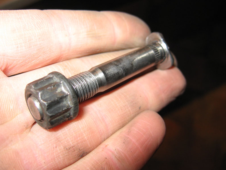

Are these ARP rod bolts, I think I may have been mistaken. They are 6 years old if that makes any difference to design changes.

The bolts look like the uprated Mini Spares rod bolt there defently not ARP
And that does look like a crack in the casing Auto Test gearbox crack here all the time.

I may have slightly over tightened them

ARP ones are black arn't they?
Fuck me Nic, I would have thought you would have stress relieved the gear case, or is that not one of yours :)
ARP bolts use a 6 sided nut, are black and have a far better finish on them, I dont recall them being knurled just under the head either.

Ill get some arp ones ordered, these have been holding up 7500rpm well though
The case was std, i was going to use another, got it on the bench to give it some work and spotted a horrible casting mark, picked up this one to go back to it and then spotted the crack.

Your casing definatly looks cracked.
thats the problem with cracks, theyre terribly moreish
They are definitely not ARPs.

and i think it is not a crack but a casting joint,
All ARP bolts say ARP *wink*
If they have a small "Knob" on top of them, they are the uprated Minispares ones that now are discontinued.
