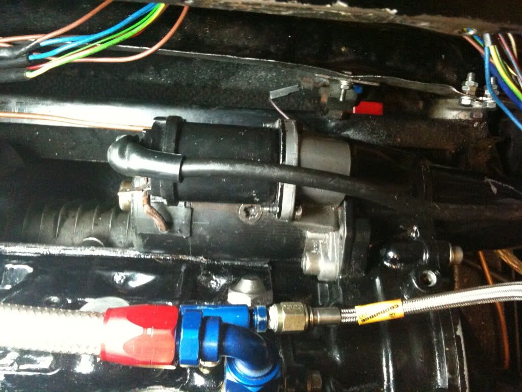

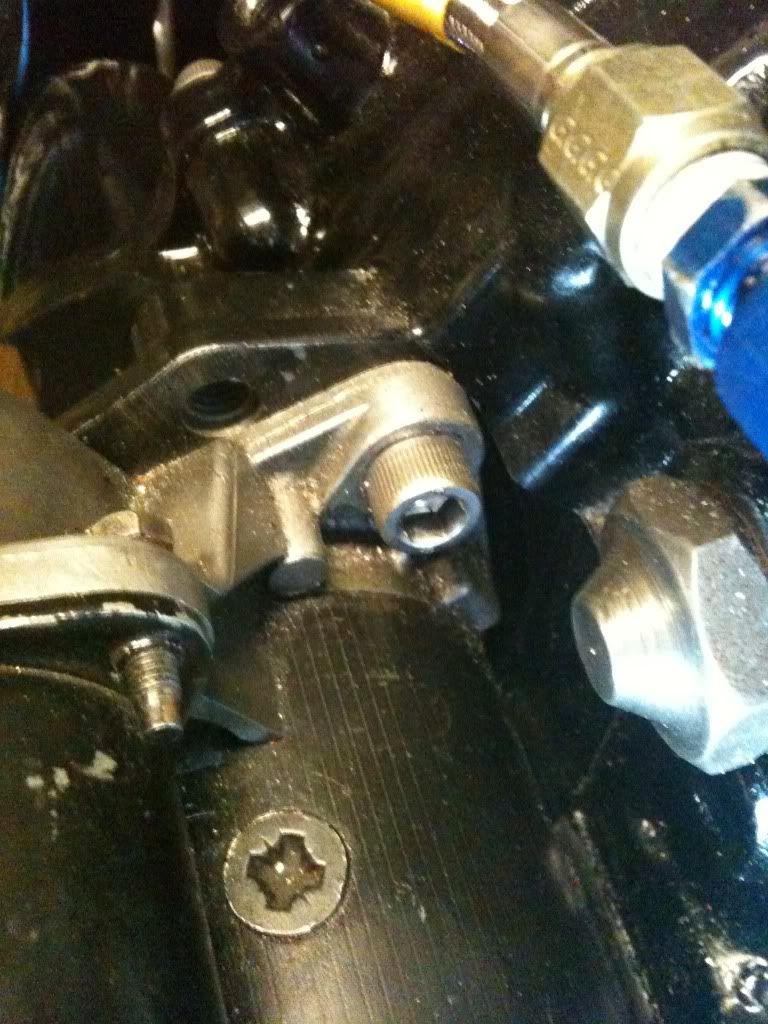

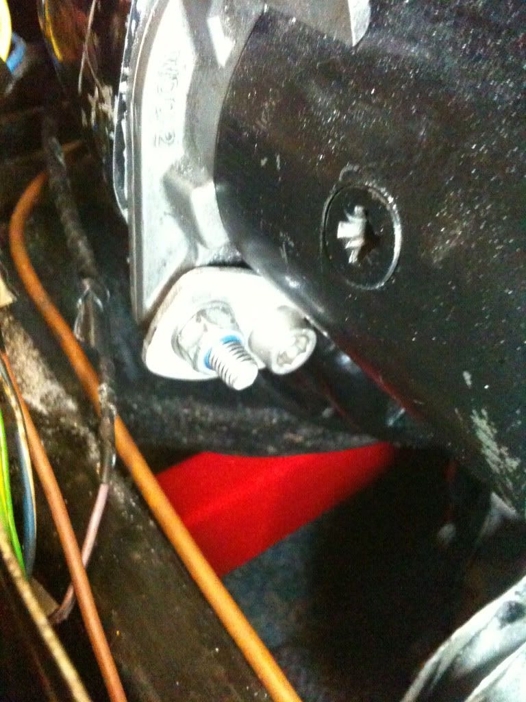

I found it but the pics are missing. I'll see if I've got any pics of mine.
It's just a case of rotating it and drilling tapping a new hole at the top, then making a small bracket to extend the bottom one. It will become obvious when you have a look.

Here's mine...
Excuse the mess.
