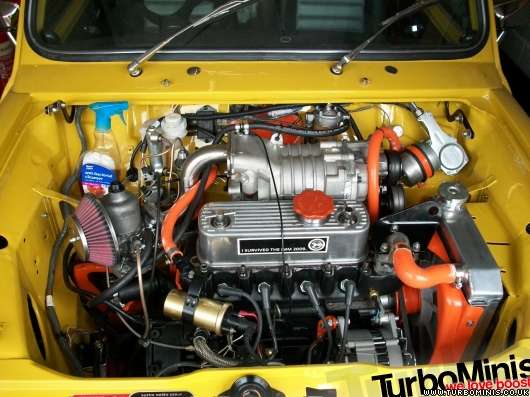

Hi guys,
I am having big problems starting my Vmax scart suck through from cold or when left overnight. This is my second attempt with the M45 on 2 different cars and engines. I had the same problem on my other mini.
The only way to get it started is to remove the air filter and spray petrol into the carb and it starts straight away, like magic. The fuel just doesnt like travelling all the way from carb up the inlet pipe and through charger on cranking.
For this build Stuart @ Vmax as made me a shorter length inlet pipe with smaller bore to help with the problem, to increase air speed. I have matched the bore with a recon HIF38 and also tried rebuild HIF44. I also have a high speed geared starter motor to increase cranking speed. Checked timing and advance all spot on, and wide band AFR all look ok.
Once started it runs really well, especially on the sw5 cam, but am about to give in with the idea altogether and go back n/a route.
Looking on other forums this seems a common problem, anybody got ideas??

more choke? post a pic of your engine bay maybe the pipe is whaye too long :)

Tried full choke, Fuel pressure 3.5psi. There is far more vacum at inlet manifold (head side, after compressor) compared to carb. Dizzy advances far more and car runs better if taken there. I have checked for air leaks and no problems anywhere inc gaskets, vacum take off, carb etc. Will the postive boost damage the vacum unit on aldon dizzy at 10psi?
id put a hole in the bonnet and strap the carb straight on the side of the blower .
those 2 90degrees bends wont be helping the fuel clime to the blower much, especially at such a low airflow whilst cranking, im with robert im afraid
that link pipe from the carb - charger needs to be straighter
Yep, got to say I agree with Brett here
Install fuel injection and bin the carb
Apart from your prob's, it looks like a very nice install. Any more pictures of the car?

hole in the bonnet, johny sti on here had a webber 45 on the end of the eaton poking out the bonnet :) look pritty mean

Short straight pipe! Play around with your timing a bit. I had a suck through right down behined the grill and it started no propbs
Only pussies use sc!
Mine SC setup (sc12) just needs some choke but the inlet is straight. It might be worth moving that fuel pipe. I drilled and tapped the other side of the float bowl so I could put the fuel into the other side of the carb.
