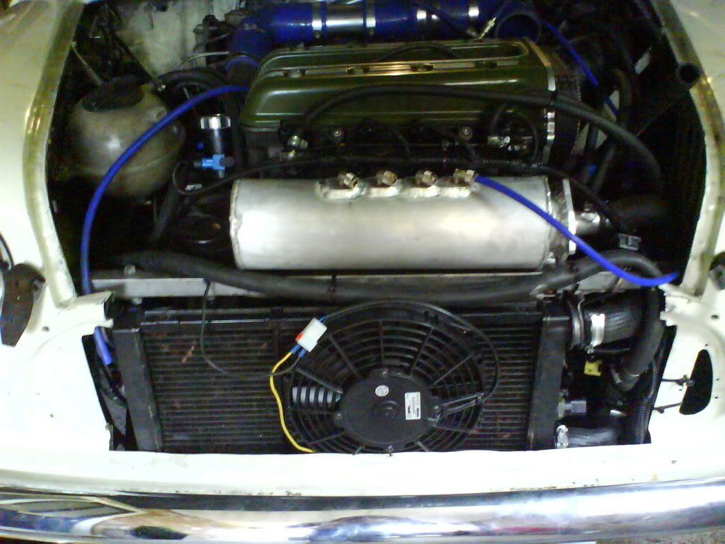

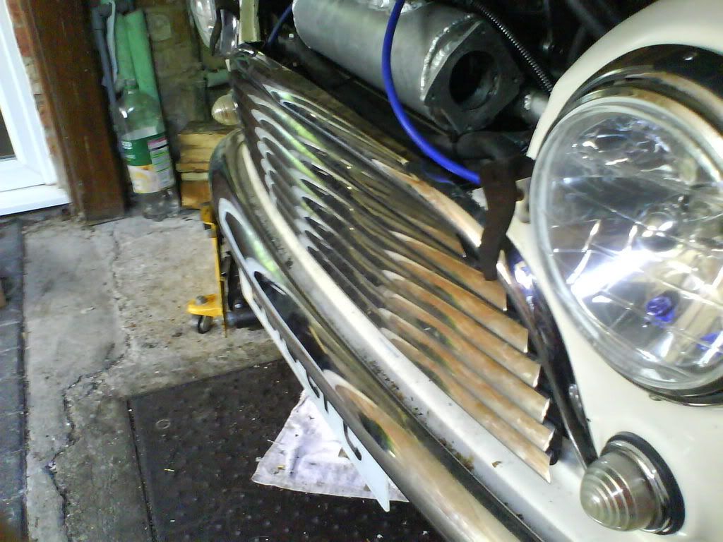

Here's a very old pick of mine.
And with fan on. I had to space the grill out an inch or so, and put a slight curve in the grill.

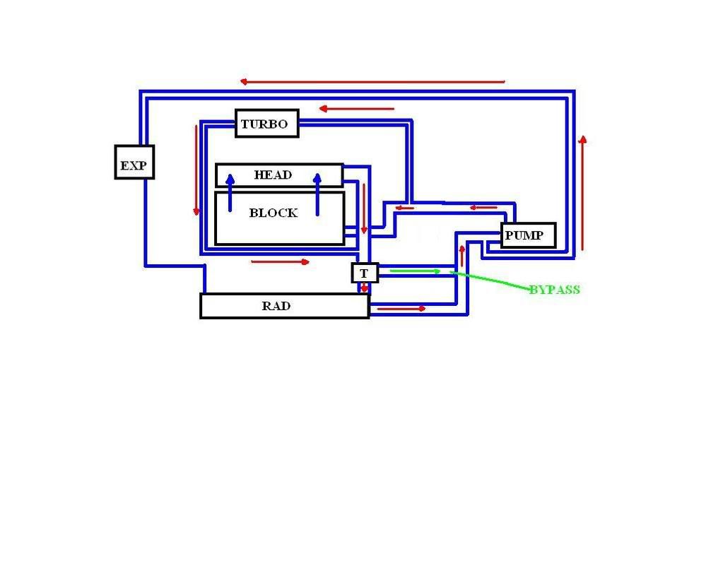

Mine is plumbed in like this, with an electric pump though. When using a mechanical pump, I put the heater feed from the bottom rad hose to the expansion tank, then the bleed from the top of the expansion tank to the top of the rad (little outlet pipe). I used a VW expansion tank.
