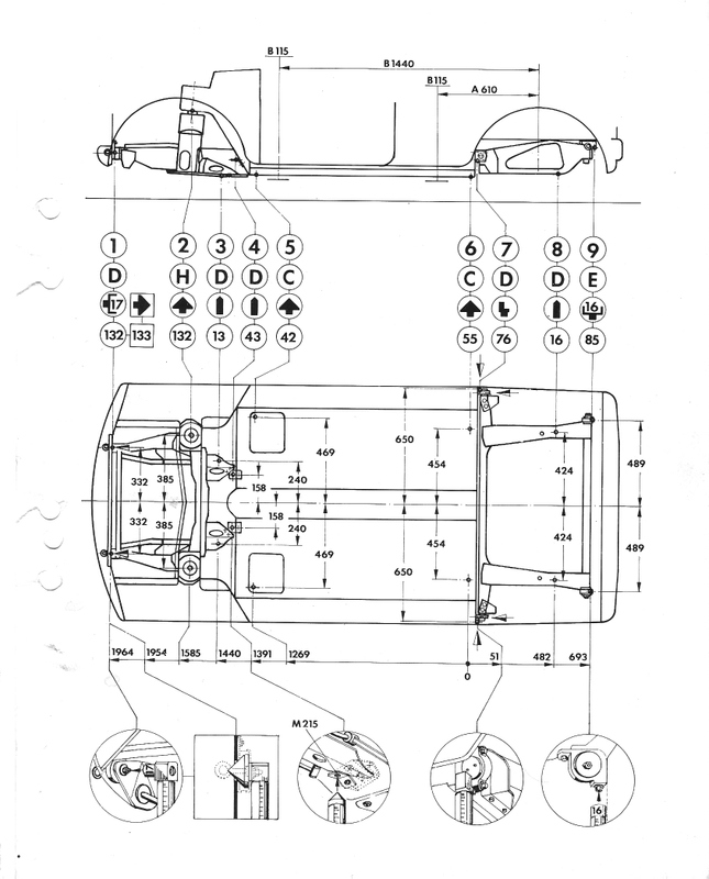

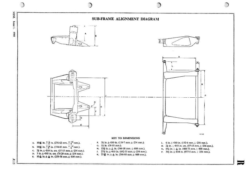

plus making simple measurements from fixed points on each side, ive just made some brace bars and use this method to check straightness
