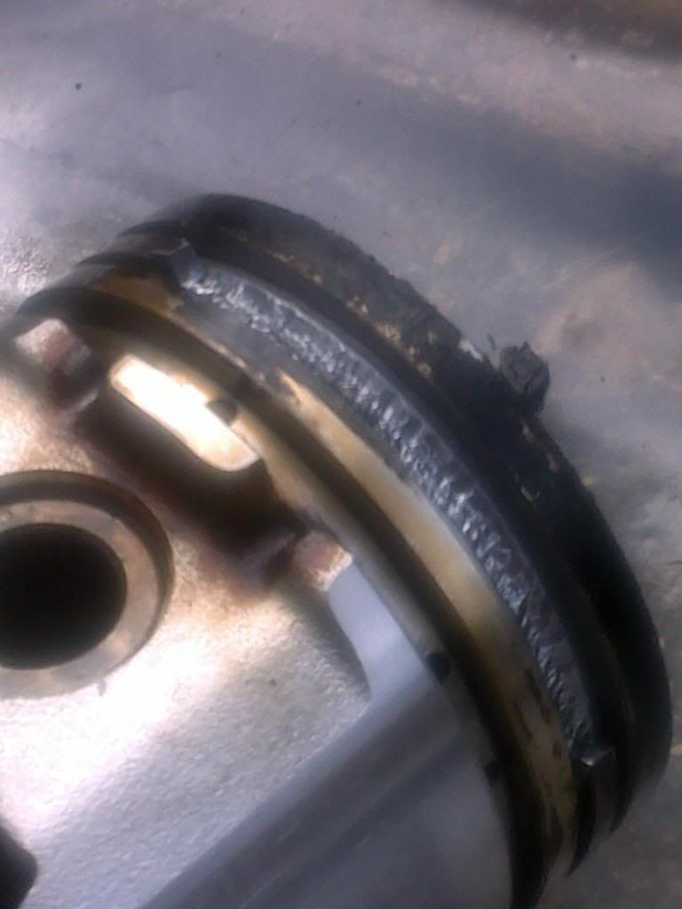

I am curious as to how this may have happened :( so any suggestoins from people who know about this sort of thing will be appreaciated.

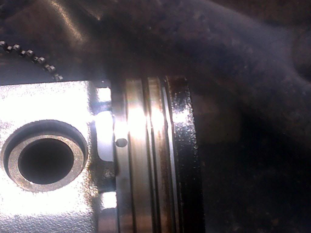

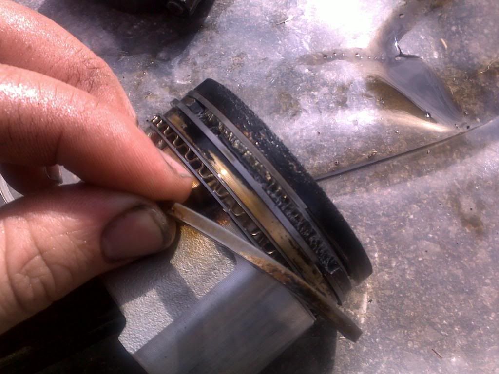

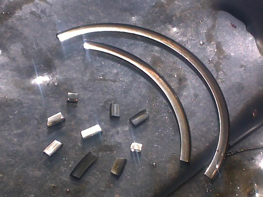

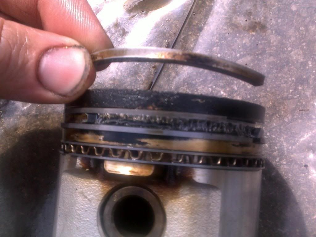

Right, the cracked ring (1st ring) was on piston number 4... pistons 3 and 2 were fine, no bits missing from the pistons and no cracks in the rings. however piston 1 also had a cracked 1st ring and a rather large chunk of material dropped off when the piston came out! (see pics) Also on the one with the bit of the piston that fell off, the con rod was stiff and wouldnt swing more than 40 degrees and would seize etc? (too hot?)

what boost ignition timing, fuel an cr were you running?
first thing i'd say is its due to det, but the piston dosen't look eroded above the top ring.
piston clearance wise, you can end up with a lot of gap at the top of the piston, the clearance is measured down at the bottom of the piston under the gudgeon pin, you will find the croun will measure a lot less than 73mm.
I think its worth pulling off the intact rings putting them in the bore and measuring the end gap, if its small (sub 12thou) it suggests that the rings may have broken due to expansion.
Pistons 1 and 4 run hotter, especially 4.
So, as Joe above, I would suggest measuring the ring gaps from what you have left.
But was there any other signs (ie, audible noise) of detonation ???:

As others said. Detonation is one suspect, but more likely ring end gaps far too tight.

AND the gap in the rings is about 2mm not 12thou.... :(
PLUS the rings were slightly bent and they moulded them selves into the piston and with piston 1 it sort of pushed the lip at the edge where the ring sits up/out and created a burr??? lol hows it done that?

2mm ring gap? How on earth did you manage that?
Johnny
1183 Posts
Member #: 6926
Accrington
no idea, at the time of build it was 25thou i think. im just hoping that my new engine build will bloody last longer than 6k! lol

We've already stated the cause. It is either ring gaps or detonation. There were no if's or buts.
