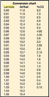

might this help?

Get the wideband on, sorted.
