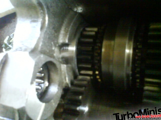

A mate of me had to enlarge the slot over the 1st motion's bearing to put a 14mm pre-A+ mainshaft into a late A+ gearbox (DAM5626)? http://img384.imageshack.us/img384/2051/dscf0005qu9.jpg - or am I missunderstanding something here? :)
But maybe he's lucky and got one of those very late GT boxes with 2 step layshaft & 18mm nose bearing (DAM3168 laygear) :)
MiniSpares sell conversion bearings with a sleeve to run pre A+ idler gears with a A+ case. http://minispares.com/Product.aspx?ty=pb&pid=38305

Those 5626 casting seem to 'fluctuate' quite a bit anyway :) There are probably some you get away with, and with some you don't. Interesting.

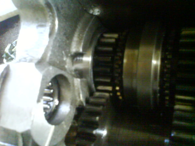

Im running an A gearset in an A+ box. The cutout doesn't need to be all that big, this is mine.
