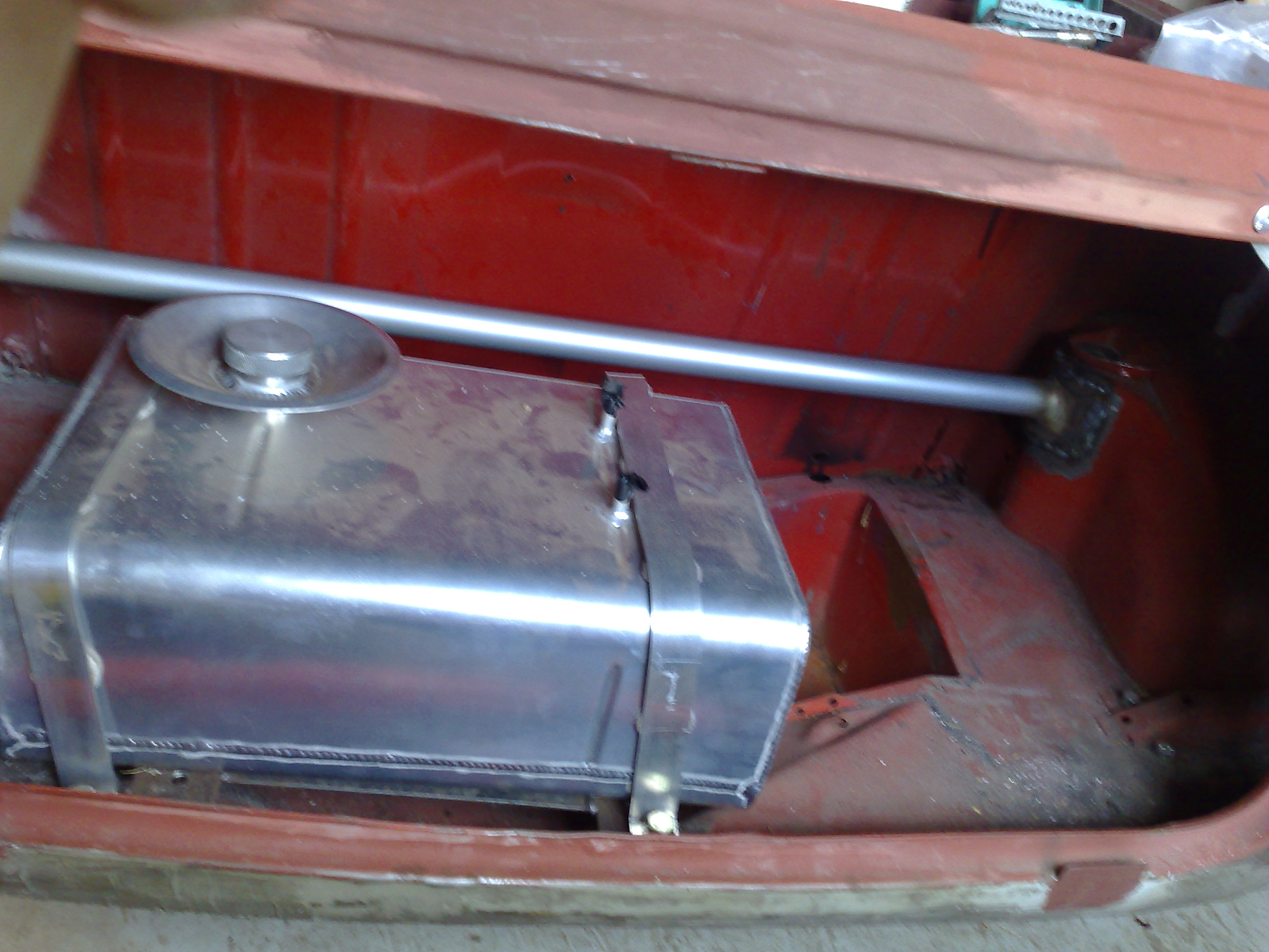

I think i might have found the problem but i cant prove until i have new t peice on.
I disconnected the fuel lines from my foam filled alloy tank again and tryed blowing directly into tank outlets one at a time.
On the tank outlet i had my return fuel line going to i blew down and it blew fuel straight out of the other tank outlet.
On the other tank outlet which i have my pump on i blew down it and i just got bubbling sounds.
does this mean i have inlet and outlet mixxed up on tank as there is no markings?

can anyone tell by looking at my tank weather the two outlets are flow and return as i think this maybe the cause of my problem.
Maybe there is not a return in which case im unsure of what the other outlet is?.
Sounds like you could have them the wrong way around to me.
Is the tank vented?
turbo22
492 Posts
Member #: 3684
wisborough green west sussex
thats what i thought, the tank is not vented it just has the two outlets
One will be an outlet and one will be a breather
Take the cap off and try it
It sounds like you might be pressurising the tank
Edited by Nic on 4th May, 2010.
Good call nic.
Could he use a vented cap or I suppose get the tank modded for a return.

An outlet for an external efi pump on the top of a tank.....thats funny *happy*
Now seriously....catch a grip. Even if its dipped, its a bloody stupid design.

efi pumps do not self prime.
The pump must have a good ample gravity fed supply of fuel.

ok thanks in process of getting another outlet tigged onto tank low down.
stevieturbo
3597 Posts
Member #: 655
Northern Ireland
And always ensure that there is an adequate reserve of fuel at all times for an efi pump
Either via an internal collector, a sump, or a swirl tank.
Never simply plumb an efi pump into a large open tank....unless you intend keeping it more than half full.
On acarb engine you'll get away with it better than an actual fuel injected one...but the pump continually seeing air will kill it in no time.
