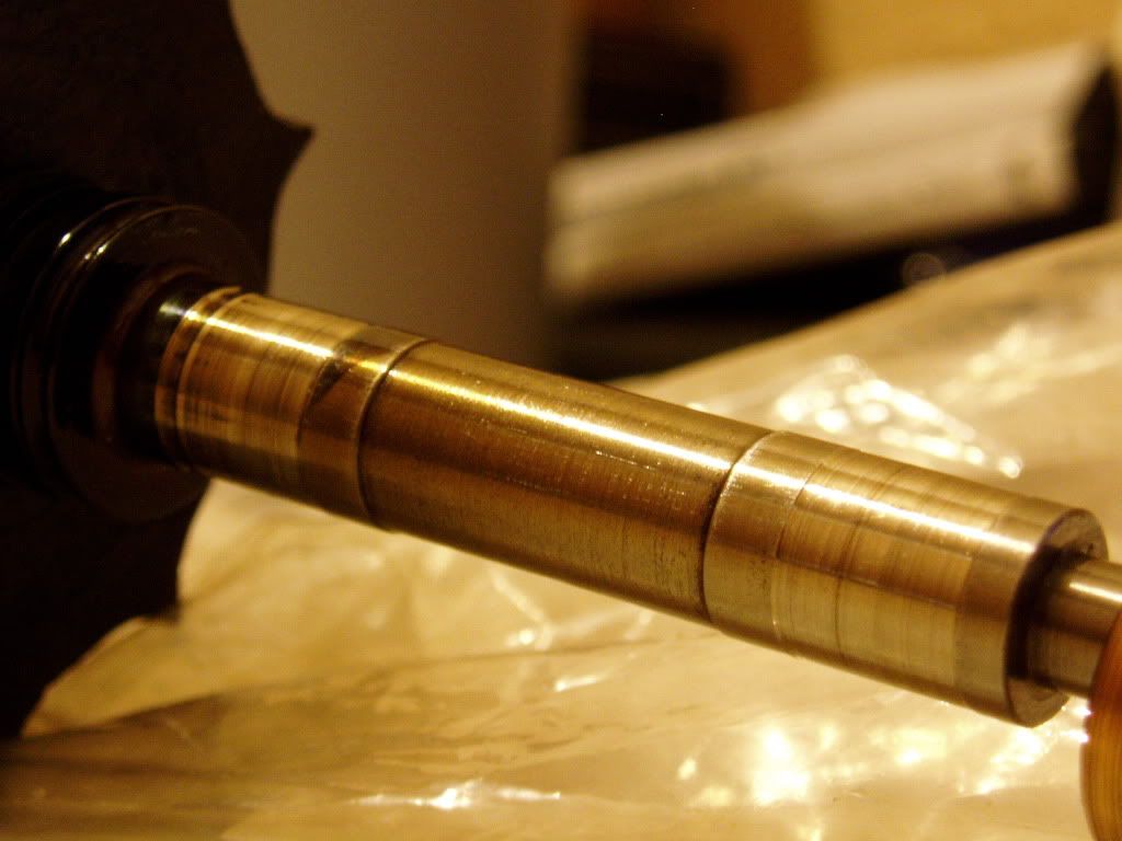

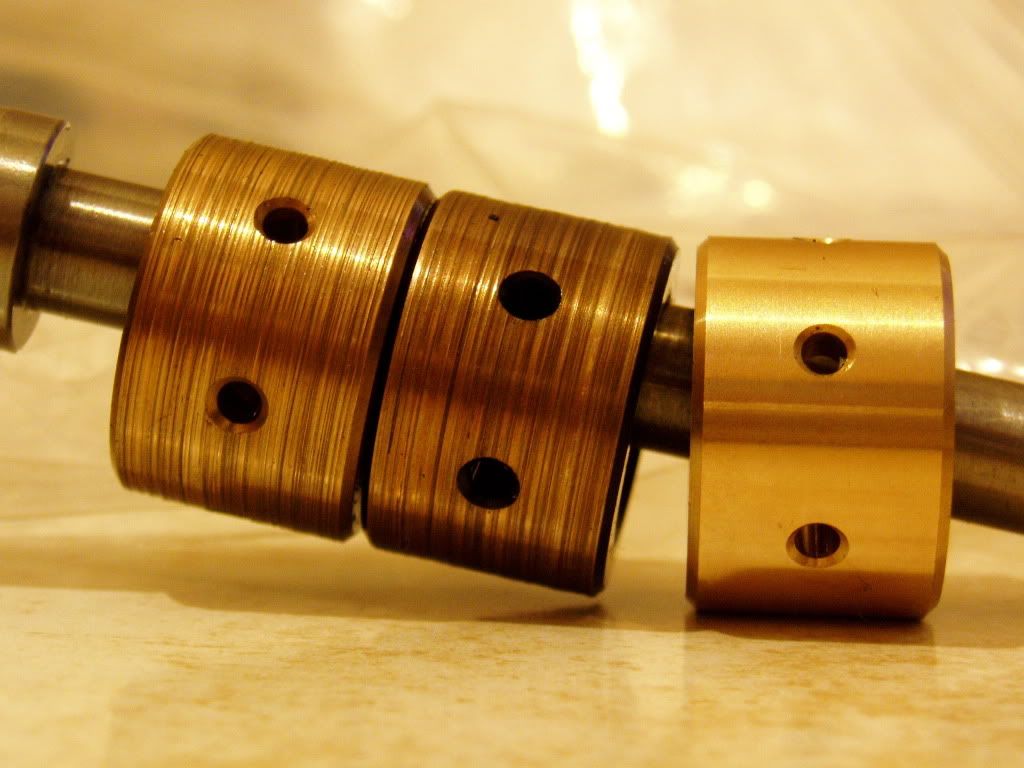

here is a photo of the turbo bearing after only 300miles of use with a completely fresh engine build, if the oil filter was doing its job i dont see how this happened this also happened to EVERY other component...
i had the engine cleaned lots of times to make sure all swarf came out, i changed the oil (and filter) after 10min of initial running of the engine and after 100miles! but still this happened. i had a magnetic trap at the back of the gearbox and the normal sump plug..
http://i185.photobucket.com/albums/x28/joh...cs/P1010005.jpg
http://i185.photobucket.com/albums/x28/joh...cs/P1010008.jpg
Edited by Johnny on 7th May, 2010.
When you ay you had the block cleaned lots times, how was this done?
I generally spend an hour cleaning the oil galleries with bottle brushes, pipe cleaners, parafin and an air gun. I then spend another hour on the rest of the block, getting a good scrub with a stiff nylon brush and parafin. The oil galleries are then given a final clean with the brush, parafin and compressed air before the gallery plugs are fitted, and the assembly begins imediately. any open holes in the oil supply system yet to be filled with something are taped over.
Simply chucking the block into a hot dip cleaner won't clean the oil galleries.
I say that, and it could well be your oil filter head bypas valve is jammed open.

well, whatever minisport do to clean block is what it had done... they usually dip it, i would have thought they would have used an airline on it. but thanks i will definately give it a clean myself aswell to make sure nothing is in there...
How common is it for the bypass valve to be jammed open? is that the ball bearing in the oil header?
I get the feeling that the real problem is contamination from machining deposits. Were the gallery plugs removed? A dip and a blast with an airline is not suficient. Machining debris is surprisingly abrasive.
I don't think you need an inline filter just for the turbo when the majority only rely on the main oil filter and have no problems. Plus the inline filter for the turbo won't protect the engine. Fix the real problem first :)
