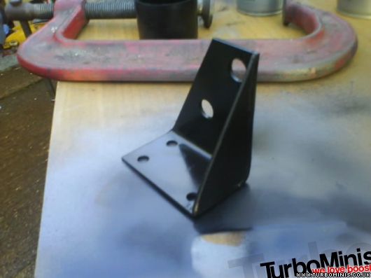

eden did you triangulate the inner L shaped brackets? I did on mine as you could flex the L shaped brackets by hand without it. Without the extra bracing I could well imagine the handling to be a bit scarey!
eden7842
1755 Posts
Member #: 8852
leicestershire
matty have you go a pic to show me which bit do you mean?
Like this...

thanks matty, no i havent done this but i will be now.
