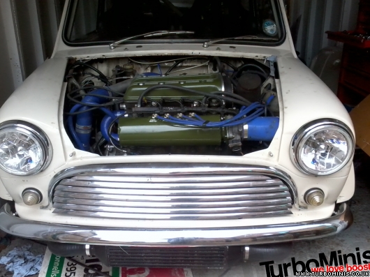

Well im pretty chuffed to say the least. Ive finally managed to get the engine back in. *happy*
Ive ran the water pump up, and unfortunately one of the welds on the bypass hose is leaking, I think its time to try out some of that ceramic sealant jollop. *oh well*
To do list:
* machine a new crank pulley
* Fit fuel tank
* fit head oil return
* check cam timing
* Fire her up!!!

Top job Matty !
Cant wait to finish mine !
"Try to take over the world!"
Mine looks like there is an engine in the car, but infact, there are no internals whatsoever in it *hehe!* the block is still at the machine shop.
How much boost you running this year Matty?

Enough to shake to rivets loose on my floor pan. *hehe!*
My map sensor only goes to 21psi, so limiting it to that. Should be more than enough as I was running 10psi and getting 155bhp at 3/4 throttle. lol
Ive got to try and work out how to set up the VEMS boost controller now.
Is yours going to be done for Avon?
Matty, there is a whole new look to Vems, with many more fetures, it might be worth getting together to upgrade to something a little better.
I wont be at Avon, not because that car wont be ready (which it wont), but I do inted to have it together for MITP. Just got the head ache of the down pipe to solve lol

Haha, I know I won't have much time soon, so trying to get it all done now.
John - Ive still, got an MOT, suspension setup, mapping, and no doubt fixing of some teething problems to go!

Loving the green!
Looking good.
It seems a bit late to be thinking about machining a crank pulley though?
Cheers. I machined it up today. Ideally I would of fitted it before putting the engine in, but its only an hours work to bolt it on in place. :)
