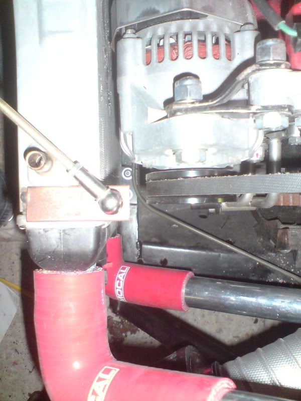

Because the switch comes in from the back (now we've confirmed it belongs on the hot header), unlike Gavin's in from the end, it fouls the alternator.
If I move the rad to the left or right to make the switch avoid the alternator, the Metro hoses don't fit......

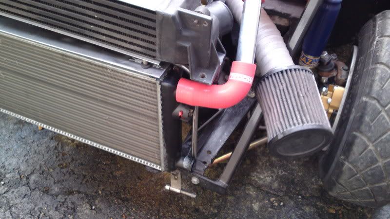

Cant you block the hole up and use an electric fan controller that goes in the top hose etc? Probably not worth the expense/hassle when you can get a new rad for £30 though. Saying that looking at this pic you should have enough room.
Edited by t3gav on 21st May, 2010.
I could make enough room if I moved the radiator forwards but I can't move it much because, although there is loads of room in a clubman flip front, because I've hinged mine upwards, the first part of its movement, the lower lip would hit the rad.
..... unless I lean it forward at the top.......
Back out with a tape measure........

I'm sure you could move it an inch to the right and use some 90 degree silicone hose and get it to fit.
Didn't see your (latest) piccy initially.
Now I can see it, yours is further to the left than my intended position.
There are possibilities but I was trying to use standard parts (ie, hoses) wherever possible rather than absolutely everything on this build being a "one-off".

Can you re-design the top alternator mount? The alternator could be mounted as per the standard alternator If the mounting tap is narrowed (to ensure the belt is straight) and the main cylindrical body if ground down to clear the block. This will allow you to shorten the bottom mount (assuming it is possible, I can't see it in the pic) and bring the alternator further from the rad. It will require a shorter belt too.
Am I missing something, as that seems like an easy solution but hasn't been mentioned?
EDIT: Never mind, I see you have ordered a Fiat one. The fan switch position won't cause any issues with one of those
