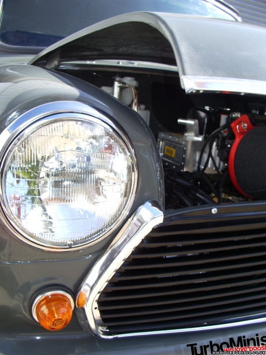

its snuk under the bonnet of this un assuming Mini!

Hey, could we have more pics of this beauty?

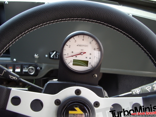

Has the rev counter for it turned up yet? I really want to see how nice it looks, and how it needs wiring!

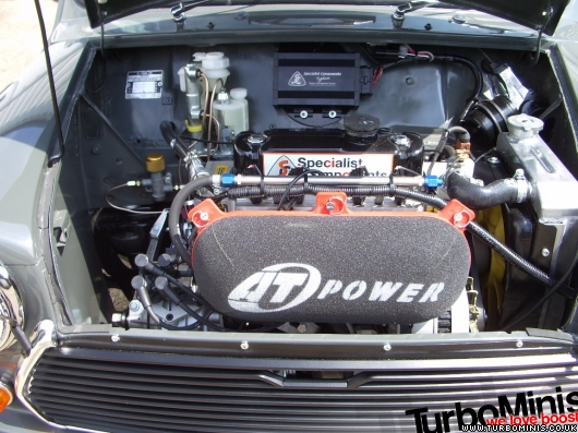

Interesting heater takeoff.

yep - i have one on mine now, they are quality bits of bling

Matt the "dash" is the absolute mutts - can't say how nice it is! - pop in for a looky.
yeah heater take off is DSN's, I am swapping it for a normal valve as being a girl I want the heater for demisting etc, rather than cooking my legs over the summer.lol!

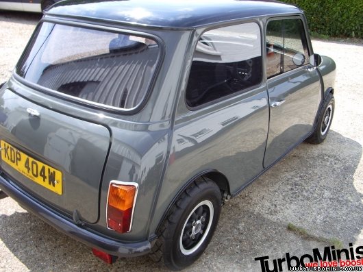

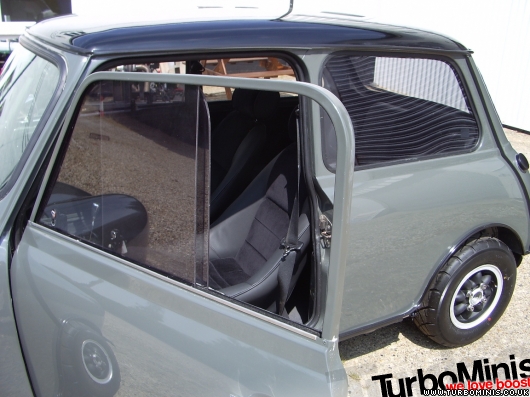

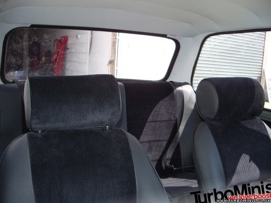

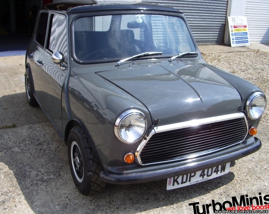

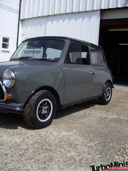

A brief run down on my new car, which has kept my evenings and weekends busy for the past 7 months! Purchased the car from my mate DSN Dave's daughter in Sept as she was off to the US for a couple of years. It was mot'd but in dire need of a resto. So a deal was done and the car stripped to a bare shell. Most of the grot was cut of it before it went to the blasters for a blast/soda mix to strip her right back.
Then the work began - new panels:-
Heritage scuttle
Heritage full rear panel
Wings
A panels
inner wing
door bottoms
alloy door skins
1/2 boot floor
rear valance
rear 3/4 repairs
F/G boot/bonnet
Dave had already put full floors/sills into it previously - probably the only reason I bought the car!
The whole car was then styled around the rosepetal wheels - the colour choice was only made at Bingley this year after seeing a sportspack and old wolsey in the colour - yukon grey. So this is the first full paint job I've undertaken - in celly so nice and workable and she took 9/10 coats in all - plenty to rub off .lol! In went grey Newton headling and carpets. Grey tint perspex windows inc MK1 conversion for the MK3 doors. Cobra classic RS seats - replicas of early Porsche 911 RS seats - very different to other Cobra seats, rears trimmed by Cobra also. Momo Prototipo wheel and a fab Motogadget single instrument (thanks Marcos Matt for putting me onto them!) this is an awesome bit of kit and the first in the uk on a Mini. The suspension is conventional subframes/do-nuts with Protech shocks. 7.5 inch discs etc.Then it has the SC 7 port motor sitting on top of a clubman s/c gearset/ 4 pin diff etc,etc. Engine bay has been wired so that only the Typhoon ecu wiring is in there - all the rest is hidden. Shes reasonably light for a full fat mini at 614kg "wet" so not too bad. Just need to enjoy it now after spending every night from 5.30 and weekend in the workshop building her - any longer and Mrs K would have throttled me.

That does look cool John, nice work. Were you not tempted by chrome round the wheel arches?
