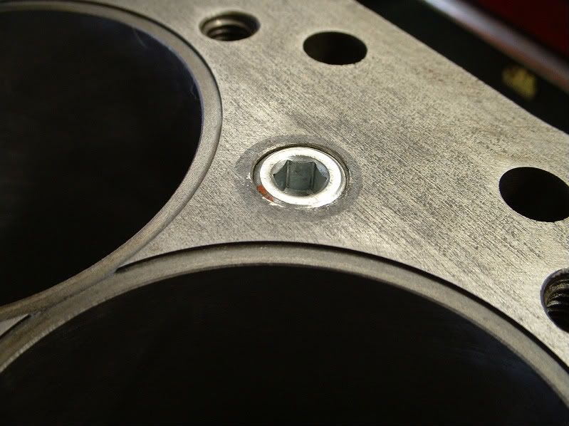

4641 Posts
Yes I've had exactly the same problem in the past. Pots one two & three were unmarked, no4 was like yours. My answer was to block the waterways in the head & run a dry deck type system. The water temp is far more consistent now as well.

phil, do you run true dry deck or do you only block the water ways in the block, and where on earth did you get that big grub screw?, M14 i think mine ended up in the block i had to make my own *happy*

I use 1/4" bsp or NPT plugs like the one Phil shows. no real need to drill the hole bigger, just run the tap down the hole

yes.
http://www.airlink-compressors.co.uk/Fitti...UG%20M%20METRIC
