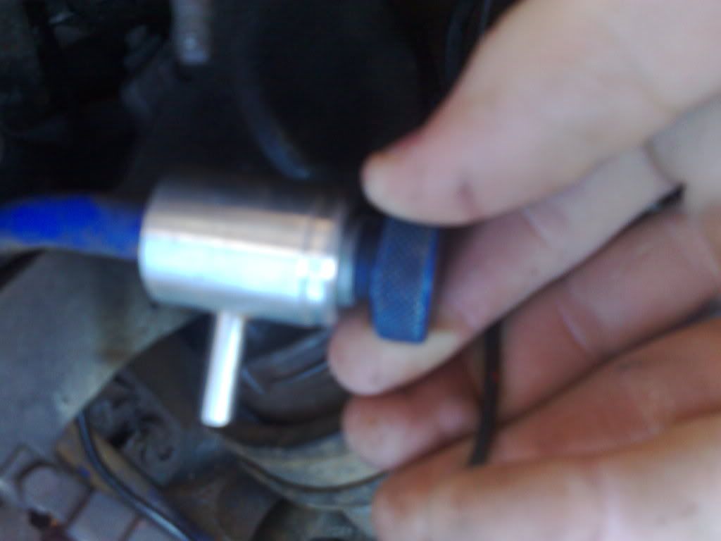

Possibly solved this, i just shut the bleed valve off completely and took it for a quick drive and i didnt experience the spikes once...
So i guess this leads to the bleed valve being faulty and somehow bleeding off more in very quick spikes then returns to normal.
But i guess the problem could be that its not building up enough boost to be able to see the problem, as i have to rev to about 4000rpm im getting about 1psi-2psi boost pressure...
Ill get a picture of the bleed valve im using and see if anyone has had similar problems.
mini=love
17 Posts
Member #: 8899
Kent
Heres the bleed valve im using.
modifiedminis

what turbo are you running? when i was running my T34 at 22 psi on mine the turbo was wanting to boost high but was running at about 1/4 throttle around 3500 rpm, this caused the turbo to surge which would give a drop in boost then a spike in boost.
mini=love
17 Posts
Member #: 8899
Kent
Im just running the standard T3.
Well there goes the idea of it being fixed, its definitely not spiking anywhere near as often with the bleed valve fully shut, but it is still getting the boost spikes, i guess because it was producing more boost before it was spiking worse...
I checked the actuator arm iv never set one up before so im not 100% sure what its supposed to be like, but it didnt slop about, there was no movement towards the actuator and would pull towards away like its one a spring and if i let would would return to its original possition, i pressure this is how its supposed to be.
Also i noticed today that if going up a hill the engine would loosed power, but you could have the turbo spooling up as it does this...
