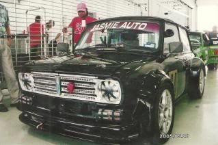

This is currently the fastest Vtec engined Mini in Malaysia..heheh..As the car will be racing again this year,so the a story of it will be written here...
We start here...
Here it goes...
the engine spec:
2.0 VTec engine
B20B block+b16A head
85mm hi-comp piston
fully worked head
4.4 final drive
suspension&brakes:
front:k-series subframe modified to fit vtec,koni racing absorber,anti roll bar,honda integra disc&calliper
rear:toyota starlet rear axle,custom to fit mini,starlet disc brake

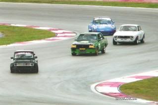

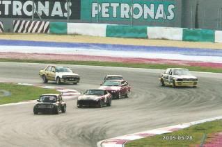

the car is racing in Hong KOng Classic Car race series in Malaysia which is joined with other classic car such as porsche,datsun etc.
it already won the overall champion during the first season race(2005) and then the car is being put to sleep as the competition between cars is getting weaker so there is no point of joining the race for 2006 race season.
now as we are seeing the competition is getting tough,we've decided to bring the car back to action..

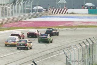

during the first season racing..year 2005..
the driver~
in front?hell yeaahhhh~~! :twisted:

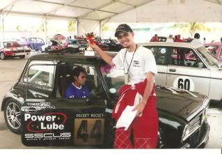

POWER LUBE! *happy*

hehe..it's actually the engine oil company that sponsor us that time...
On 7th Jun, 2010 maccamcvey said:
POWER LUBE! *happy*
