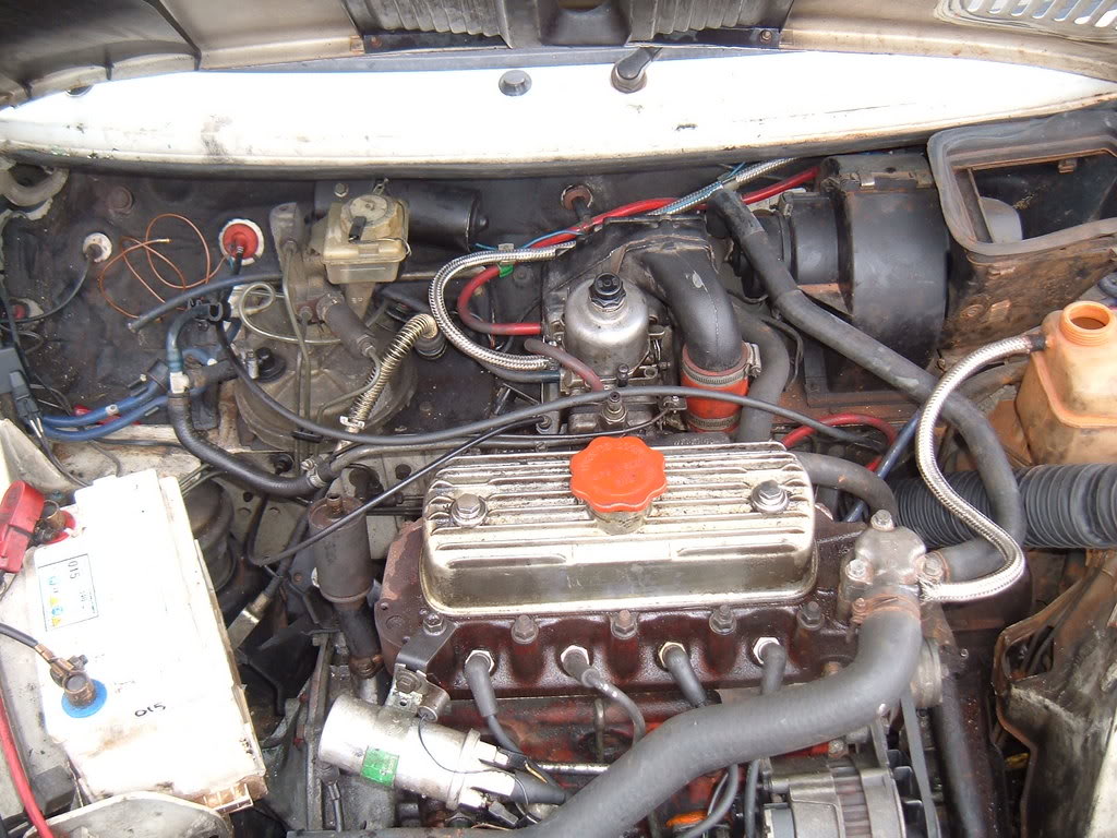

only pic i have On 2nd Oct, 2009 Vegard said:

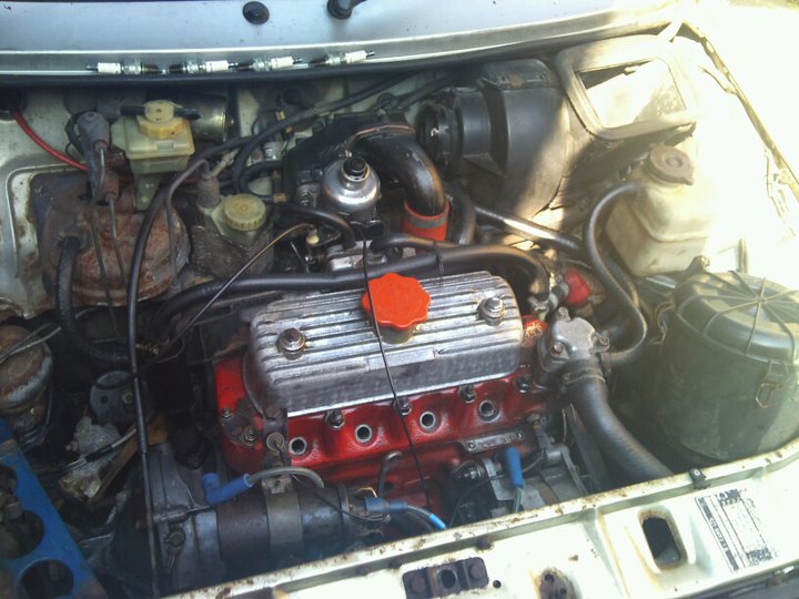

I'm just on my way out to put my cooling system together, I'll grab some pics,

i dont know if these help at all rod ,mk 1 metro thick rad ,and the bottom hose has 2 take offs, one heater, one header tank , i dont know what that hose is off i built it in 1998 so my memory has failed pathetically.
