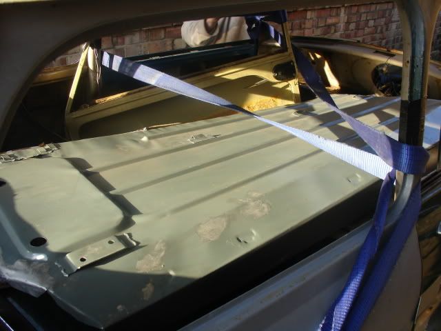

I own a Mk2 which has undergone a full body resto, I reckon nearly every panel in the bloody book has been replaced or looked at. Its been away for quite a while now but it should be painted soon and back to me in a few weeks which will be a real joy. Bodywork has been done at SD Minis which is where I got my Megajolt kit from as well.

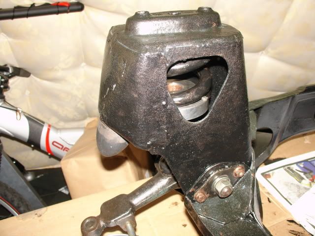

How I got it,
All stripped locked and loaded to go away for body massage

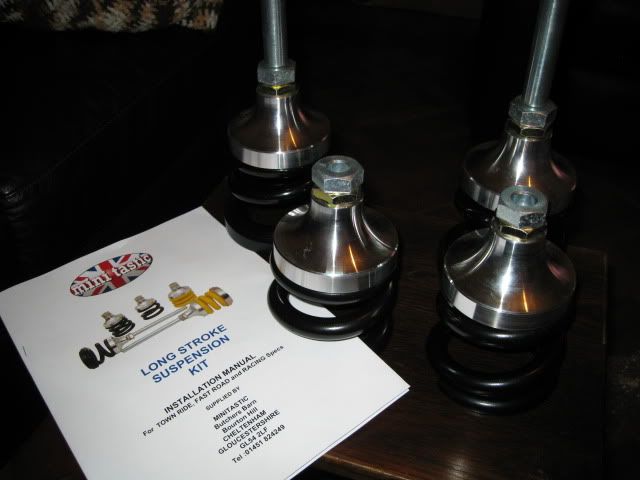

Gone for the Fast road Minitastic setup

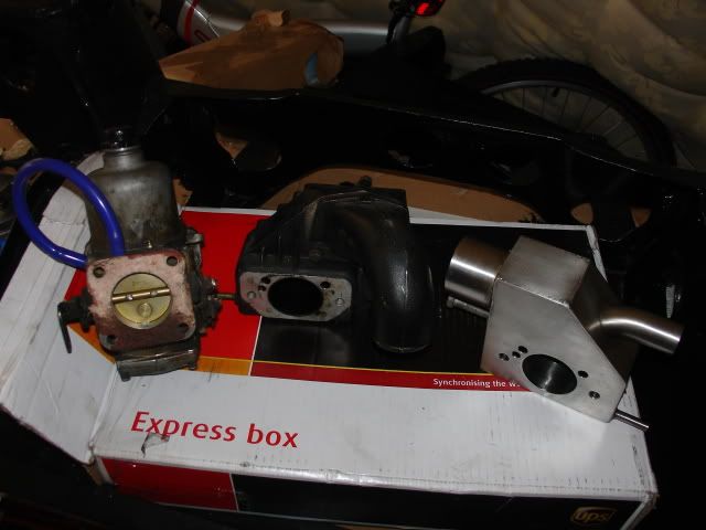

I've had to make a few changes for the Turbo, head opened up, straight cut drops, Spi tank, turbo carb etc Thanks to Richard (Turbominivanman) and RobH for the Carb and Plenum. Much appreciated for the quick and friendly service.

Slightly O/T but does anyone have any first hand experience of that minitastic kit?
I've been comtemplating buying them for my build but only heard people questioning the spring rates etc

Ollie, I've heard great things about the Minitastic kit which is the reason I bought it. I know someone who had a test drive of the Minitastic mini and bought the kit straight away.

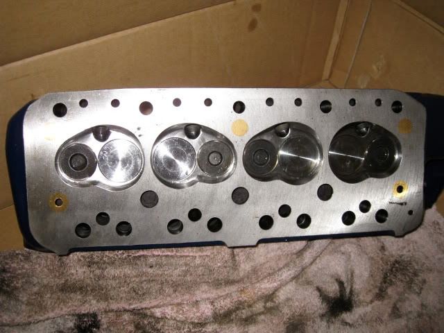

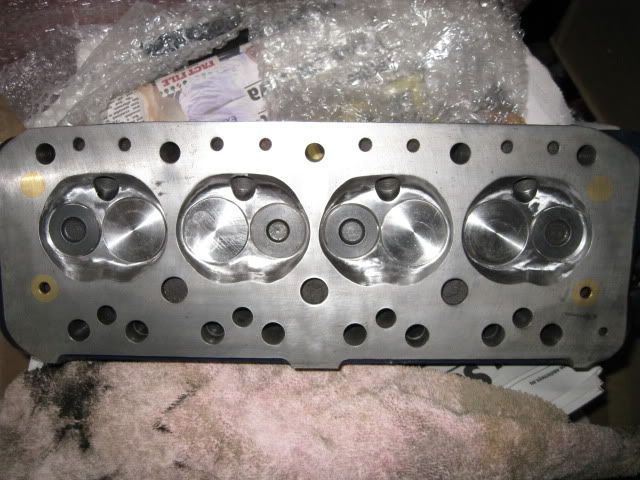

I sent the head off to Benross to be opened up to 28cc for turbo use. Nice quick and friendly service
Before
After
Also Richard (Turbominivanman) recommended I buy a rebuild kit for the carb and give it a once over. I was free today but only got as far as taking the float cover off before family called and I had to pack it all up and leave *oh well*
The cover took a bit of tapping with the rubber mallet before it came off, then I understood why!!
Check out the Gunky/crappy/jellified petrol
*surprised*
WOW!!

Oh, that carb is shocking, the petrol looks as though is gone to Jello.
Bloody good job you're rebuilding it ! *smiley*
