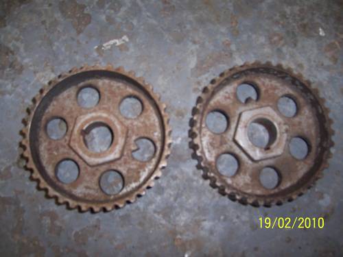

However, there are a pair of Cosworth YB STD DOHC pulleys for sale on a 'Buy it Now' price on Fleebay for £20 and if suitable would fit the bill perfectly. Here's the link :
http://cgi.ebay.co.uk/Ford-Cosworth-YB-STD...=item20b12e5272.
Can anyone advise which car, engine, CC etc I could use the pulleys from or indeed if the above Cossie pulleys would be suitable.

I need to know what Ford pulleys can be used.
The ones in my pic above are Cosworth YB STD pulleys.
Cheers.

Square or round tooth profile?
Not sure if that was directed at me or not Sprocket, but the Cossie pulleys I have sitting next to me are square at the top, round at the bottom.
How relevant that is to the BMW conversion, I haven't a clue *happy*
But if Richard wants measurements off a Cossie pully, as he suggested earlier, I can do it :)
Sorry Rod, It was not directed at you, it was meant to be in general:)
Specialist components sold/ sell kits with square tooth profile, as well as round. One will not work with the other :)
Edited by Sprocket on 15th Jun, 2010.
No problem :)
I wasn't aware of them offering both square and round profiles but then I'm not following the BMW route. *happy*
Even the "round" profile seems to have two different industry standards, at least within Ford, as I found to my cost, 16 bent valves..... *frown*

(a) OD, 113.5
(b) shaft size 24.0
( c) keyway width 5.0
(d) keyway depth ~2.2 (very difficult to measure accurately on the pulley)
(e) boss depth/thickness 22.3
(f) it doesn't, it protrudes from the front by ~3.5
The only thing you didn't ask for is pulley/belt width 27.0
Hope that helps, I can't imagine the Cossie ones are right or why are most people using Honda ??? The Cossies are much more readily available.
But you're welcome to my old standard ones if the measurements do make sense.....
EDIT - last point, it's pulley width 27.0, belt is 25.4 (ie old 1").

Right Rod.
The two pulleys in my SC kit are square tooth top profile and square tooth trough profile.
The 'Gates' belt supplied by SC has a square profile tooth pattern to match the jackshaft and crank pulley wheels.
Rod, I've also checked the dimensions you supplied (VMT) and these look perfectly ok with the kit I've got.
If you wouldn't mind checking your old 38 tooth Cossie pulleys, if they are square tooth profile I'd like them please Rod if they're still available.
I'll send you a PM. Happy to send some dosh for them, plus postage.

Richard,
You have me a bit confused, the Cossie ones are as in my photo, round at the buttom of the pulley and square at the top.
ie, the belt is square but with rounded teeth.
Are you sure this is what you want from your description of square/square ???

On 18th Jun, 2010 Rod S said:
Richard,
Yeah, sorry Rod, just realised my mistake, thanks.
The Cossie pulleys ones will not work as the trough profile is rounded and requires a rounded tooth belt.
I think I'm with Sprocket on this, the pulleys I need have the square teeth and use a belt with square teeth.
As the Pinto 1.6, 1.8 & 2.0 engines are very commonplace, I'll source a pair of pulleys from my local scrappy rather than buy Kent or Piper new ones.
Cheers.
