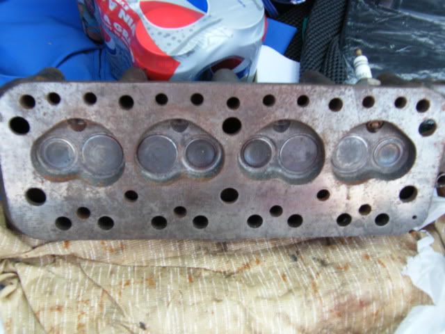

so why is the compression lower? how?
the chamber is bigger, and a better shape,
998 head...
295 head...
But the valve sizes aren't the important factor. Tha shape of the ports are. These are FAR superior.

that all makes perfect sense, cheers TM :)
