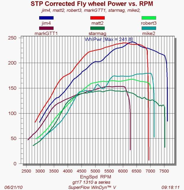

these are from the tm shootout day ,,,
hope that helps :)
would be interesting to see what final drive was used against the losses. I know Matt uses a 2.9:1 which might account for the huge loss. Jims too. Does this show that the theory that straight cut boxes give less losses due to less suggested side loadings,is infact bollox? or is this as a result that with more torque, you expect to have larger mechanical losses at the upper end?
I tend to use an assumption that a Transverse a series gearbox has losses aproximated to 24hp, some may be less some may be more, but if you don't know, its a good figure to start with.

no probs rr , when i tested my car with a helical box , i got 24 bhp losses ,so about 7bhp more than straight cut ,but remember ,that was on a different rolling road ..but also one that used the coast down method as well.
