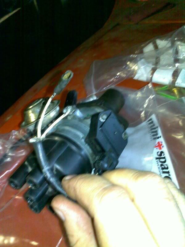

In South Africa we didn't get the A+ motor with all its fancy bits.
But i've managed to get an A+ dizzy with the turbo stuff that i bought.
Only problem is, how do i wire it up ?
Got two wires, one with a female spade and the other a male one, which one goes where ?
Ta
Sean

Both to the coil - you need the correct "electronic" coil, it will have the corresponding (opposite) male and female to make sure you can't get it the wrong way around and the coil itself just gets 12V on the side marked "+".
Make sure it is getting 12V (white wire) and not a ballast feed (pink/white) as the electronic module needs 12V not the ballast wire 8-9V.
We got away with using the ballast wire on the van for about 5-6k. I know this is wrong but we didn't realise this was the case until we pulled the engine.
definitely use an electronic type coil, a normal one kills the electronic unit :(
