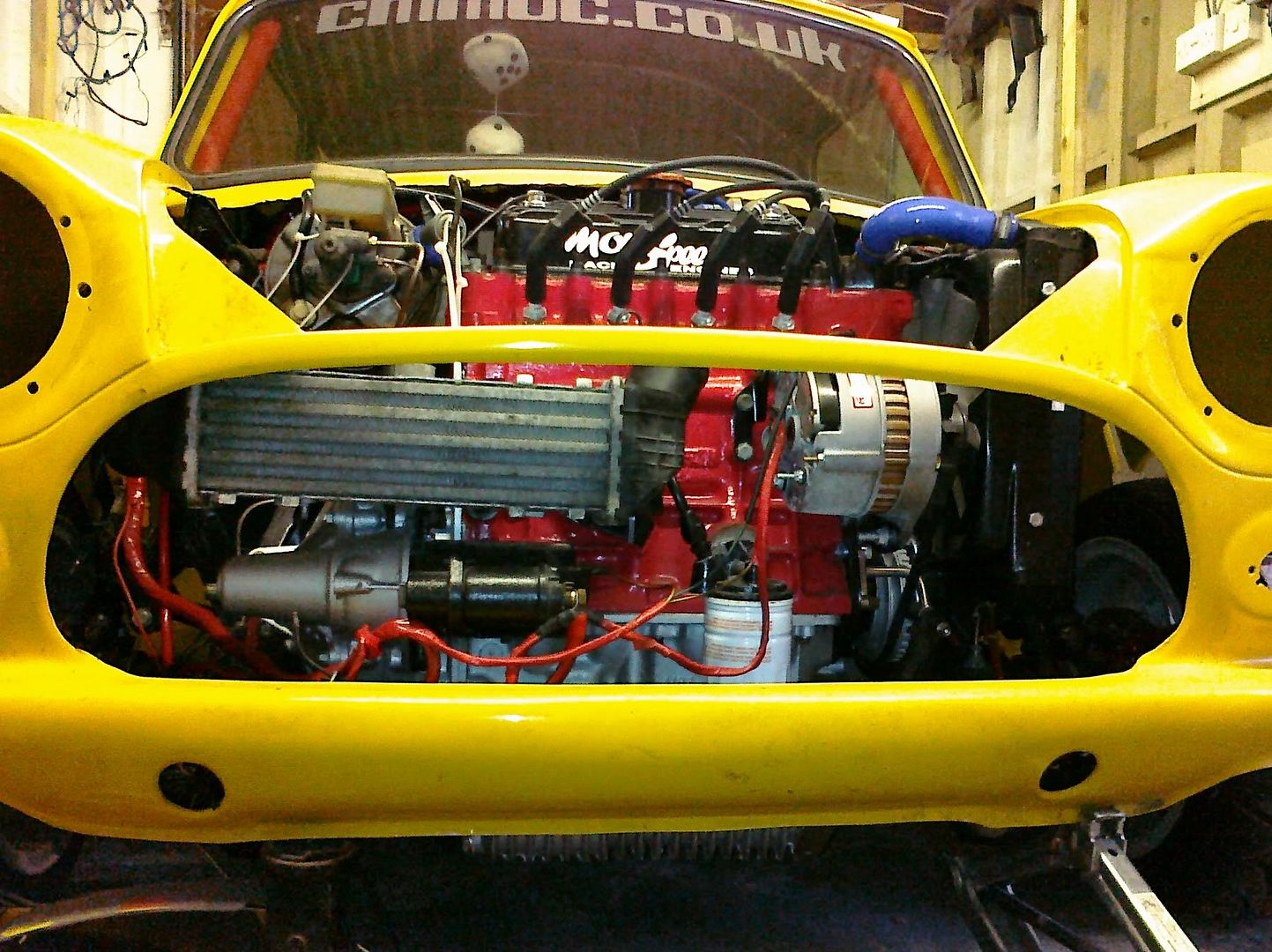

So heres the situation with my intercooler...I now have 3!
from a 200sx, Skyline and Ibiza.
They are actually all the same capacity, ish, they are all 2.2 Litres but if you wanted to be more specific they are 2.27, 2.24 and 2.21 respectivly, which is only 60ml differance from largest to smallest. Worked out using LxHxW.
At the mo it looks like the Ibiza is the winner as it will sit in the gap above the starter motor, but should I try and make one of the others fit as coolers are more efficient with a larger front surface area and with more cooling tubes.

Tip:- Get a mini pre-engaged starter as the solenoid it at a 45 degree angle instead of 90deg and gives you a touch more room up front *smiley*
But I like the Ibiza cooler for the reasons you mentioned.
As you realise yourself, the physical size of the core isn't the end of the story...
It's the surface area of the tubes and the surface area of the fins that really matters - the one I'm attempting to use has even got fins inside the tubes.
To compare them you need to try to work out the surface area of the tubes as a minimum, not just LxHxW.

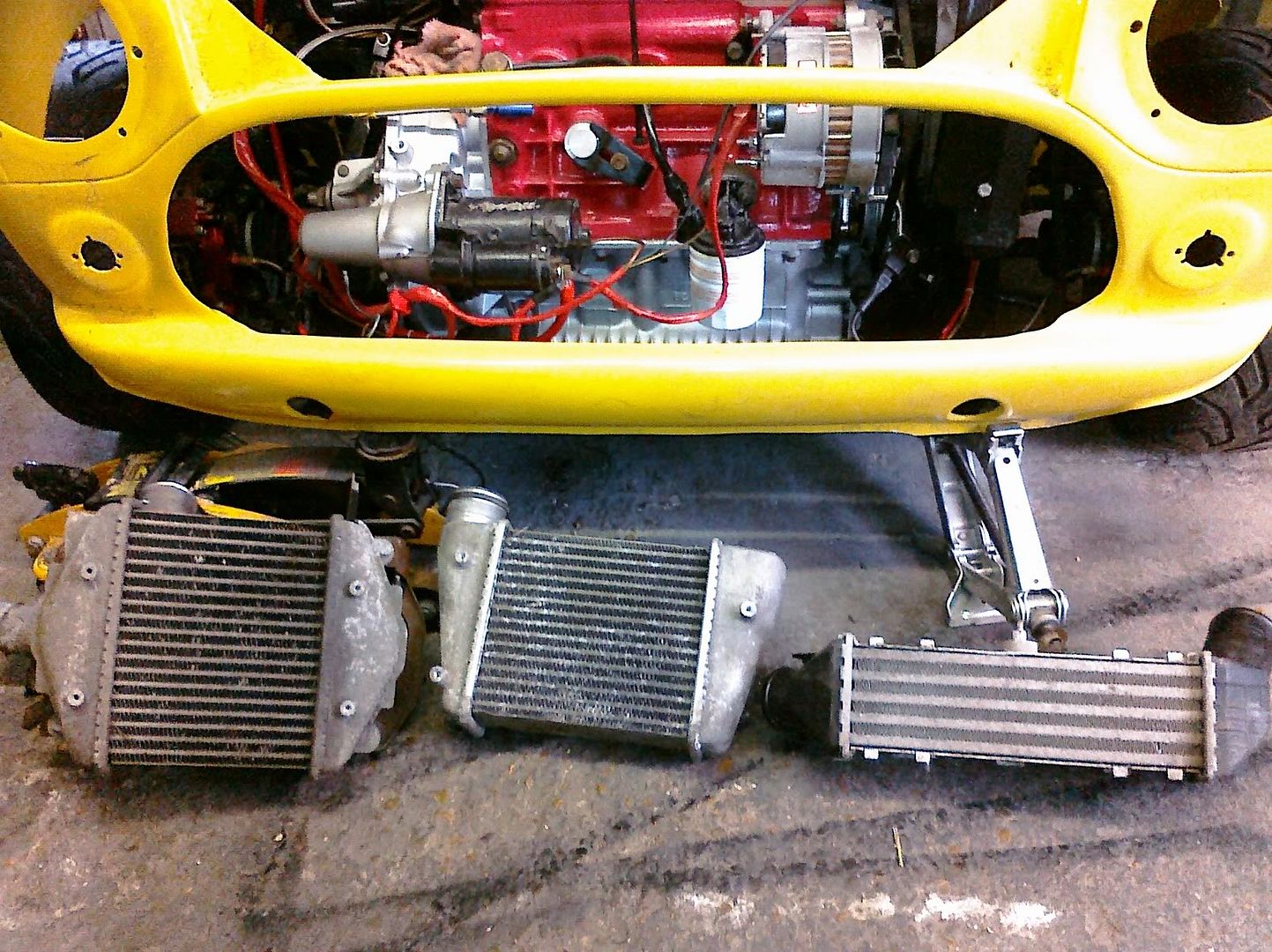

If it doesnt ahve fins inside the tubes...it would be pretty crap.
Based on external appearances, I'd be using one of the left pair.
The rightmost one looks very small and crap.

the 2 on the left are only 60mm thick, the one on right is 85mm, so it makes up for front area with depth.
further investigation shows all 3 have fins inside the tubes.
i still work it out that physical air capacity is the same in all 3 so air will spend the same time in each.
the ibiza one is rated to over 200bhp so should be fine, even if the others do work out to be more efficient surly if its rated over what i need and actually fits then thats fine?

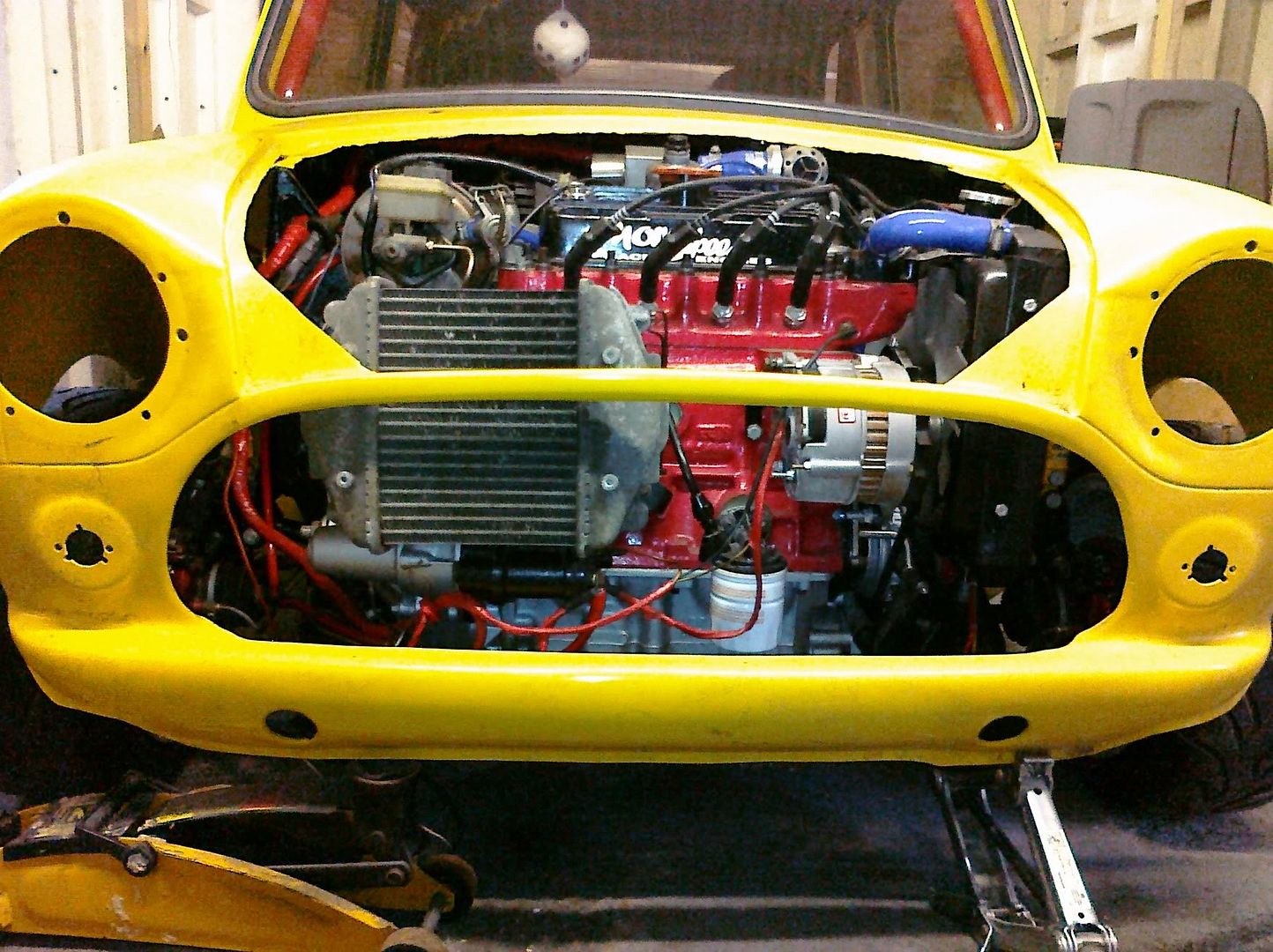

i dont want to have a cooler hanging out the front, while the car isnt exactly subtle a bit of a sleeper look on the fact its got a turbo would be nice.
this is the option with the 200sx cooler, would put a vent hole or two in the bonnet too.
http://turbominis.co.uk/forums/index.php?p=vt&tid=170151

Looks like it would provdie good flow, especially with a hole in the bonnet, maybe louvered sort of to force air down into the motor? Or am I talking out my ass?
I reckon if you used a pre engaged starter with the matty trick and a ND alternator you could fit all 3 up front.
