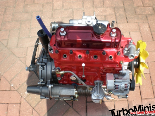

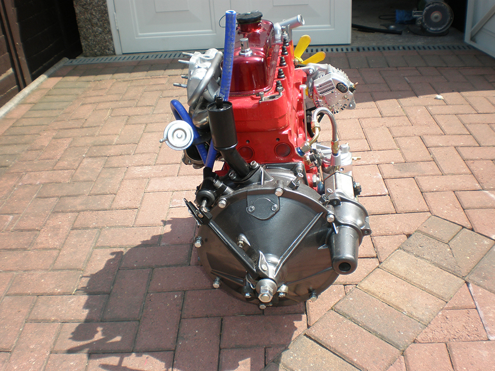

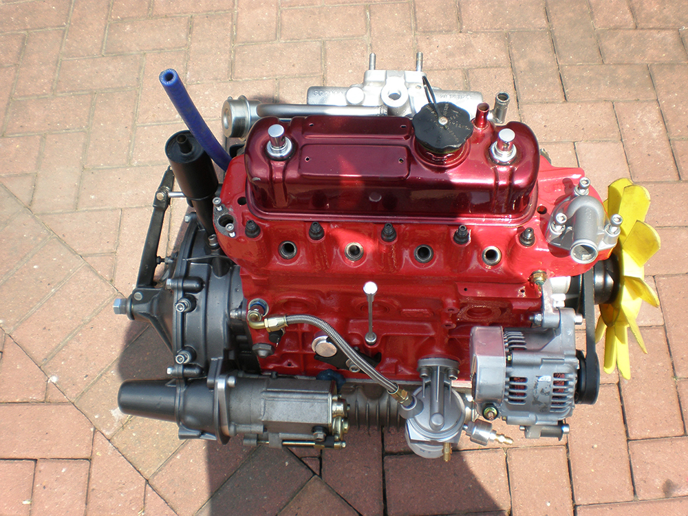

just started to fit my new engine built by benross

whats the spec?

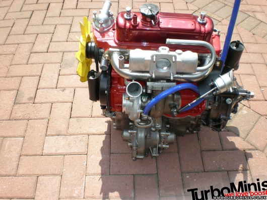

1380 forged pistons
benross head
arp con & head bolts
ph2 cam
1.1 drop gears
straight cut gearbox
quaife diff
lightened flywheel
double grey clutch plate
megajolt
hiff44 carb
nic plenum
cossie intercooler
Edited by strech on 30th Jun, 2010.
strech
110 Posts
Member #: 2214
doncaster south yorkshire
lots of powder coating and all stainless bolts & nuts
*tongue*

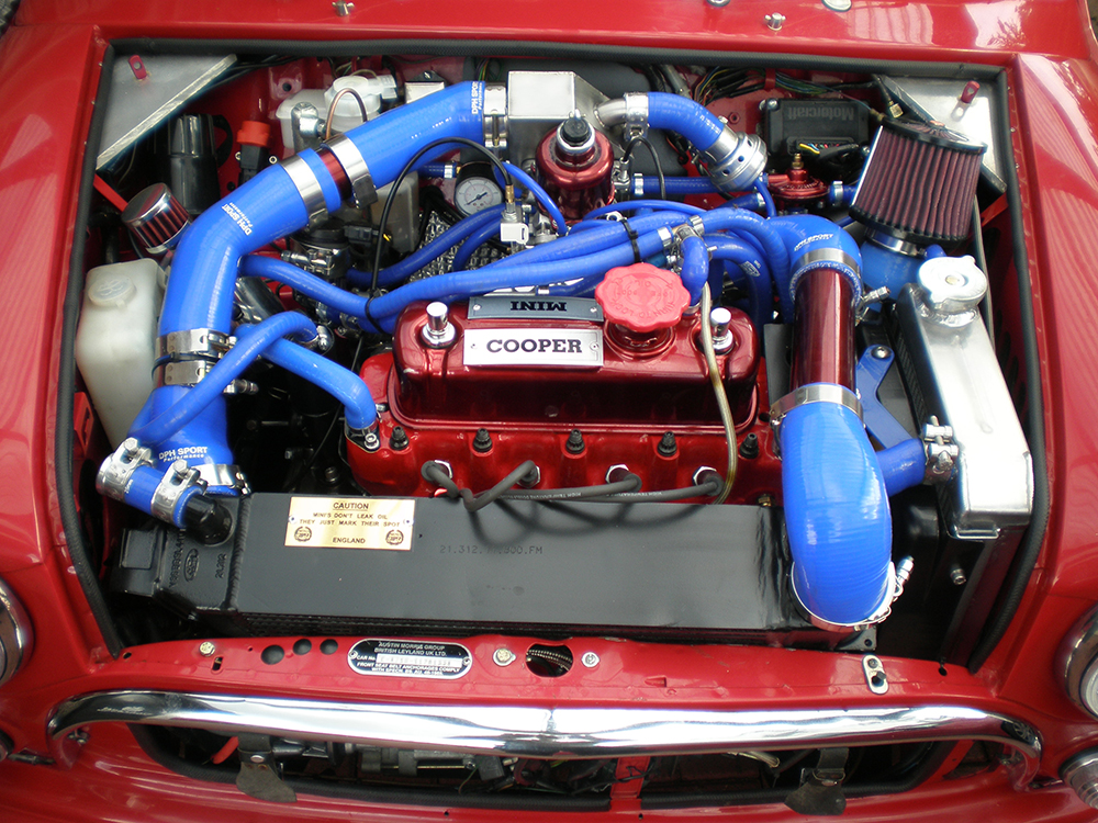

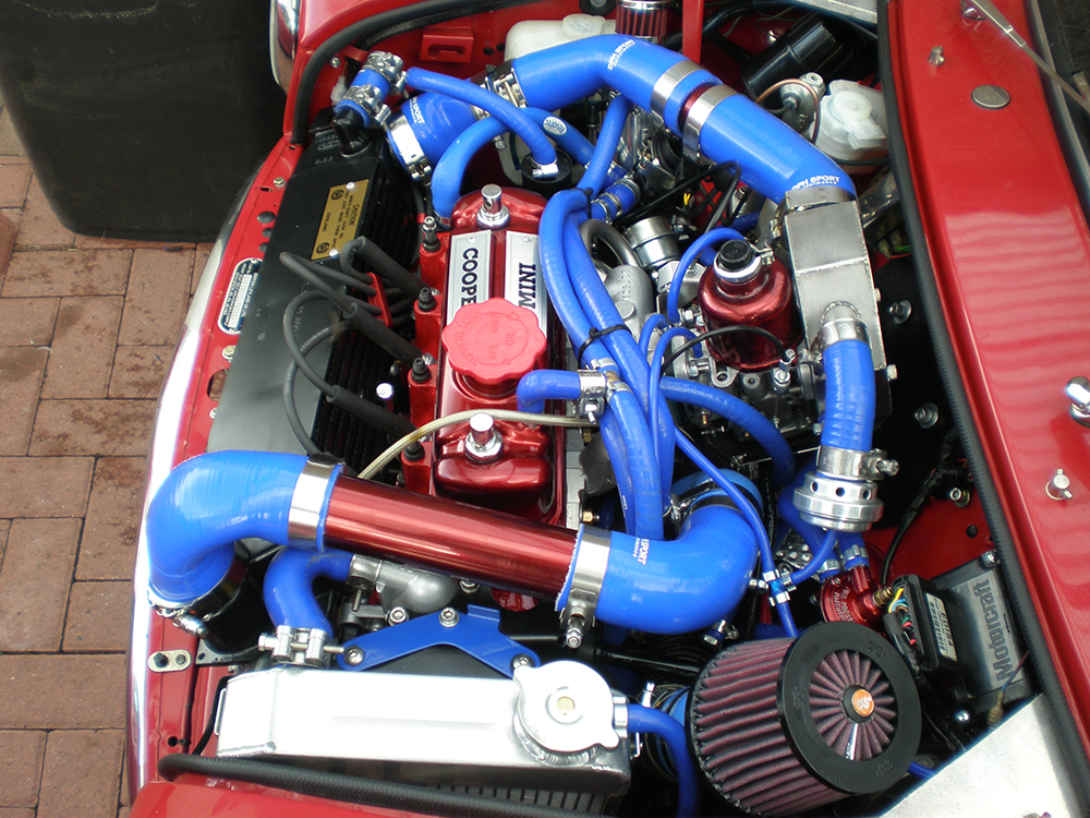

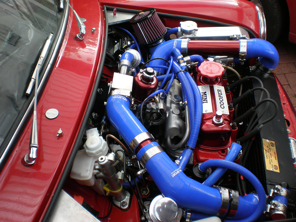

engine finally completed, all i have to do is fit the dash back in and thats it finally finished.

Love it, looks really good. Like the colour coded pipework looks smart!
Where did you get the GT17 manifold from please? Its exactly what I'm looking for!

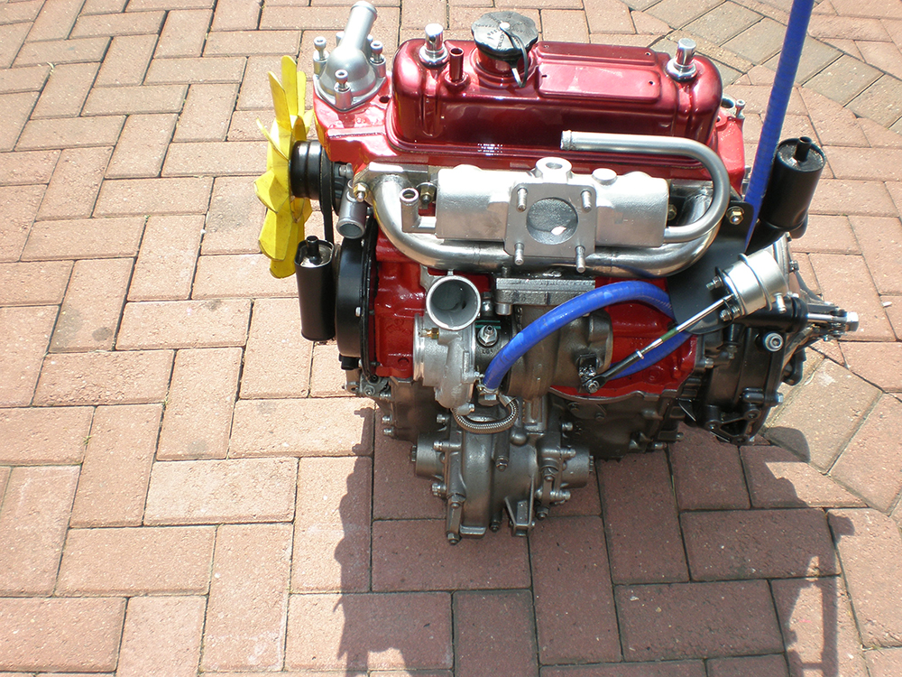

i intend to take it to mbe in lincoln for the rolling road, they can use megajolt and its only40 miles away, matty made the manifold, i had to extend the stabilizer on the top right by 20mm and buy a adjustable stabilizer for the left, this has tilted the engine by 20mm, i thought i might of had problems with the gearbox linkage, but it fitted without any problems.
4310 Posts
That looks fooking tidy, nice work.
Looks great.
Looks like a couple of the hoses are kinked, probably worth trying to sort that as it may cause you problems.
