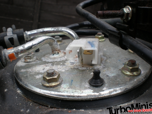

help needed , i have tried the various links to try to get a picture of the tank, turbodave posted one in 2004 , the link is dead, there was a picture available about 3 months ago, i cannot find it now.

cmon guys, i know that some of you have this type of tank, i have posted the pictures if it will help

you cant go wrong paul, ones earth into! the pump and ones the live
try using a multi meter and bell the earth out
i would fuse this say 10 amps ... i may be wrong though ?

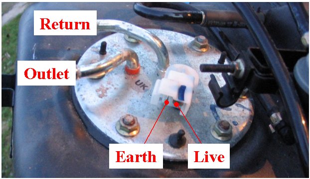

Here you go

cheers guys, i can go ahead and fit the tank now
