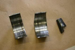

was planning to take it out later on in the year a freshen it up as its done a few trackdays now ans was gettin a bit tired and smokey, plans changed when all of a sudden it made a really nasty knocking sound, initial suspisions were big ends.

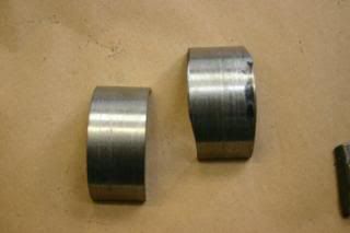

last week engine was hoisted out and stripped to find this

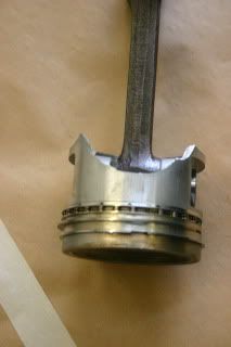

the missing piece was found lurking in the diff housing and luckily has stayed as one, further inspection revealed this
conrod is fucked, crank is currently std size so is going off to the machine shop next week for a re grind. i didnt get chance to take any pics of the bore but that is fairly untouched, will need a slight hone to get perfect again. however that is goin off to be cleaned checked over as a matter of course.
the chunck of metal next to the bearings is the tip of the mechanical fuel pump which we think snapped off and caused damge to the piston.

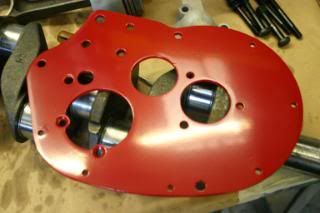

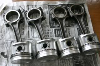

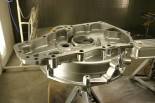

been a while since my last update, decided not to get the crank reground as it was cheaper to find another std. it was also decided to get some new pistons, i could get a single one however for some silly reason the engine had 11cc pistons in so this time we went for 7cc and were fitted to balanced rods to get the compression a bit more sensible

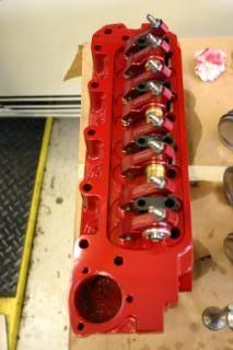

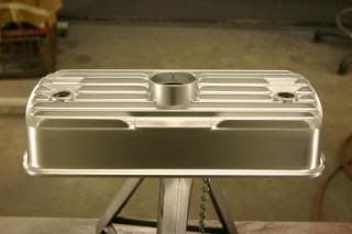

have spent ages with paint stripper an wire brishes getting everything cleaned up ready for paint whilst the block was off getting cleaned up a new cam bearings fitted. the head was also stripped, cleaned and re lapped the valves in

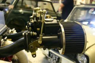

also had the carb apart masked up and painted

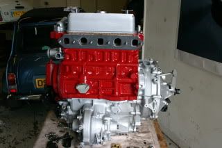

got all the bits back last week, so started to put it all back together today, all thats left to do is torque head down and do valve clearances, fit flywheel housing and flywheel/clutch assembly which i am waiting on a oil seal for

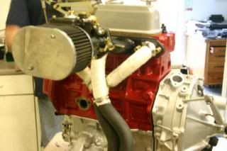

as i left it today mocked up with exhaust and carb
Edited by nick1275 on 21st Aug, 2010.

i will be the first to say its very tidy but have you literally dunked the head in paint ebay style?
nick1275
250 Posts
Member #: 1615
Ferndown, Dorset
no, got some engine paint in a tin thinned it down a sprayed it on, all been done in a mates spay booth. the silver is a similar paint and has also been sprayed and a coat of laquer. we did the carb in the same way with satin black hammerite, that had loads of coats due to it being thinned down like piss to go through the gun. obviosly everything was masked up inclding the carb which wasnt easy

What camshaft was in?
Nice and shiney by the way ...
Rusty by nature
nick1275
250 Posts
Member #: 1615
Ferndown, Dorset
286 cam is in it, this time round ive added 1.5 roller rockers and a med ultralight flywheel and backplate. will get megajolt on it before long too

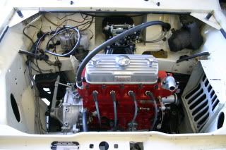

nick1275
250 Posts
Member #: 1615
Ferndown, Dorset

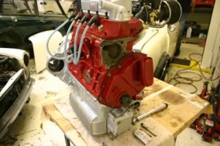

Been a while since i updated this now, engine is all in and running and has been in for a couple of months now with about 300 miles on it. first impressions are very good drives so much better than the previous build, feels like it's pulling better with the roller rockers and slight compression increase. just taking some getting used to the lightened flywheel, but the throttle response is way better than before
a couple of shots prior to instalation
engine in
theres still some work to do tidying up the bay, going to re route the heater hose better and neater, make a bracket for the fuel reg.currently looking into megajolt and id like to get that on ready for a rr session once ive properly run it in
