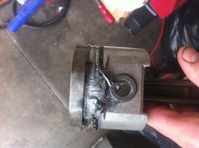

Before anyone says it was running lean! It fookin wasnt, ive checked! I think my timing was out and i some kind of problem with my cooling, people in the know who were there at the time all put it down to massive heat prior to the turbo coming in and as soon boost pumped hot air into the already hot engine basically melted it! directly under the inlet valve.
Opinions are welcome but im happy with the diag that was made on the sat.

Melty melty. You'll have to dial out the offset with the megajolt. Told you that bracket was out *smiley*
Yeah its all your fault john! So im putting blame and costs down on you!! Im gunna modify it so its on 90 deg, i did dial out the mj but it only goes -+5 so i recon it was way out to start with.

I notice the top ring land is actualy broken, perhaps that was what went first, then as the second ring lang, which is thinner, gets loaded up also broke, then the blow by just melted it.
I would go along with the high engine temperature, which might have caused det to break the top ring land
What pistons are (were) they?
Hows the bore?
yes as sprocket and john says mike, high ambient temps plus too much advance on the timing leading to det caused this mike, ....are those pistons made out of dairy milk ?
How about just that piston was running lean through some bizzar siamese port robbing.
How are the other three?

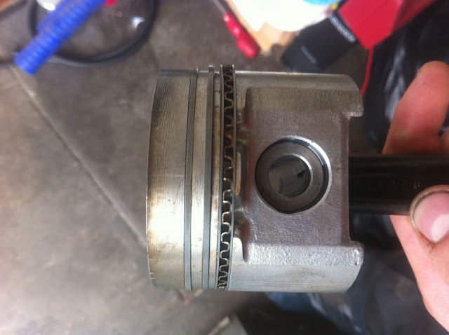

Others are fine no signs of any issues, the melted piston is no 4 too. Which also points to the heat as well. When i limped it back to camp i noticed the temp gauge said 120!! :-0 ive always had problems with cooling, ive changed everything barring my water pump so thats getting swapped and its getting dry decked also. Its getting setup on rr before mitp so i should be good for then.
Just took the block to my local machine shop, he says its touch and go, hes gunna attempt it and see if a hone cabt sort the job out, if not ill be on the look out for a block!
Front mount rad Mike? I had endless problems keeping the coolant temps down when the car was not moving. I put my issues down to the rad though as it was a 21mm core 28 row double pass. I just didn't think the core size was suitable for double pass.
Is the block likely to be fubared mike or need a bigger overbore? Cos I'll do you a swap if it will go again with a bigger overbore.
Yeah front mount, double pass.

Repairable ...........................as an ashtray!

Well I'd certainly say that would account for the smoke!
Yeah itll make a good paper weight.

mike are you using the heater take off from the head is in plumbed in ??????????
Wasnt, irrelivant now since ill be dry decking it.
