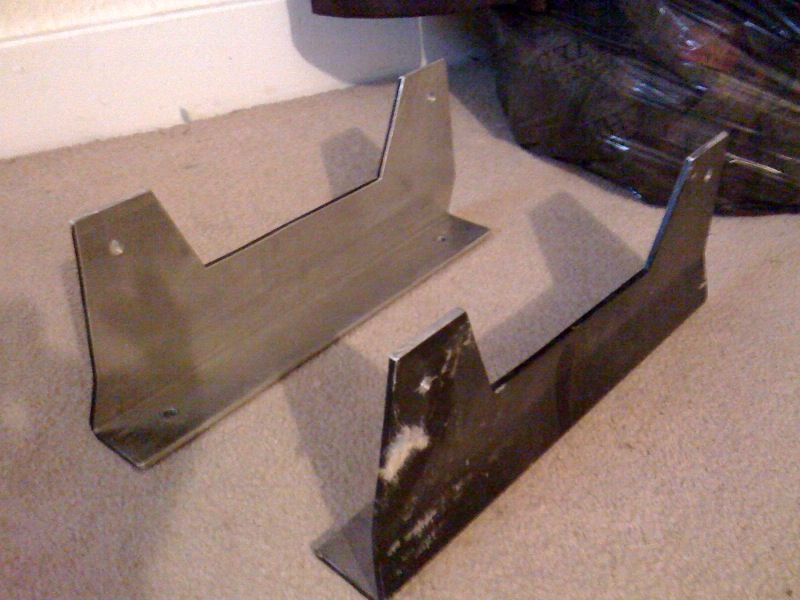

These are mine, cost about 40 quid for the pair, including bending costs.
they are to be subjected to the hole saw treatment still though!
side mounds would be even easier, one less bend without angles as a consideration.
