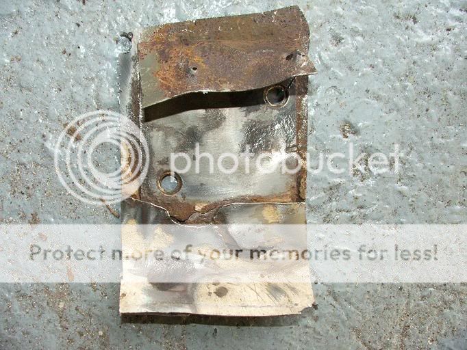

Lads I have to say that I am glad this screen went because I found a much more serious issue.
I had to take the carpets out because of a little rain soak, and not to my surprise the sound deadening on the drivers side was wet. But the base of the sound deadening for the bulkhead was dripping, but only in that area.
On closer inspection I found a 3" tare in the floor pan around the drivers side subframe mount. If the screen had not gone I would not have found this until the winter strip. And seeing as the interior only went in a few weeks ago I can say with absolute certanty it was not there then. And there is no rust in the area its a tare through a clean sheet of material :(

Does the tear look similar to this?
Common problem I believe

I had the exact same thing on the subframe mounting points on both sides of the car. Althought it looked like a crack I assumed it had just rusted away like the majority of my car has. Usually cracks propagate from a weakness such as a hole but on my car it was in the middle under the mounting, which I did not expect to be an area experiencing enough strain to cause a crack. Alternatively is it due to cyclic loading of that area causing the metal to fatigue? I might be talking bollocks but I would be interested to know how I can avoid it cracking again.
