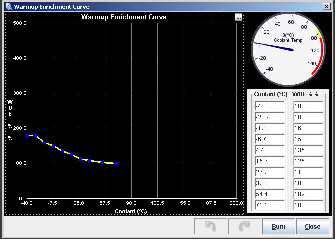

So I obviously have some settings wrong as it's reasonable (not as good as yours Paul yet) once warmed up.... but during warmup it's all over the place rich.
Doesn't help that I can't get the TS gauges to read sensible units any more at the moment......
I've attached my warmup curve.

My warmup curve looks about right but I can't be certain as the units have all been screwed and even the online gauge has a corrupt display.
