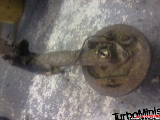

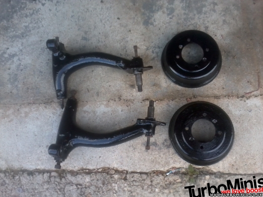

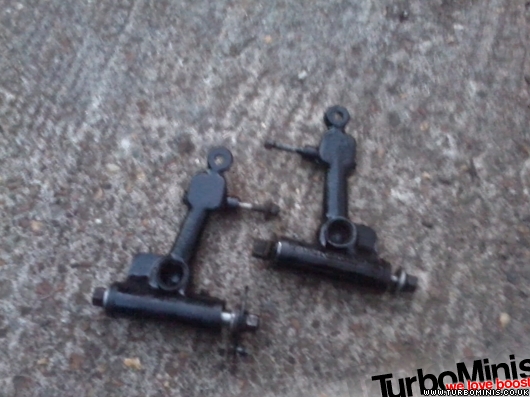

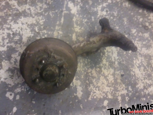

Ive made a bit more progress over the last week...
Manky old radius arms...
Now nice and clean!

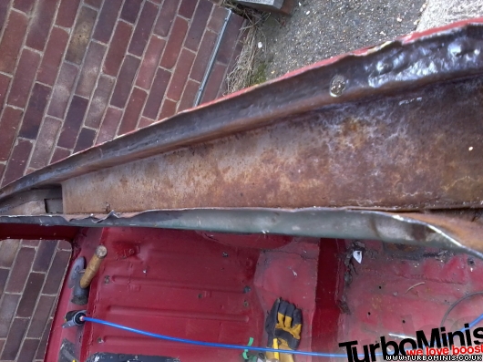

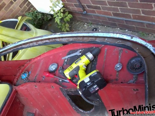

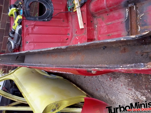

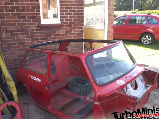

Old roof taken of...took all of 5 mins, as it was only stuck on. *happy*
What was underneath the roof took about 8 hours to grind away...part of the original roof skin! *oh well*
8 hours, lots of blisters and cuts later...
