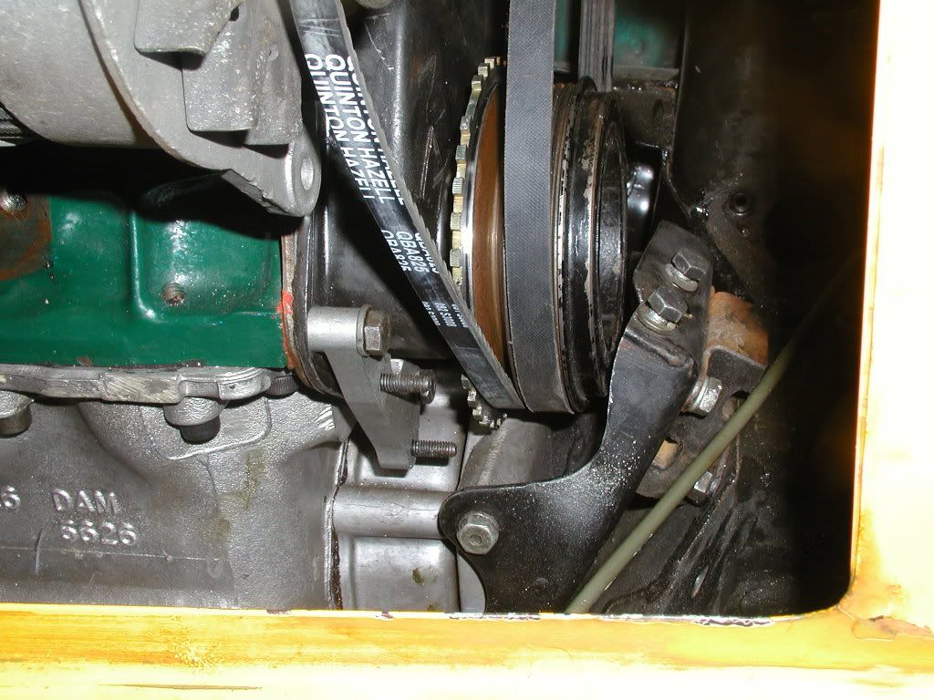

This guy built his own pulley arrangement, with triggerwheel.
It's from a build on TMF:
http://www.theminiforum.co.uk/forums/lofiv...hp/t132580.html
